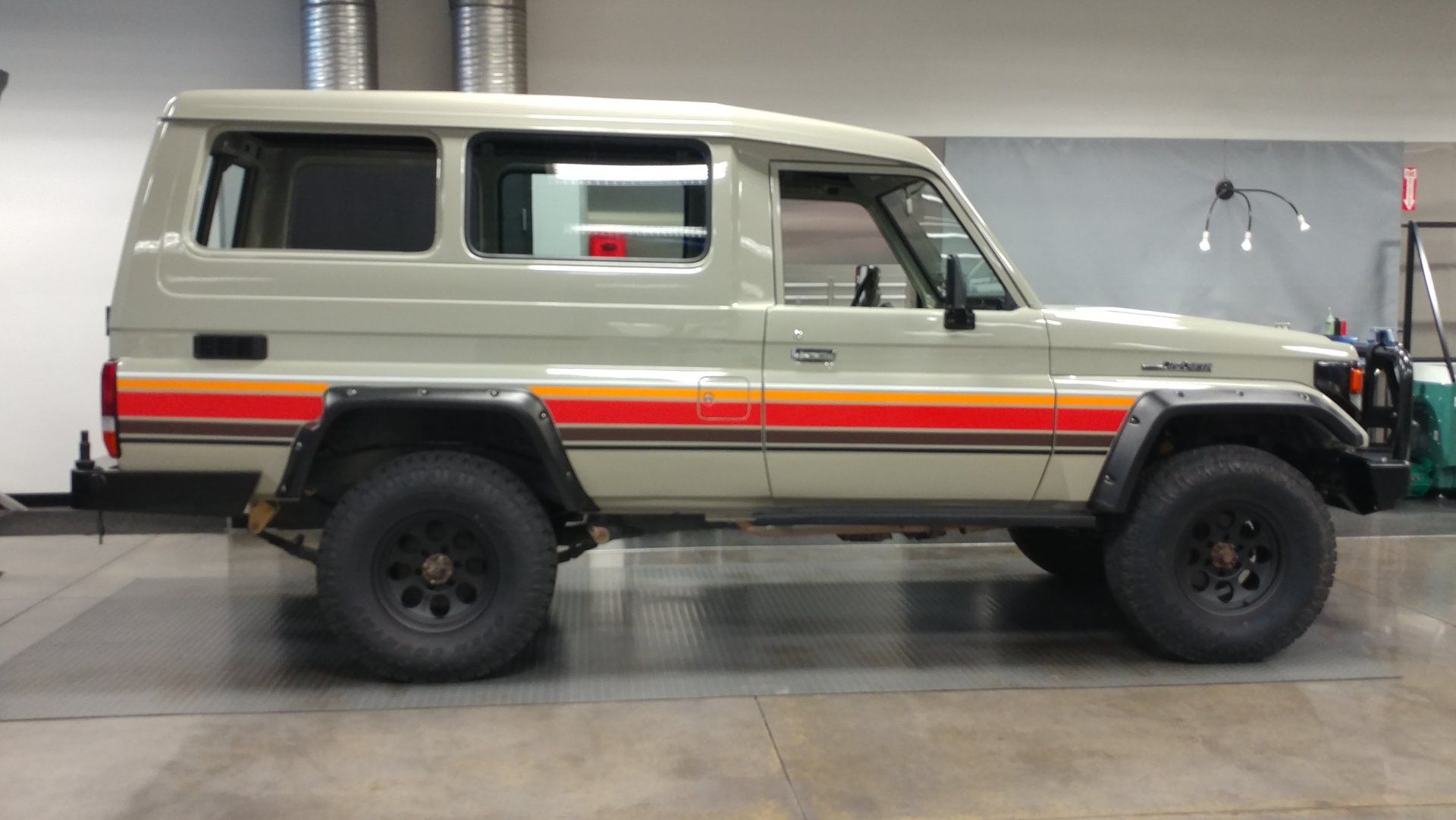

Brought the Dobinsons bumpers out of their storage space and into the shop....ended up with the Dobinsons rear bumper/tire carrier and their old school style front bumper for this truck. I seem to recall them not being 100% sure about the rear fit...
Most of the rear lined up....couple of the lower holes didn't but that isn't a huge deal. We'll have to mod the tail pipe to dump it out before the bumper as there is a side mount/bracket that will interfere with the exhaust. The exhaust keeps the good ol' Middle East way of fixing things so it won't be a big loss.
Really nice piece. The inner white LED are dual lights...amber for turn and white for reverse. Outers are park and brake.
Lots of bits and pieces to make this thing fit.
Did a little aligning to get the 'wing' to match up with the stripes/rocker line. Got it pretty close....If I tip I down any more, the rear vertical surface gets a little weird looking. I think these were for wagons...not really Troopys. Seems like I remember the guys at Dobinsons saying that.
These bumpers run a tire carrier obviously and then a swing out on the left side for jerry cans....I don't think I'll run the jerry can side.....it interferes too much with opening and closing the rear door. Even the tire carrier becomes a bit of a pain...especially if we use this for a shop truck.
Front was easy....unfortunately no pics of the winch going on. I put a 10k Smitybilt on it with a synthetic rope....it's a wireless waterproof unit that I got for cheap. It does need an offset fairlead though to fit this bumper. The 79 has one on it that I may end up using.....so I ordered a Factor55 offset hawse fairlead. Will decide if I want that to go on the 79 or not when it comes in. Nice piece but I like the roller setup on the 79.
I really like the way this bar looks....simple.
Popped these on.....we had Raptor lined them a while back. The front and rear caps are really in bad shape...I'll hit those with Raptor when we spray the rear aluminum diamond plate step on the rear bumper. We did this on an 80 and it looked really cool in black. I'm sure we will build some sliders at some point for this thing.

I absolutely love the look. The colour of the stripes pops so well against the more neutral paint.
I’d look at 79 running boards if you can. I hate the short length of the boards on the Troopy and think the longer ones from the 79 really finish it off.
I’m just having sliders made for mine which are the full length of the sills.
Looks fantastic. I got the same message from Partsouq yesterday. You can still get the rubber end caps for those running boards. I bought a spare set for my 75....just in case.
There will definitely be some withdrawals going on with no Partsouq orders coming in :(
Ah....good idea on the 79 boards. They're long for sure. I think we'll be building our own steps/sliders....we'll have to relocate the exhaust first but that's no big deal. Probably will need a new one anyways at the rate we're going with this truck.
