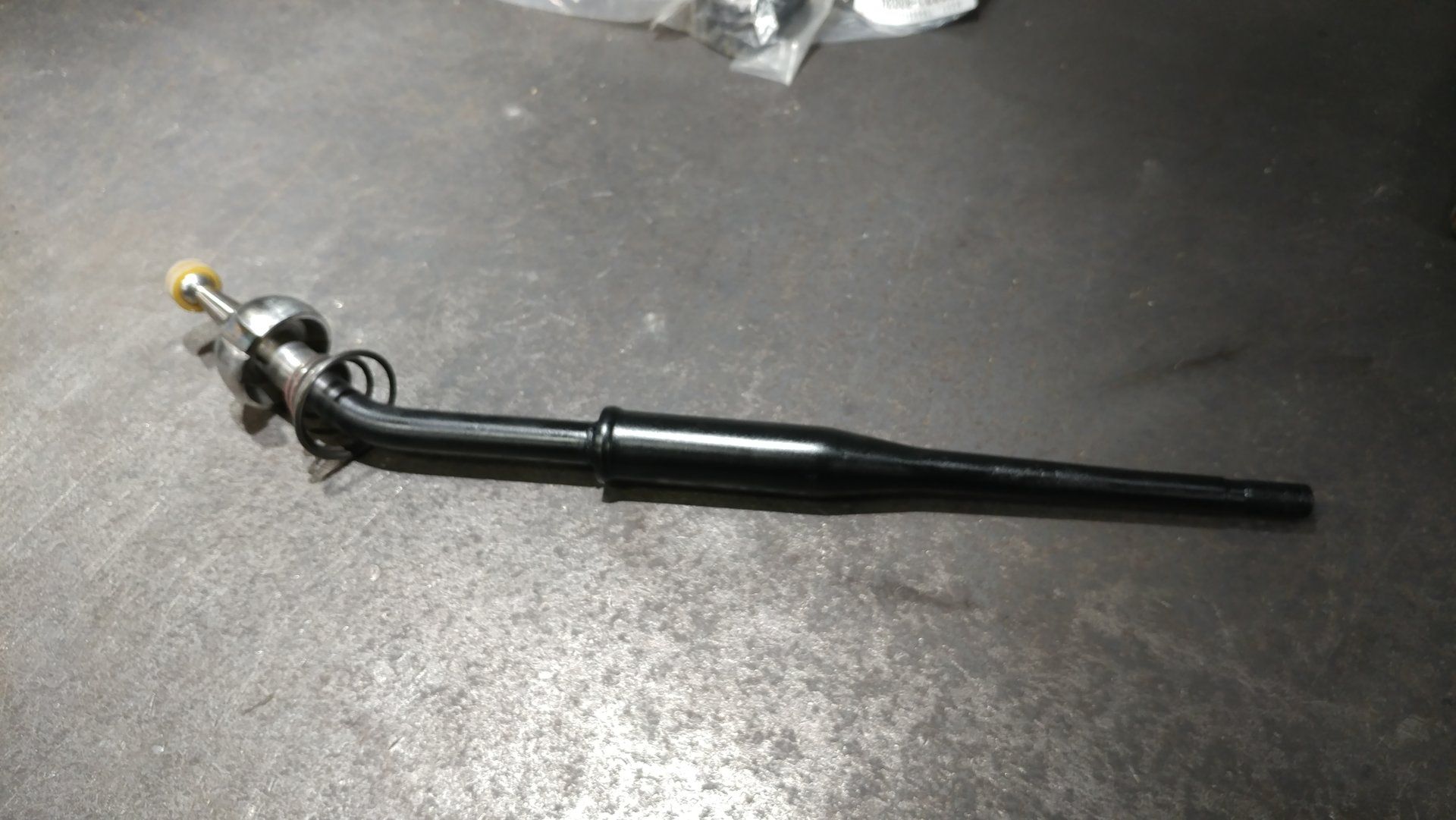

can you post a couple of pictures of the ball part? I can't get my shifter out, it only goes up a little and stops. Thanks.
Already in the truck but I think I have the old one. We have a tool that we use on the 40s to get them in and out. I saw my guy using it yesterday. The one on my 79 series went right in....almost too easy.
I do miss my old Troopy. Need to get rid of a few before I can add more.
Just add warehouse space....problem solved :)
Hope this helps...
thank you. I’m guessing I am having trouble with the plastic piece on the end
Good luck with it....should pop right out after you get the lock ring off.

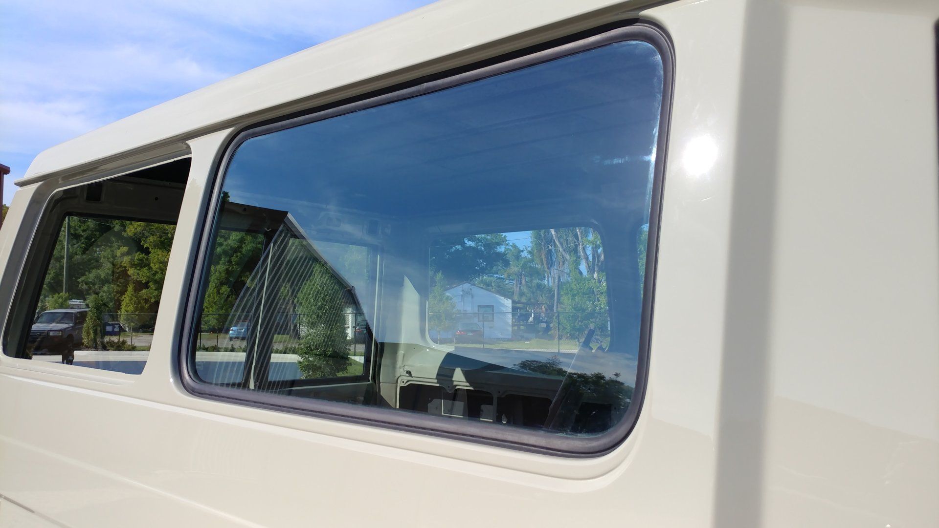

Troopy got a lot of work done to it today.....we played glass guys and installed the 2 side windows and the rears. Unfortunately, the guy in charge of ordering parts(me) forgot to order the runs for the sliding side windows.....so those have to wait to go back in. Not sure how I forgot those.
Went with all new glass...the glass that came with the truck was horrible and most of it wasn't OEM. This is the cool green stuff...looks really good. New gaskets all the way around. I was holding my breath when we did the driver's side rear door...it was pretty tweaked. Fortunately the window fit perfectly.
