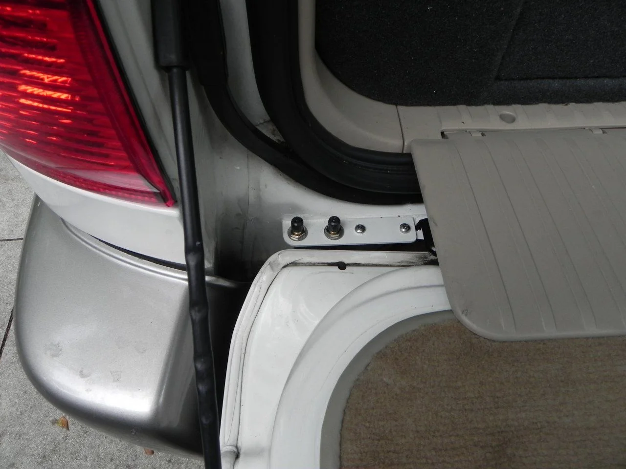

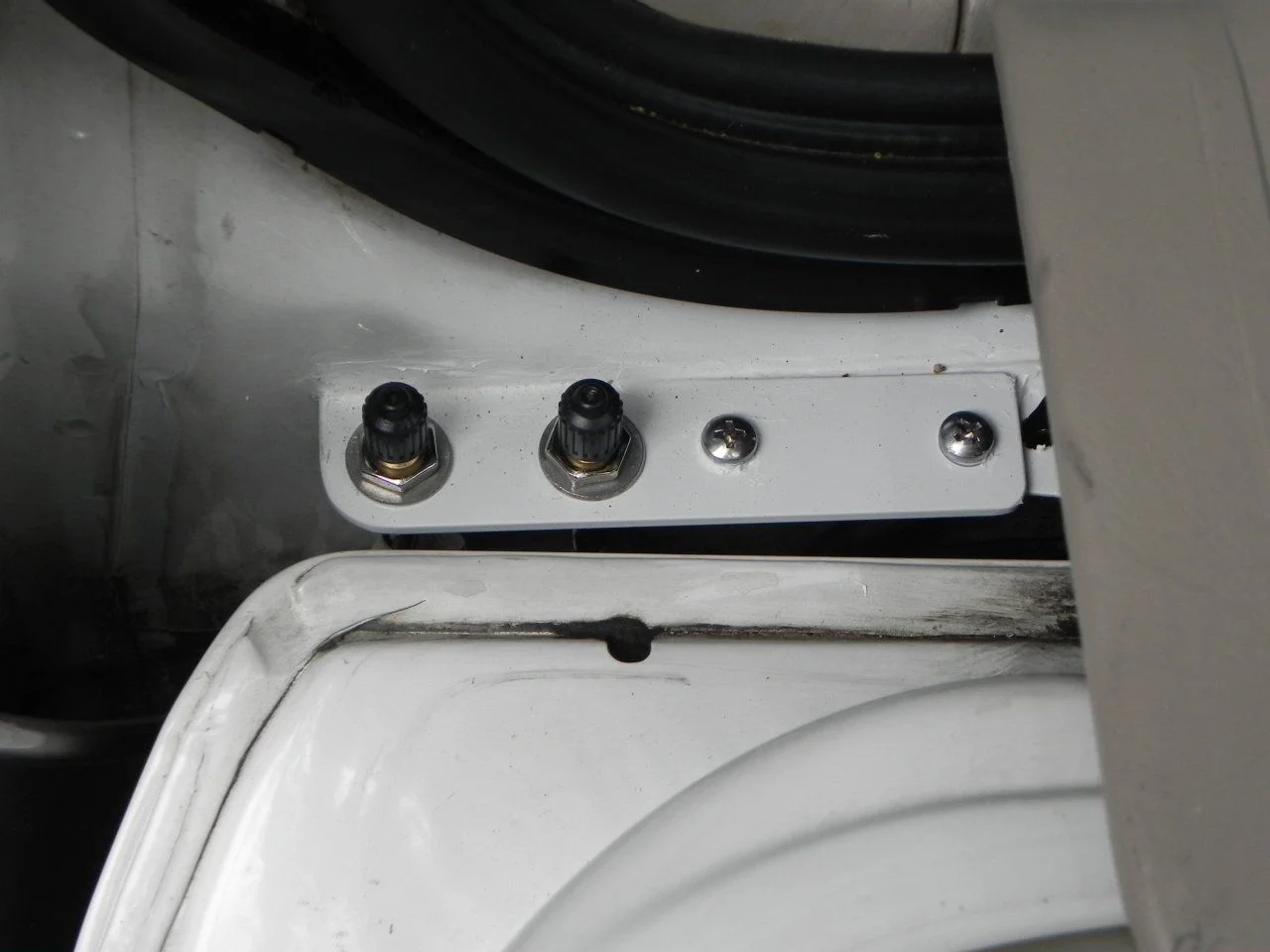

I made a bracket and mounted the air fittings inside the tailgate (see pics.) for protection and easy access.
The air lines come up from underneath by the frame and inside the bumper. I did not "T" mine. The lines were just long enough but it took carefull planning.
Don't forget to maintain 5 lbs. pressure in them even with no load.
