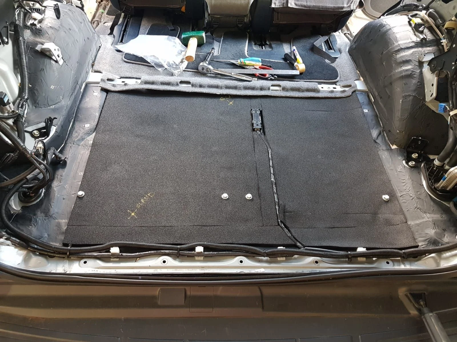

-Sripped the rear half of the interior, sound and vibration deadened and added a hidden floor box (frontrunner)

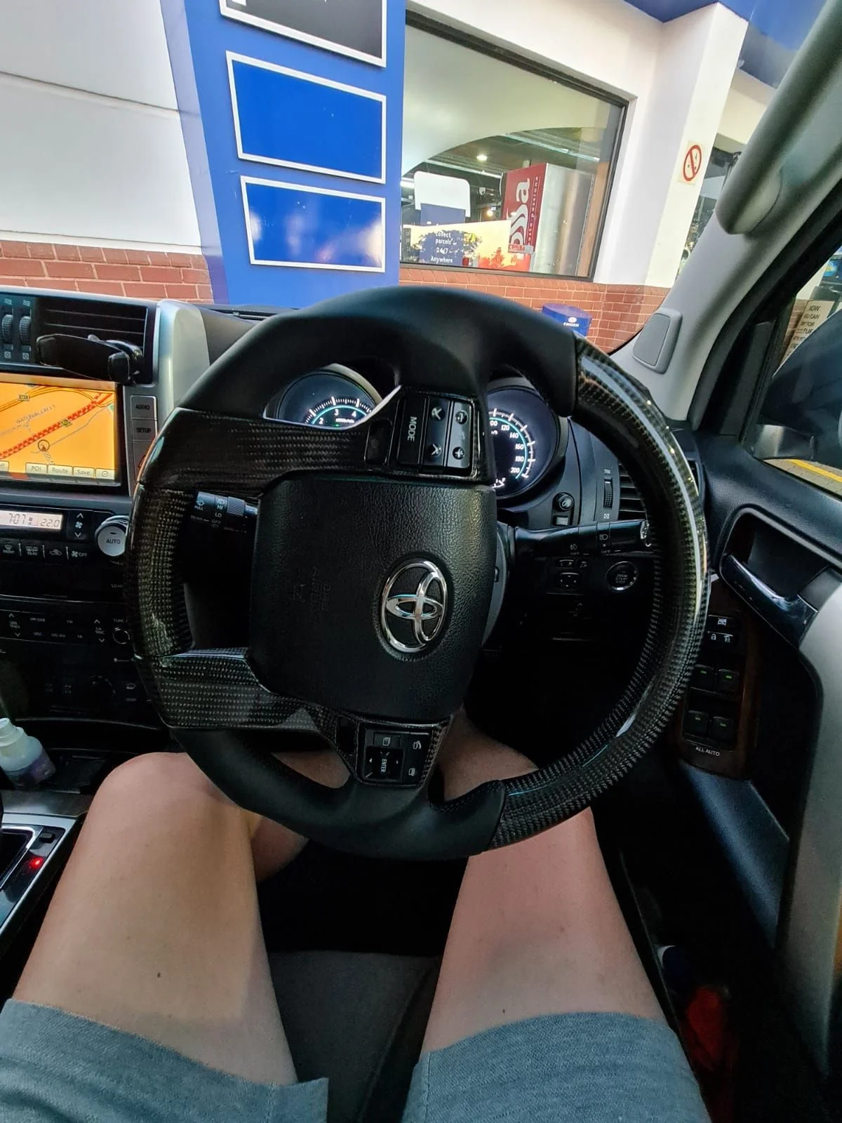

-Carbon wheel (work in progress, switches differ to the tacoma apparently haha)

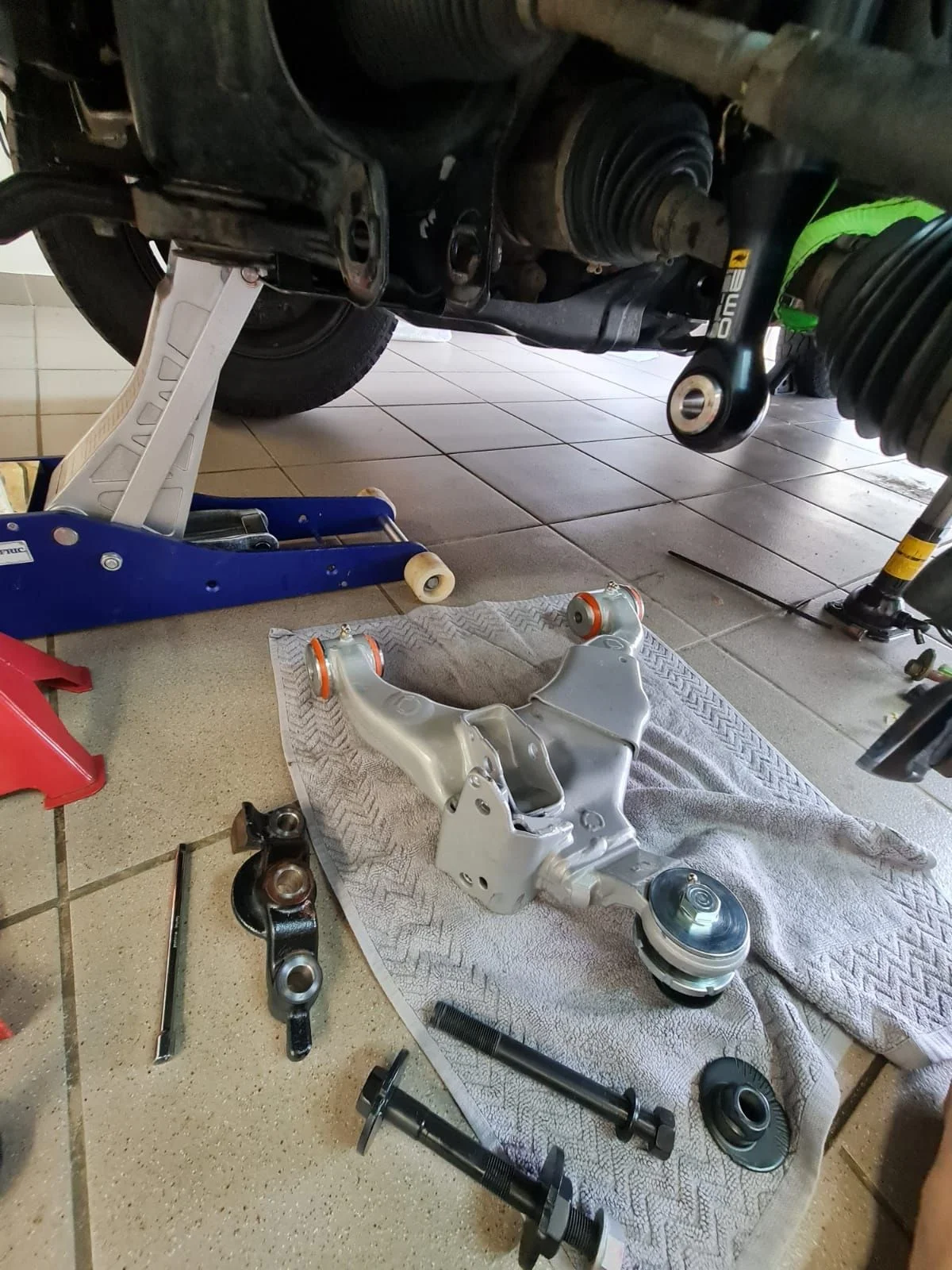

-Ironman UCAs
-Custom LCAs

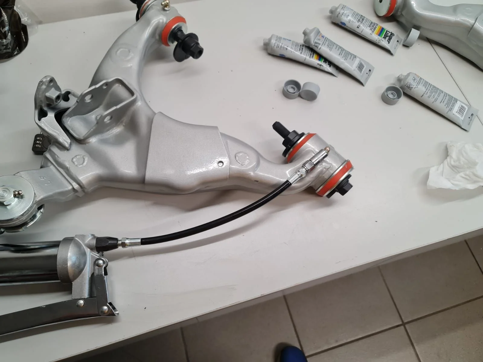

will post a lot on this as its been a long road, but I think im there. I didnt want increased weight like the aftermarket, so I did custom polys with en19t chrome moly holders and chrome moly spindle. machined to increase spherical by 3 or 4mm (from memory), zercs for greasing etc.

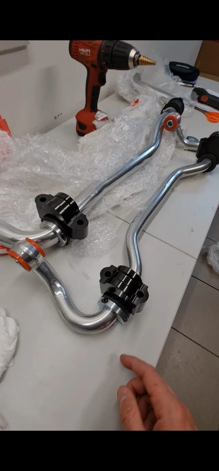

-KDSS - my nemises and I almost just deleted but I love the road handling. So Ive also done custom KDSS bars, ceracoated, alu stops (to eliminate the rubber on rubber squeaking), with oilon spacers between and custom poly (80 shaw) on the ram side.

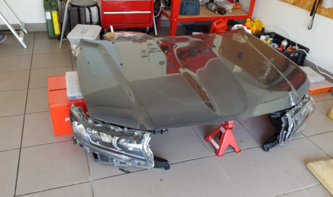

-Full 2019 front end :devil:

probably the most time consuming job to date...but transformative. Bit shocked that there is no real sound deadening under the oem carpet and plastic.

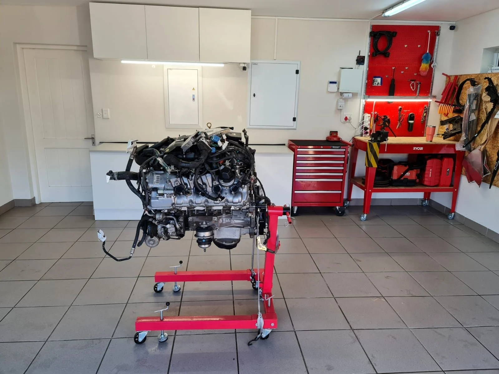

The next heart :) . 2ur-gse

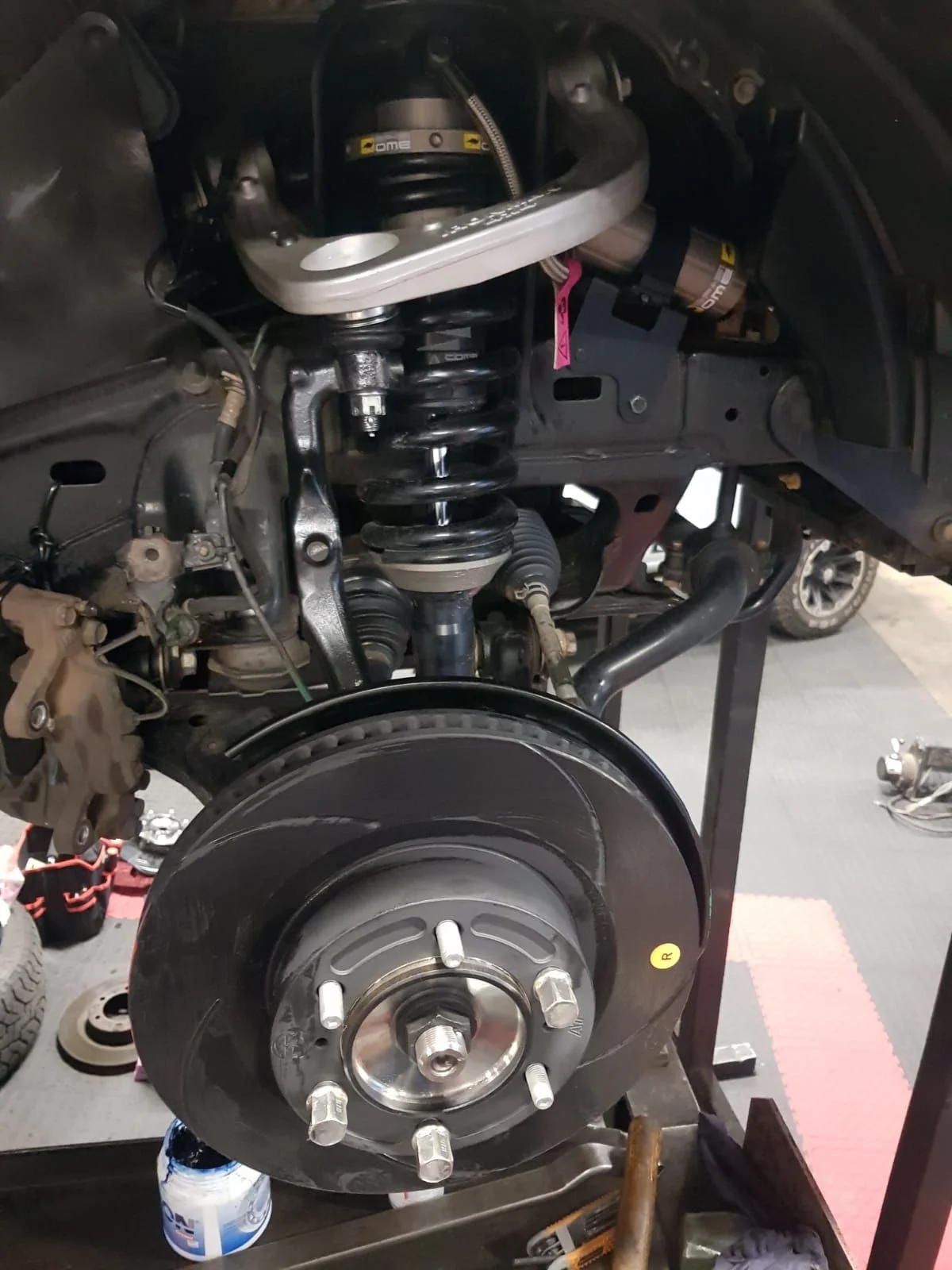

Ironman UCA, BP51, powerbrake
the new wheel
Beautiful.
What was the original engine?
Its still in :) 1gr-fe. It does OK at sea level, but we're at 5500ft here and generally quite hot (so density altitude will get to 9000ft). Its a bit asthmatic at altitude and they have heating and some other design issues. I figured rather than go forced induction, id swap, and the 2urs are phenomenal in design and build.
