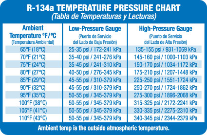

I have converted nearly all my older R12 vehicles to R134a. I always try and take apart the lines and flush with brake cleaner and compressed air to get the old oil out, and I replace as many o-rings as I can easily get to. That's about it. Fresh PAG oil and R134a. Fill it until the gauges show good pressures.
With a new blower motor and fresh R134a charge my troopy gets nice and cool now, even on a 95 degree Florida day! Next up, window tint.
