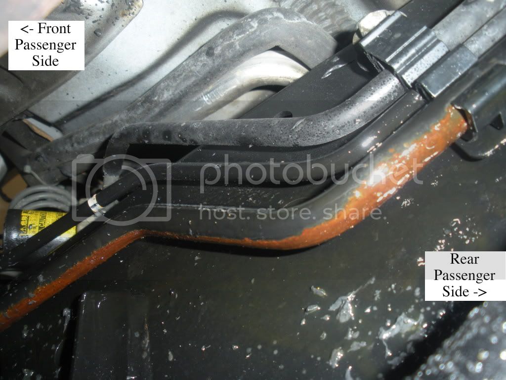

Hey everyone. I noticed a small puddle under the passenger side running board a couple days ago and thought nothing of it because it has been raining here a lot lately. Well, today I noticed it hadn't evaporated so I took a look underneath and found a large diameter line running from the engine compartment to the rear of the vehicle leaking a clear liquid. I'm guessing it's the rear A/C line. It's located just inside the passenger side running board. I also could hear a slight hissing coming from the line. Has this happened to anyone else? Is is a DIY project to fix? Thanks.

There are several separate lines to the rear AC system. The dealership will want to replace all of them to "ensure" a full repair. You are lucky in that you know which line it is. Order a new line from your local dealer or get the best price through CDAN, and have it changed at an independent AC shop. Take this time to renew the dessicant as well. You should be well under the $400 cost of simply closing off the rear.

I ended up taking it to a local shop and it was around $275 total for the line, install, and freon recharge. It ended up being the smaller diameter line that runs the whole length of the truck. They had to drop the exhaust just to get to it. So all in all, I think I got a pretty good deal. It's been good ever since.
