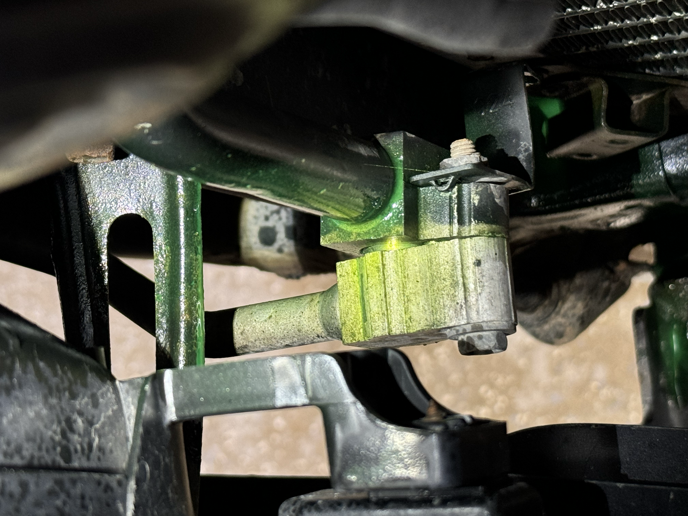

I am needing some help on my 97 Land Cruiser. Went to charge the A/C system since is was not blowing cold. During recharge, the A/C discharge line started hissing and leaking some coolant. Attached a picture to show leak. Question, what would cause this? Where do I start on diagnosing and fixing this issue? I want the A/C to be fixed but want to make sure I start in the right spot. Thanks all!
How long have you been chasing a leak?
That's indicator dye showing where the leak is. It's not coolant.
It's usually UV light sensative to help you find the leak with a UV light.
The fitting should be pulled flat with an o-ring in a recess. The fitting is either bent, or loose; and it appears that the o-ring is missing.
I'd start there. I would also flush the entire system to remove that dye, its acctually a contaminant.
I would open every joint and replace all the o-rings, use Nylog lubricant on the o-rings before replacment. (thank you @flintknapper )
After flushing you will need to add the correct amount of PAG oil for 134a (see FSM).
Be sure to change the dryer.

Just started chasing it, bought it in January.
Well I feel dumb thinking it was coolant haha.
I will probably replace parts affected to be safe. O ring is in tact but obviously something cause it to fail.
I do not have proper gauges, fish scale, or vacuum pump, will need to grab those. Any recommendations on those appreciated.

Nothing to add to this. It is spot on.
Find out why the fitting is not fitting flat and then proceed with the rest of the above. 👍
You can typically borrow all of the specialty AC tools that you need from chain auto parts stores.

Not to barge in on Jon's thread, but the UV dye is a contaminant? The sell PAG oil with dye included, are you saying it's not a good product? I'm about to get started on my own AC rebuild, and I had intended to use oil with dye, not because I expect leaks, but simply as a potential diagnostic in the future.
You'll be fine IF you just use a PAG oil with dye in it. The percentage of dye to oil can be the trouble when folks/techs inject dye into a system. Too much dye can break down the lubricating ability of the oil.
Using 8 ozs of PAG with dye added is safe enough....as the percentage of dye has been considered (this assumes a newly evacuated and flushed system).
DON'T use things like A/C stop leak.
Yeah, that makes sense to me and is what I had assumed, but @jpoole 's post kind of caught me off guard. I can see how a general purpose UV dye added to the oil could be an issue (let alone stop-leak).
