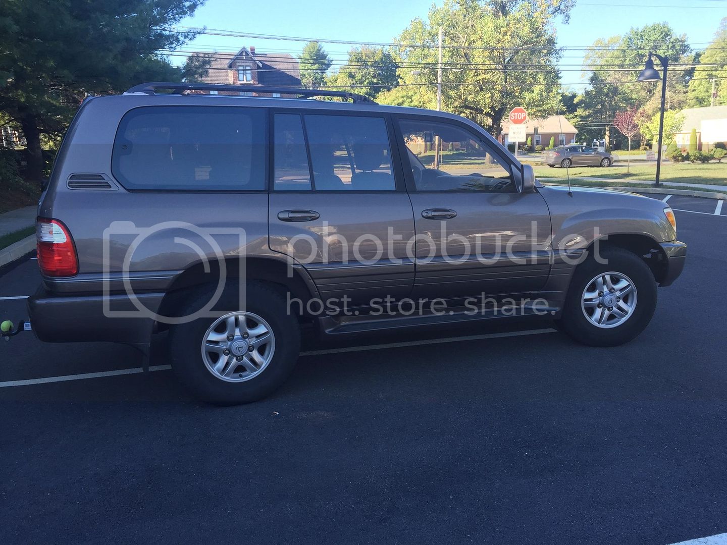

Hi everyone. Great forum. I belong to a few, my automotive tastes go from VWs to diesel MBs to 4runners. While looking for another 4runner I saw a Land Cruiser which lead to LX470s. A bunch of research later and I looked at a 99 LC and this 99 LX470. The LC was beat to heck so the only option in my price range was this LX. It was close and the price was fair. Has 194k.
Here on the test drive:
IMG958071_zpsezjrzsqx.jpg~original
AHC is not working correctly. Going to diagnose a little bit first before deciding what to do.
