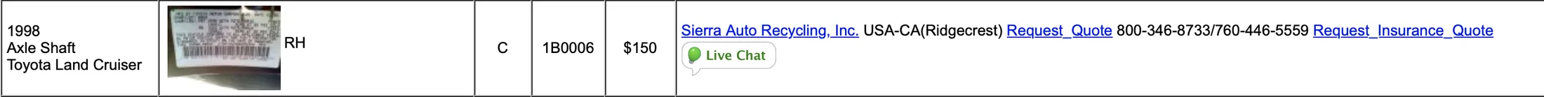

Sounds like cake! I guess the only potential issue would be sourcing a used right side axle shaft that is from a locked LC.
Most of the only parters just list them without knowing.
