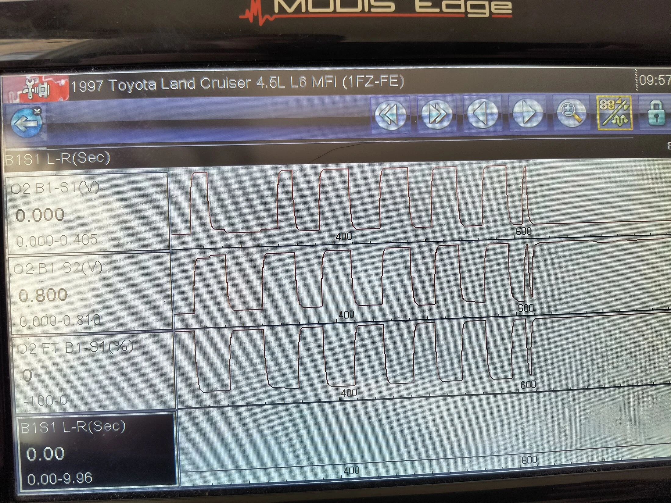

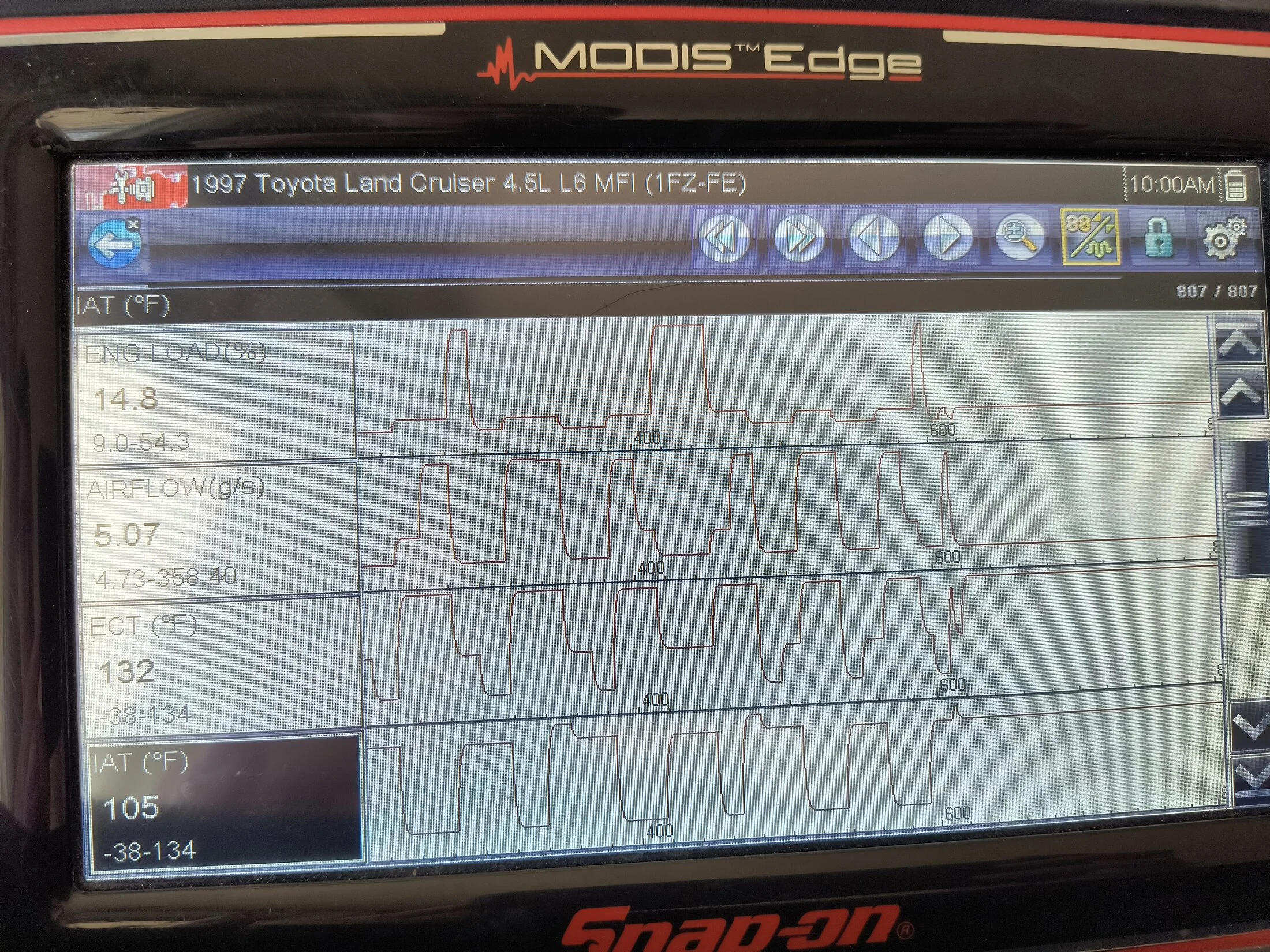

When I hook up a snapon scanner tool (modis edge) the data reads like it is accurate for a minute or two but then it starts jumping around like the pictures and I can't isolate anything because of it. I have an O2 sensor code but look at the other data the ECT is clearly not -38 degrees. And all of the PIDs do this, one extreme to the next. and it is pretty consistent not jumping back and forth fast like a loose ground. Also zero change in engine idle or anything while this is happening so I don't know if this is a ghost or what? I've checked so many ground wires and cleaned and reconnected and jiggled and no change. Anyone else run into this? TIA
Look at the wiring harness by the EGR. It's known to get cooked.
