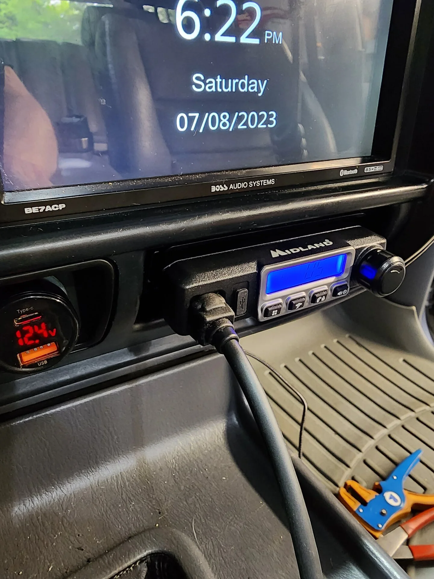

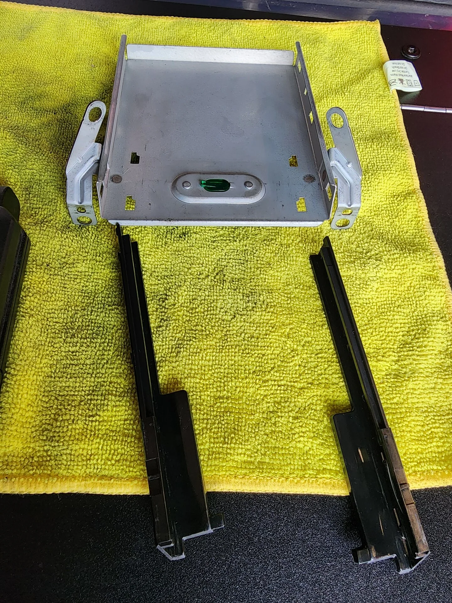

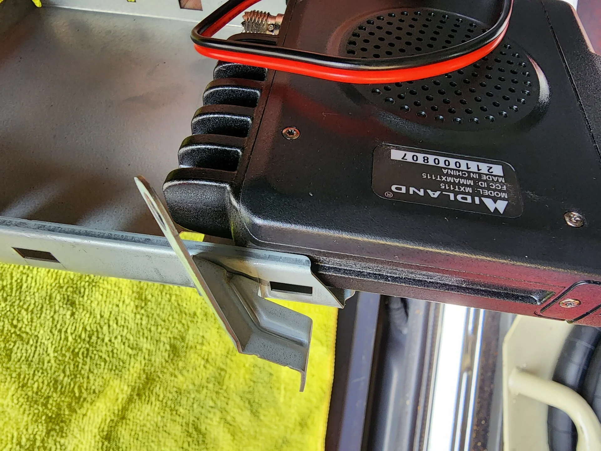

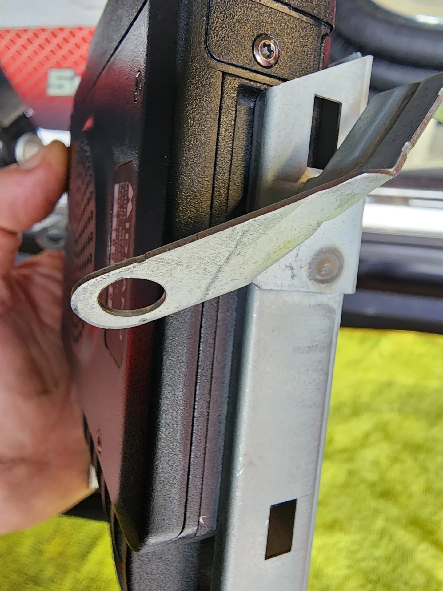

Installed a Midlands mxt115 gmrs two-way radio in my 97 fzj80 ash tray compartment. Removal of the o.e.m. black plastic guides from the ash tray bracket. Then just slide the radio into the guide less factory bracket.
Slick!!! If only the locals used cb by me.
Very nice. I haven’t seen a post doing this, although it’s been brought up repeatedly. Makes me want to switch out the Uniden CB. Thanks for the post.
Where did you mount the ant?
A few years late to this. I think this idea is so sick. Does anyone know if this works on early models? I have a 94' and I am pretty sure that metal retainer is different. At least the screw holes that mount it are.
