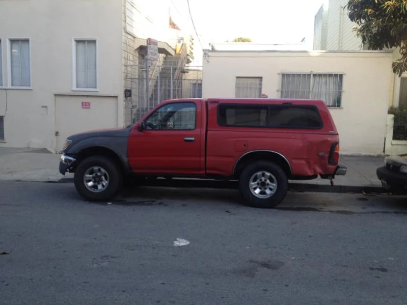

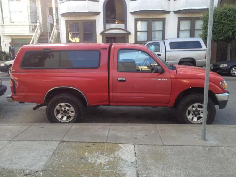

So I might pick this taco up. It's a 95 with the 3.4 v6 and 4wd regular cab with 160k. Cel on and has passed ca smog yet. Body's a little beat, but whatever, want it as a work truck primarily. Anyways, do you guys thing the frame is bent in these pics? It's not super apparent when under the truck, but it definitely has a swagger along the bed and cab.
If so, what should I offer for it?

With that hit in the bed from a rear-ender I'd assume the frame is bent. I'd keep looking. For garbage duty, I'd just pick up a 2wd 4cyl Tacoma to keep the cost down. Then you can eventually build a prerunner out of it. :grinpimp:

Is it the frame or is the bed bent and pushed up against the cab giving the illusion of a bent frame? Check the bed mounts for bends or damage. Also, that shell may be shifted around adding to the illusion. Since you already got it, I would just pull some measurements between the bed and cab on each side. Also, have someone else drive it and get behind them and watch how it drives down the road. That is the best way to see if it is crab-walking on you.
thanks for the advise about the crab walking. I'll check it out this week and see if its doing it. Even so, I'm only gonna focus on this things mechanical reliability rather than its structure (cooling system, fluids etc...)
Everything rides pretty straight. Took it for a spin to la and back to sf. It Flew down hwy 5 and through the grapevine. Not a single hiccup.
Straightened the bed out by shimming the rear up. Now it looks more normal.
