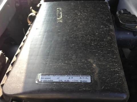

Mines on the top of the airbox. I don't know if there is a standard place but it should be fairly visible when you open the hood.

FYI, my 90k mile service is on a sticker on the resonator (?) box in between the Intake box/MAF and the TB. It's that oblong square box that sticks out of the intake tube.
This is what you're looking for (what the sticker looks like).
My shop gave me the sticker to put on. These seems to be no standard place to stick it. A look at the condition of the serpentine belt should give you a good indication since they're often changed at the same time. But your best bet is to do as a previous poster suggested and look it up on http://www.toyota.com/owners/
