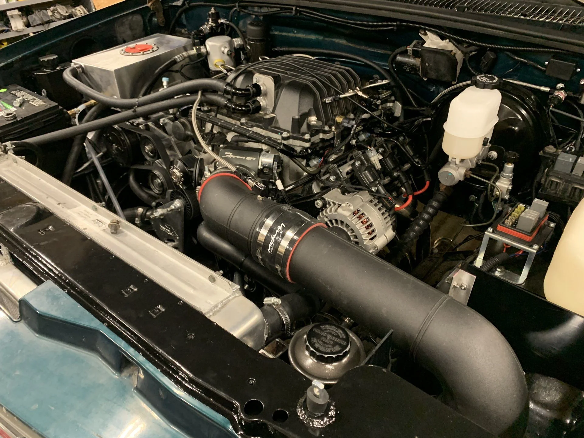

Whoops, I intended to specify that. I edited the post. It's on the driver's side inner fender under the brake master cylinder. A rubber line goes from here to the banjo on the fuel filter.
Not much help for your actual question, but this page shows how he adapted and the fittings used to do so.

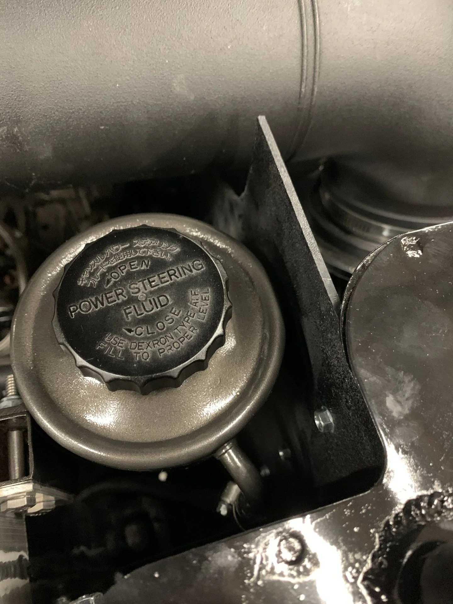

what master cylinder is that?
It’s just factory GM for 90s pickup. May be hard to tell from pic, but that’s not an 80. Just sharing a cool build that my old power steering reservoir is now on. Lol
