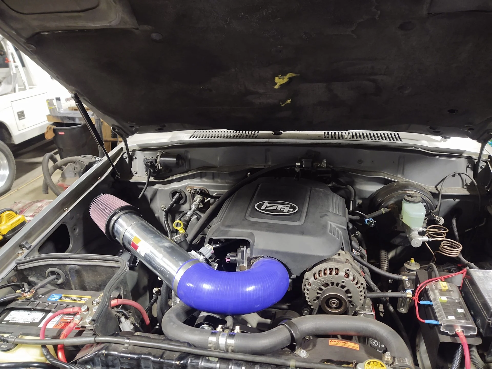

Pretty much have everything buttoned up on the L92/6L80E swap. Finished up the wiring and last few miscelaneous issues. The truck heads off to the exhaust shop this week for mandrel bent stainless system. Had to add a little hybrid swap twist to the "Voretc" engine cover. :hillbilly:
