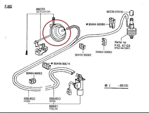

When I turn on the A/C: The vacuum pot (circled red) does it's job in pulling a vacuum and increasing engine idle.
When I turn off the A/C: The vacuum pot does not release the vacuum and thus the engine idle remains high even though the A/C compressor is off. To work around this, I hardly use the A/C. When I do, I have to pop the hood and manually remove the vacuum hose (grey hose above) from the vacuum pot...the vacuum is released, the engine returns to idle, I re-install the hose and all is well.
Question 1: I vaguely remember something about scavenging a compatable a/c vacuum pot from a late model corolla. Is that correct? If so, what year range? I have searched unsuccessfully.
Question 2: Because the vacuum pot is holding vacuum, I assume the diaphram is good. Is there something else in the system that is not allowing this vacuum pot to release it's vacuum?

I would continue to use the A/C as the high idle function is not going to cause any issues. Until you can figure out what is causing the truck not to resume normal idel speed.
It's probably the valve (idle up solenoid) that controls the vacuum to the idle up actuator. Valve should be normally closed, but open when you apply 12V. Diaphragm on bottom of Idle up solenoid will release vac when no power to it.
It's the thing the two hoses go to.
Old thread...I know, but I just wanted to say thank you! This was certainly the information I needed to solve my issue.
Just got truck back after an AC revival trip to the mechanic (has not worked since purchase). When engaging fresh new AC, idle would go crazy high and stay there. Why high? Carb was rebuilt when AC was totally disconnected/out of commission, so screw was very tightened down.
But why sticking? After following Spike Strip's guidance to the solenoid, I pulled off the bottom cap and there was a strong vacuum sucking IN to it. This didn't feel right, so I checked the diagram posted by HopLite, and the two vacuum hoses were switched on the solenoid. Quick swap and we're back in business.
