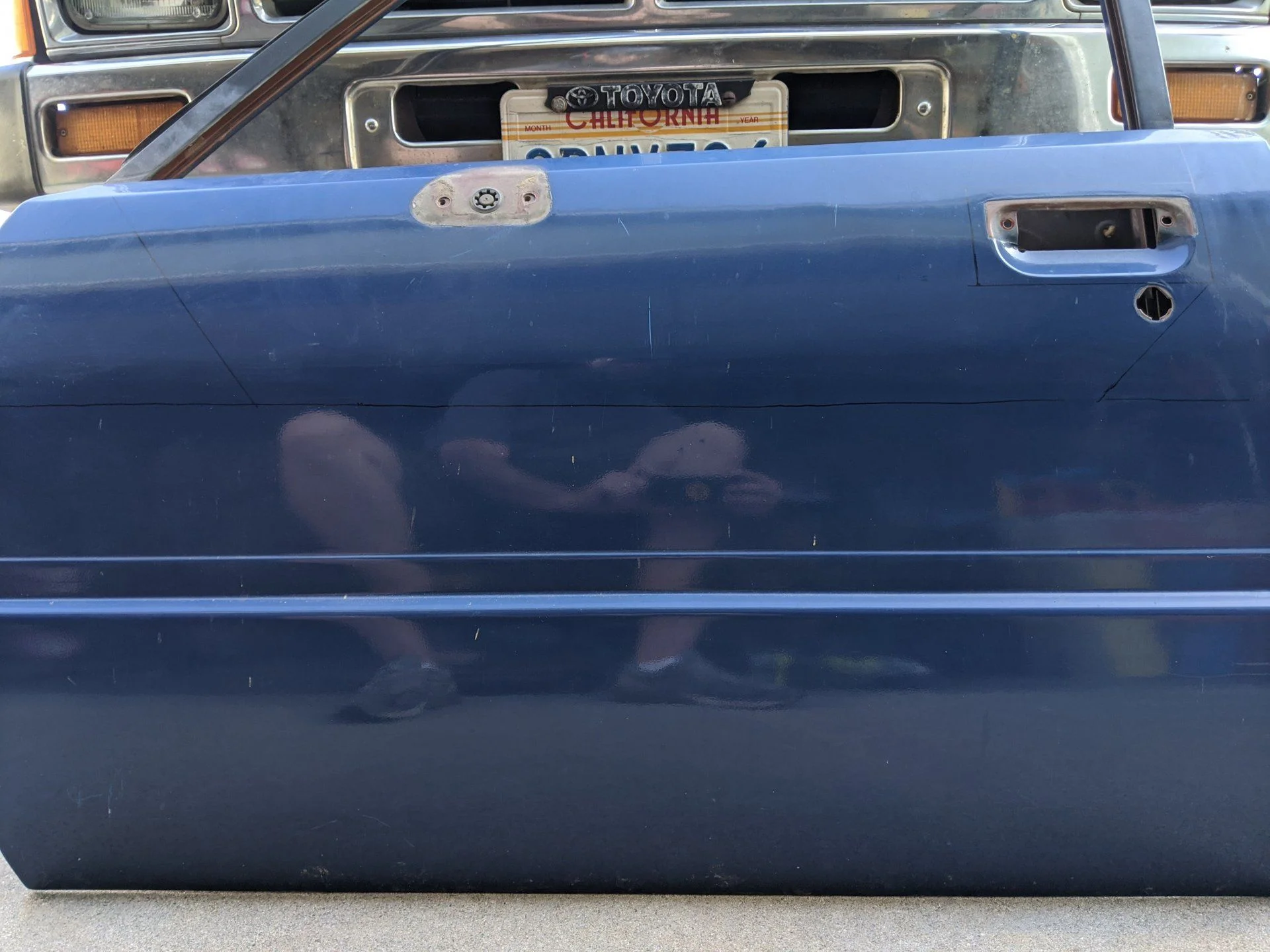

Marked it out earlier this week

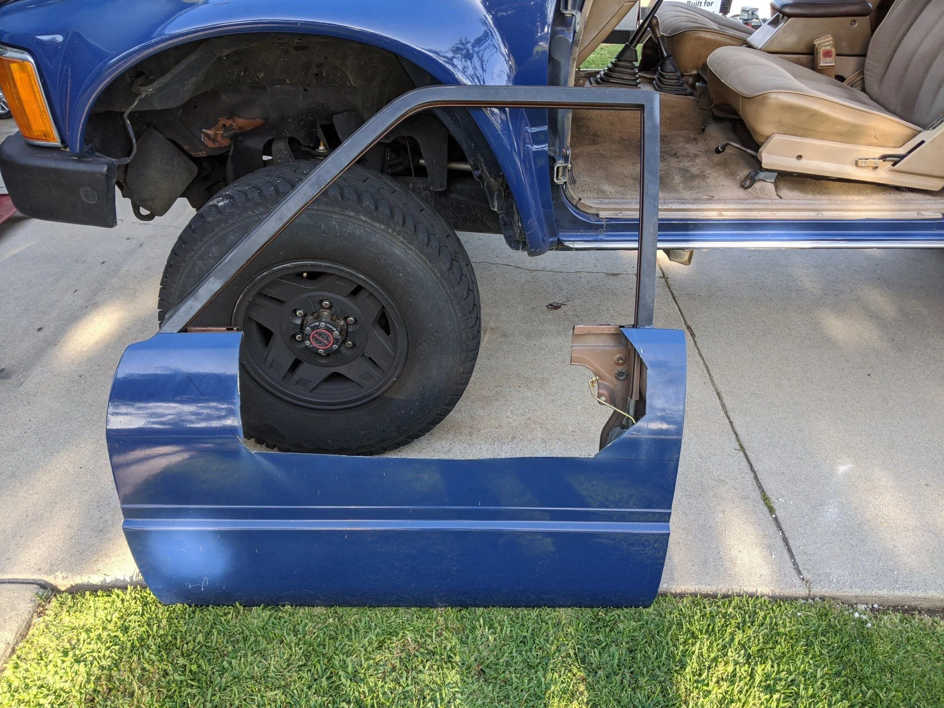

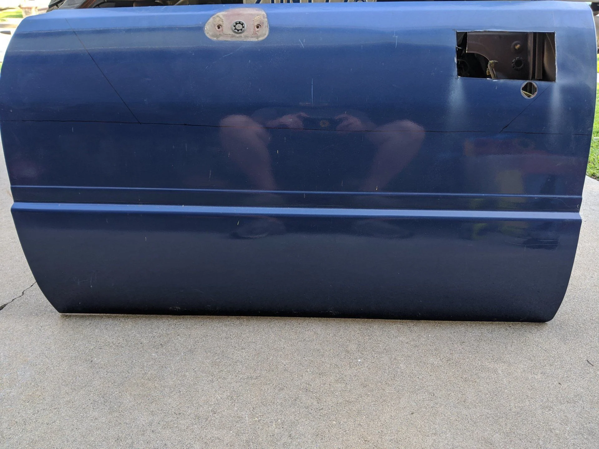

Cut out the door handle section separately in-case I want to try and use it later.
First cuts inside.
First cuts outside
Estimated incorrectly on where the outside of the door should land and make my cut at the back of the door a little too far back. Stopped myself from making any cuts on the front of the door and ground my edges straight and smooth and paused here for the night. Probably start back up come morning.
