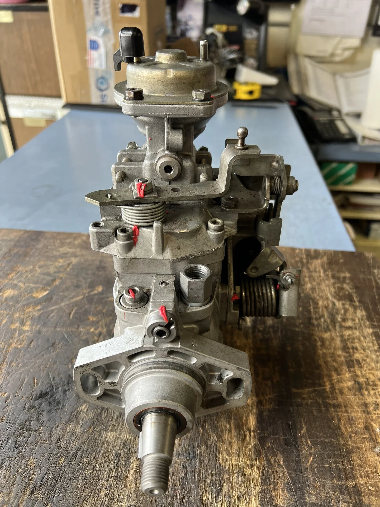

A local diesel shop got a rotary pump from a 86 hilux to try and fix. He can’t figure out the top of the pump with the two nipples on it. Nothing in the info he has shows this type of top, he unfortunately doesn’t have any more info about where this hilux came from and what engine. I would assume it’s a JDM hilux since that’s where most of them came from here in the US. He will try to find out if it’s from a 2L or 2L-T. If anyone has any insight on the top he would appreciate it. Thanks
Is there a tag with numbers on the side?
Put the 10 digit number in megazip catalog and it will tell you what vehicle it’s from
