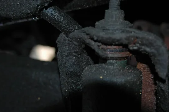

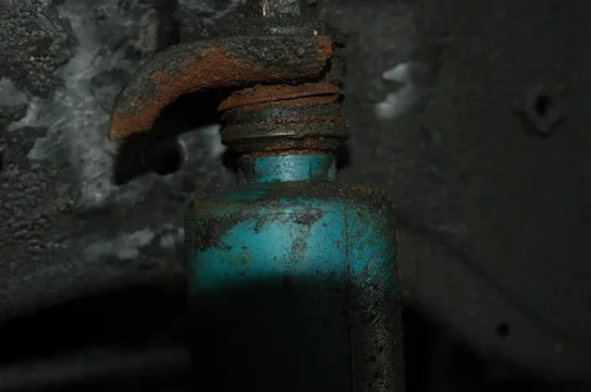

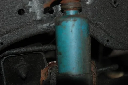

Issue 2: The right front shock has broken off from the mount. I've attached some pictures. I'm apologizing up front for the poor quality, I did this in the garage, not on a hoist. The oily substances is not a leak, but an oil spray I have put on every year. My question is, can this mount be rebuilt, or can one purchase a mount as a replacement. Since I've not had the truck up on a hoist and able to view the shock and mount situation in its entirety. I can only speculate that the mount would have to be fabricated? Does anyone have any suggestions to how this mount might be fixed?

1: right front shock, shock head with the broken piece attached.
2: right front shock mount and the head of the shock, purpose to show what is broken off.
3: left front shock mount and shock attached, purpose to show how the shock is mounted and what it looks like assembled.

That top shock mount looks rotten with rust. Im not sure if they sell those new,I cant see one in the parts diagram.
However someone may have an old chassis that can have a the shock support cut off and welded on to yours.
The upper shock mounting is common to all leaf sprung 7* series from 84-98.
It may also be similar to a 60 series
Someone may even be able to fabricate one and weld it on
I would have a good look at the other side ,you may need 2 of them.
Your engine cutting out maybe to do with the low oil pressure valve which cuts the EDIC off on the fuel pump.
They can be troublesome.
I think it can be bypassed but Ill leave that to the 3b experts,I can hear marbles warming up his computer now:D
This vehicle looks really sick I would have run a mile in a couple of minutes at the sight of that much car cancer.
You need to find a vehcile to copy the front shock mounts from or a wrecked cruiser to borrow the shock mounts from and graft them onto your vehicle.
I suspect you are going to find more surprises when you start cleaning the chassis up. I would be sticking my fingers inside the chassis rails for a checkup and cleaning them out with a high pressure hose also. Remove all the inspection plugs in the chassis also and be perpared to fall down with shock.

As to the shock mounts; yes frame and mounts are badly in need of some TLC. However, that is not in the budget at this point. Unfortunately, time is of the essence and I need it up and running sooner than later.
Upon roscobj 73's suggestion of fabricating a new mount, I did some homework and found a steel fabricator/wielder who may be able to make something up for me.
