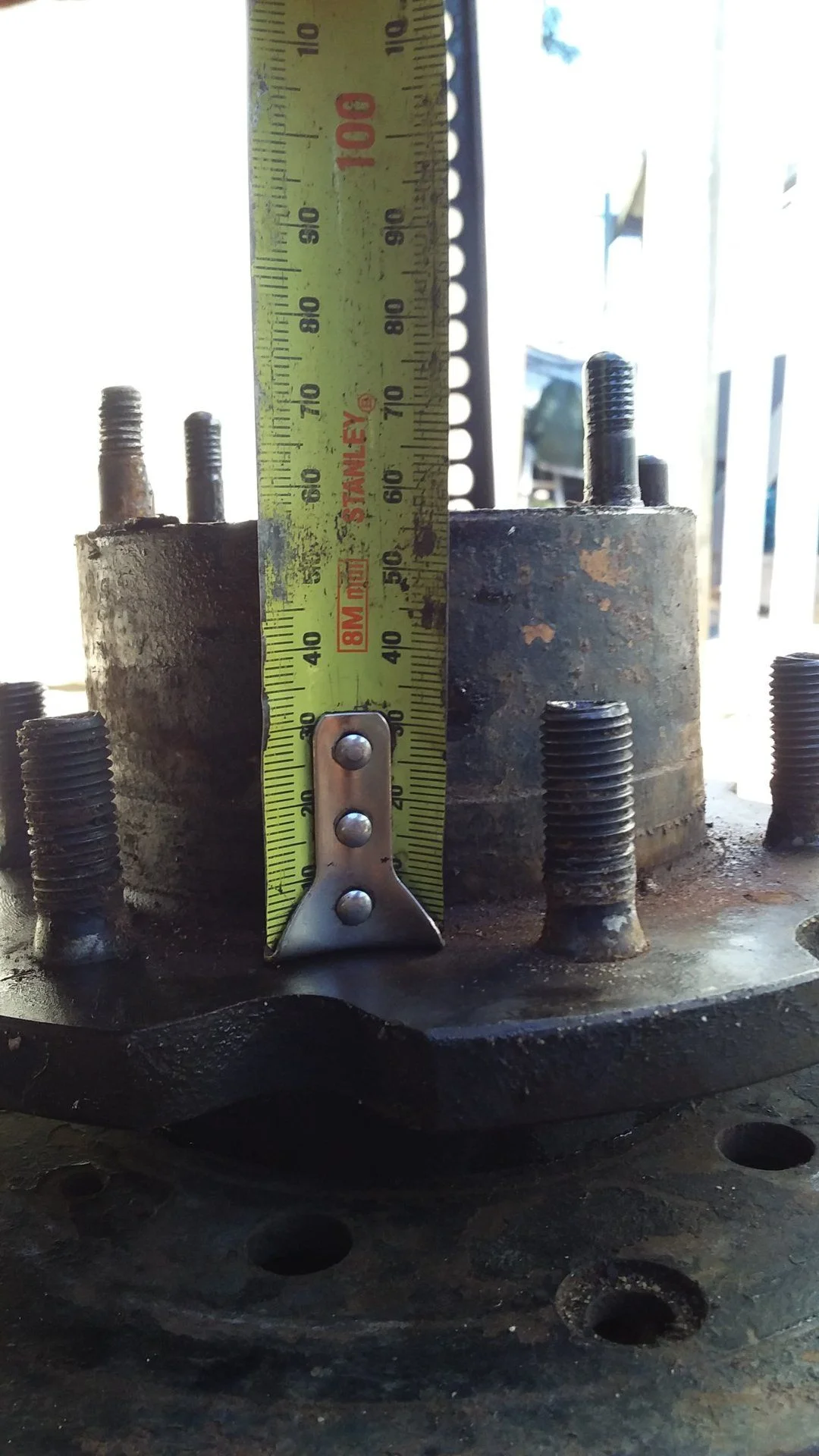

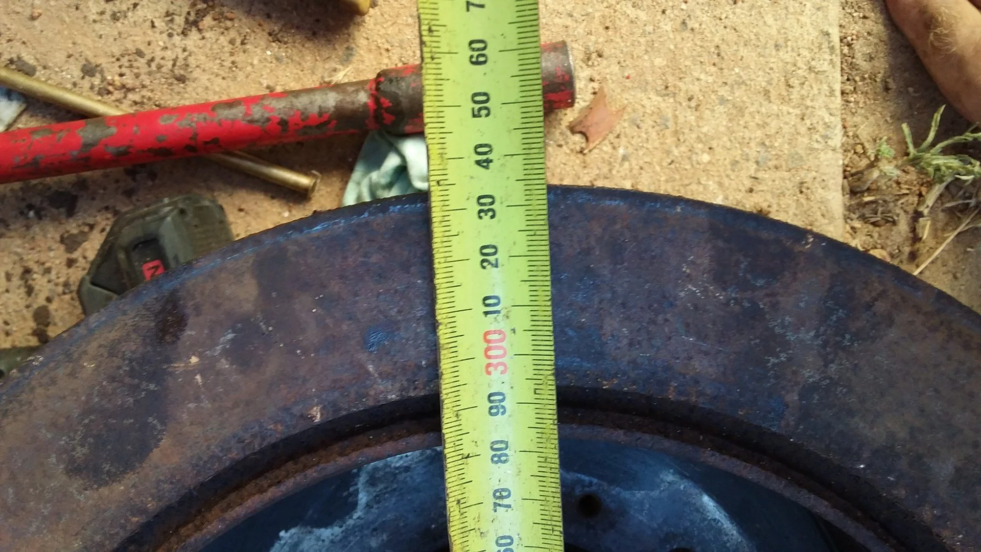

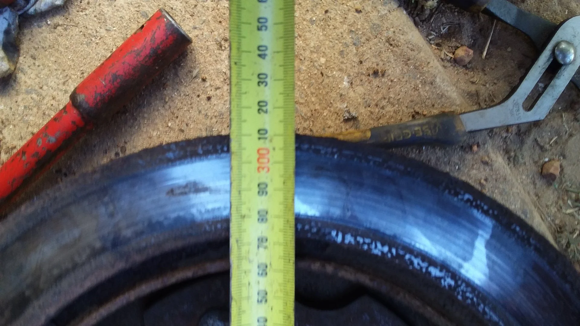

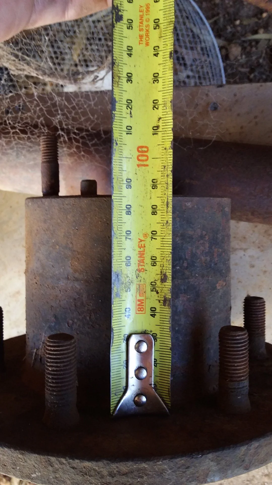

Fitted up some 1995 80 series hubs rotors and backing plates with handbrake assy to my 1993 fzj75 troopcarrier gained roughly 2.5" in track width plus 335mm rotors
75 series hub
80 series hub
75 series rotor
80 series rotor
