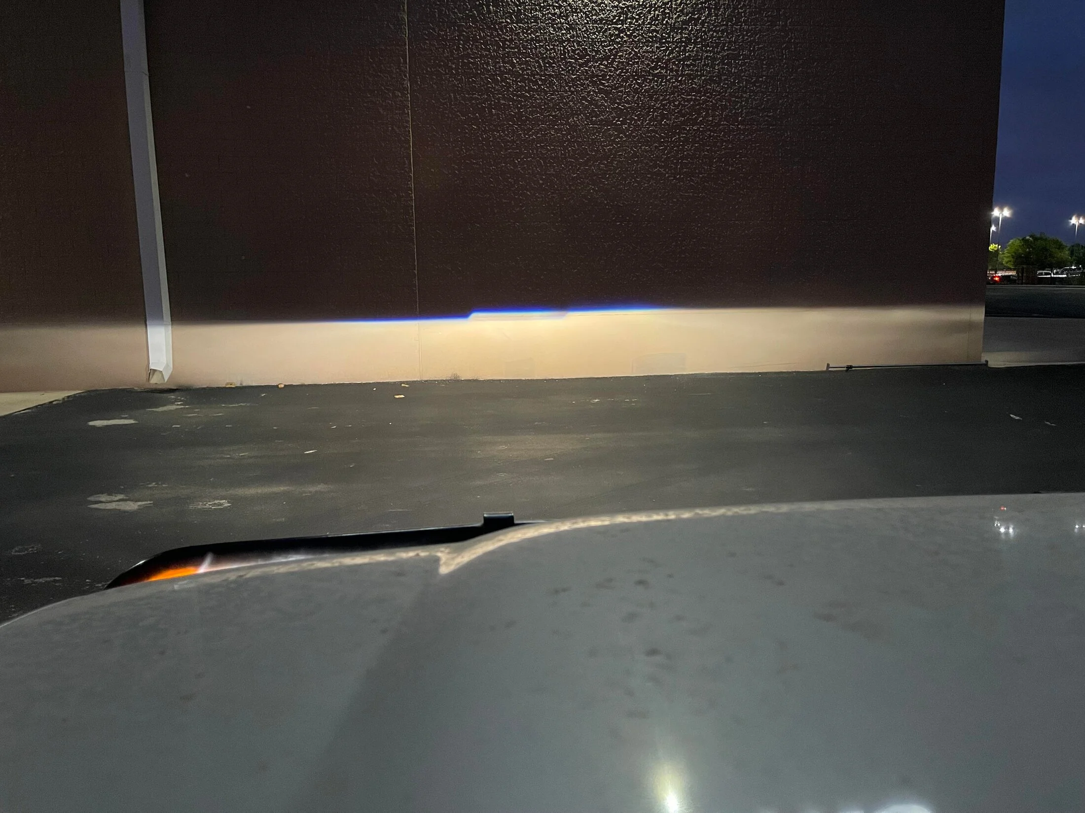

Depo clear lens headlights with a projector retrofit are the BEST option, not the cheapest one. Depo headlights are good, but when you have them professionally retrofitted that's where you get into the fantastic output category. I've been building 80 series setups for over 7 years for guys since they are so lacking from the factory. I'll include a couple photos below from past builds for reference. It can be DIYd but there is a decently learning curve to it.
