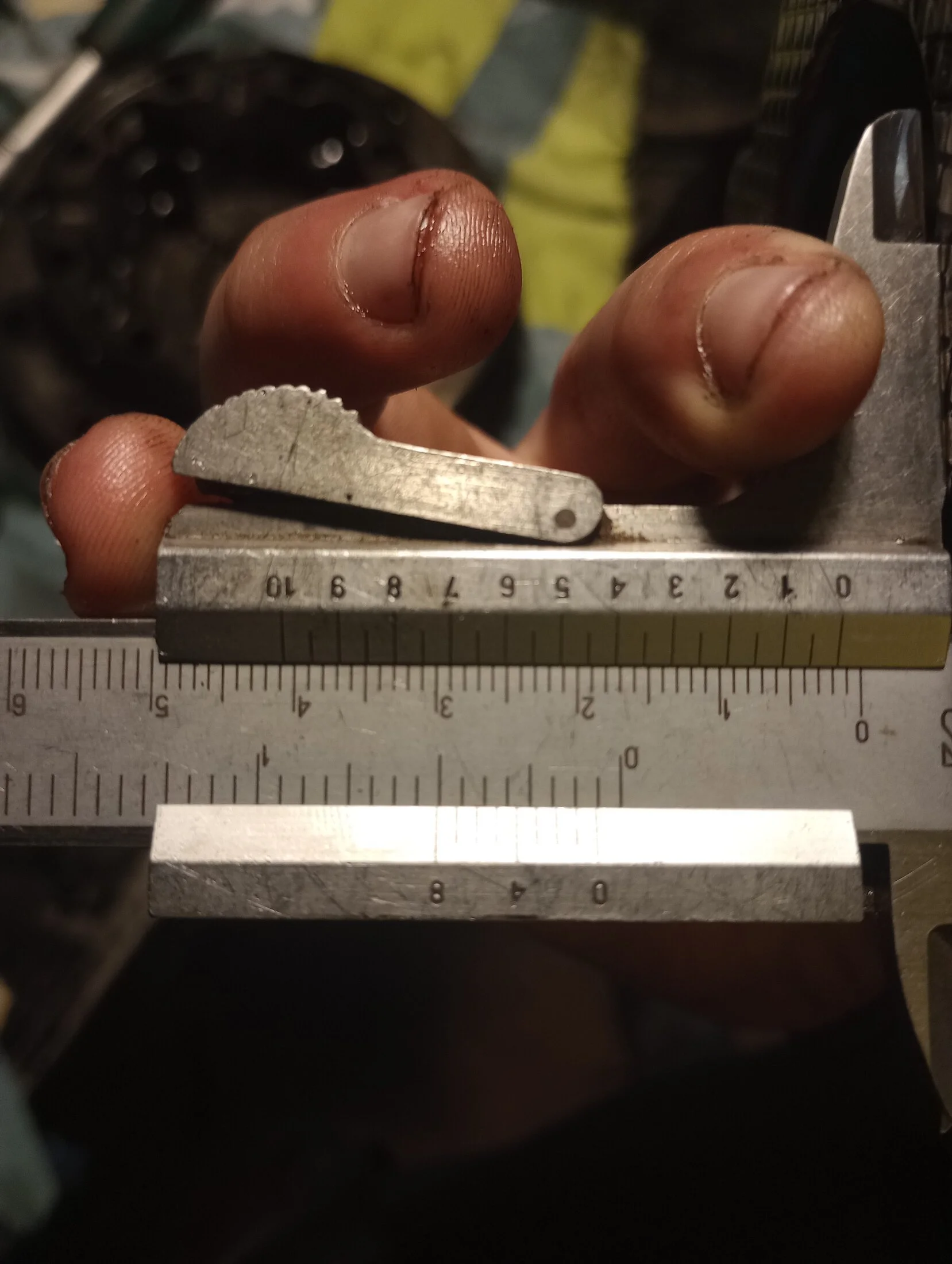

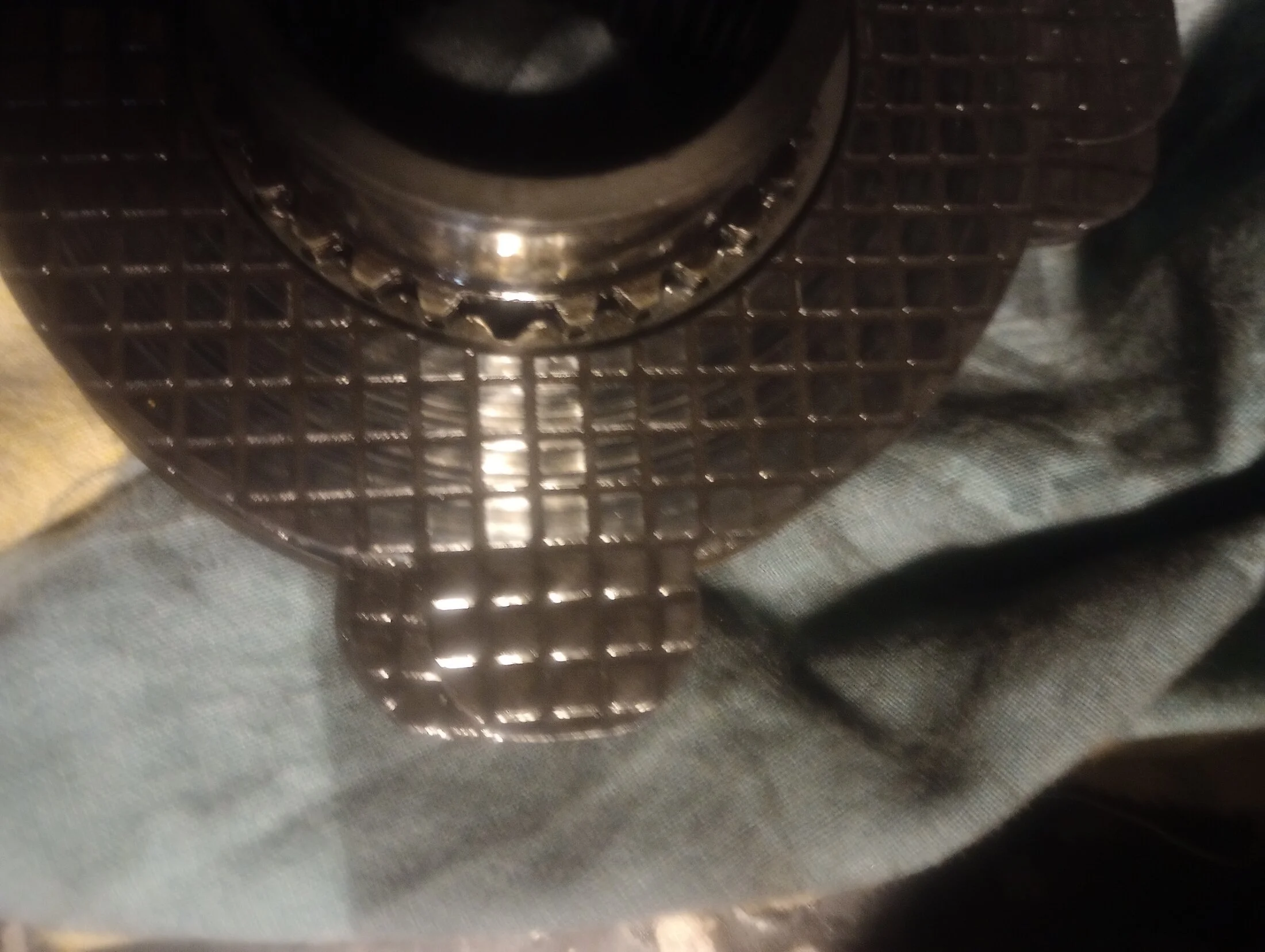

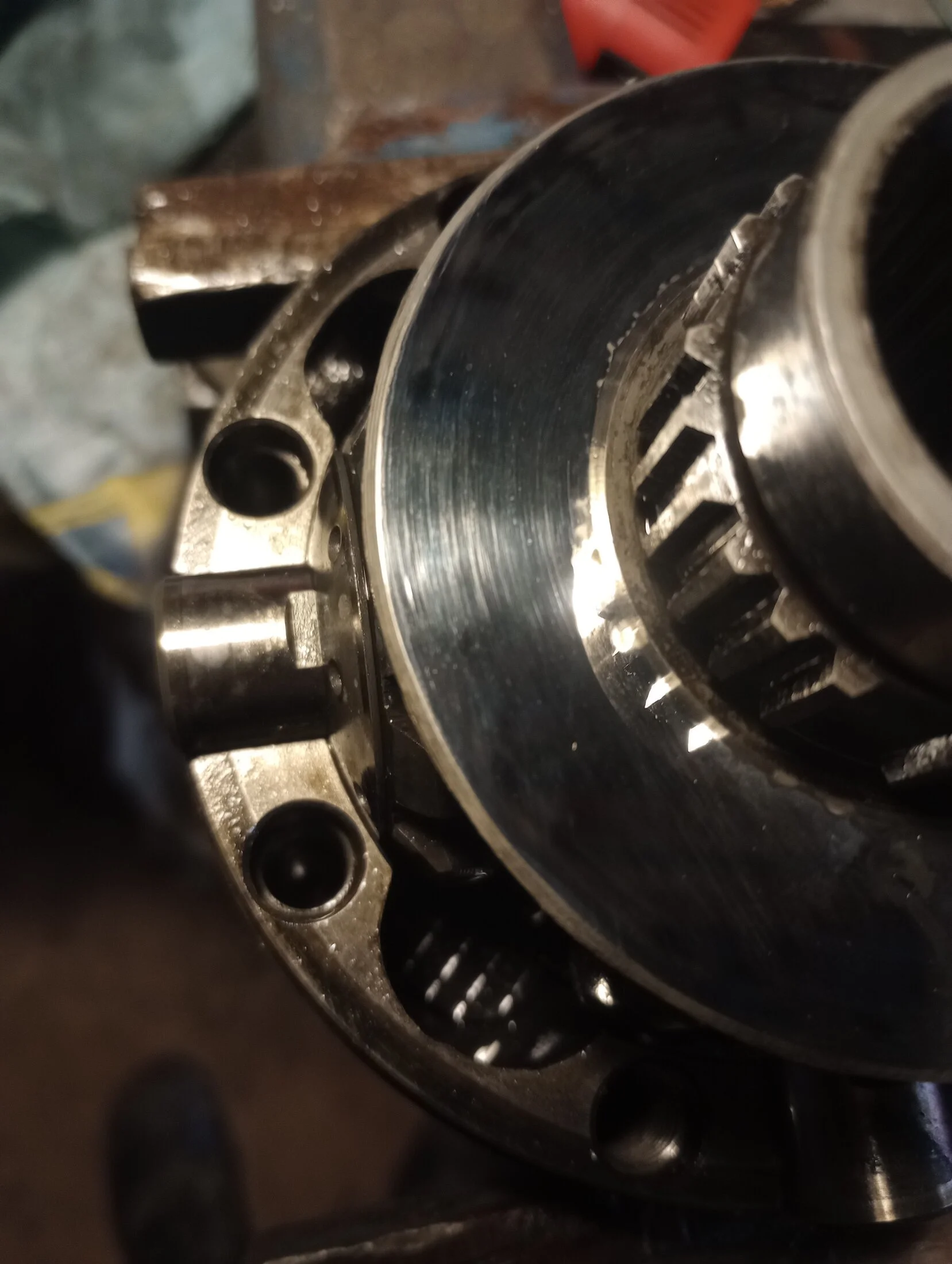

The clutch plates doesn't look too bad to me.
Measuring the whole stack makes them look very bad though. According to the manual I'd need over 2mm of shims. My options are:

That friction disc looks very bad, it is scored (oil contamination) and looks glazed. They should have a dark grey coating, any signs of bare metal mean worn out to me. I think the minimum Toyota spec of 1.76 mm or whatever it is in the FSM is nonsense, as it would leave a huge thickness well beyond the thickest factory shim disc.
What do the clutch discs look like?

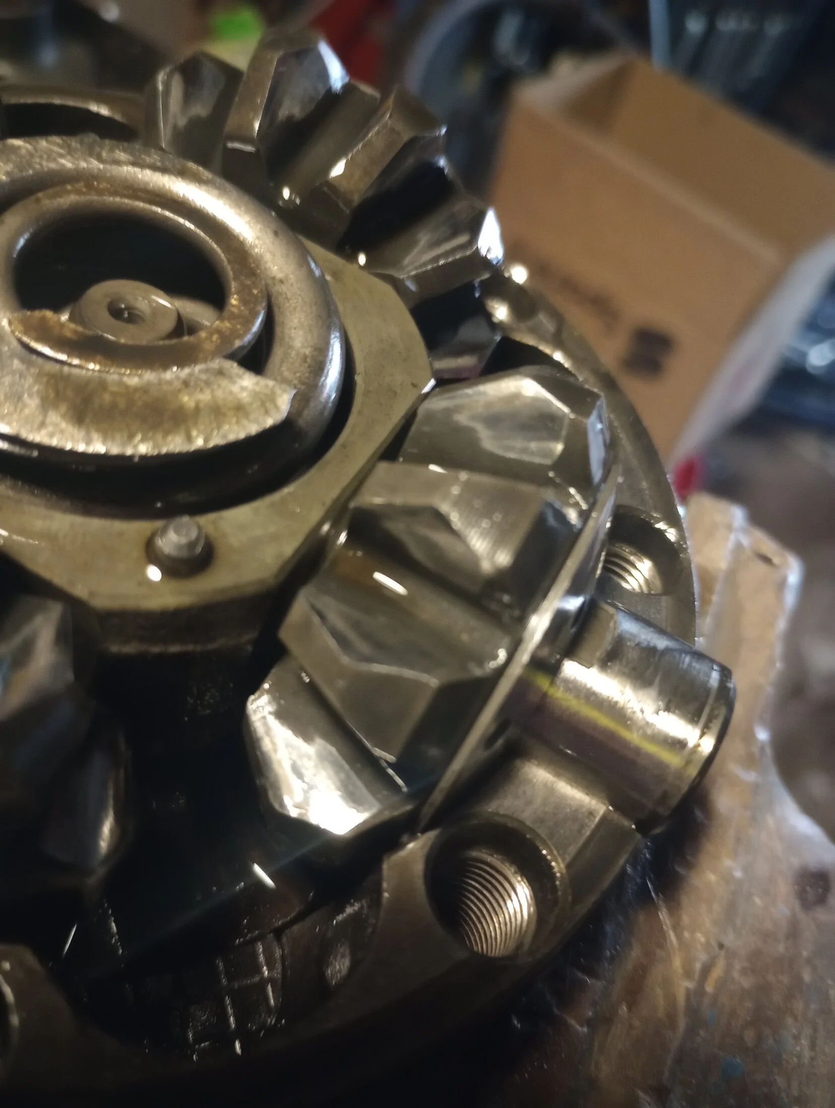

What's the wear like on the diff siide gears and spider gears? With that much wear on the discs, the spider gear backlash must have been way out.
I think all your friction discs and clutch discs are for the scrap bin unfortunately. I've never seen them that bad.
Spider gears look worn but OK. Check the back side of the side gears (the ones which engage with the half-dhaft splines) as that is also a friction surface.
