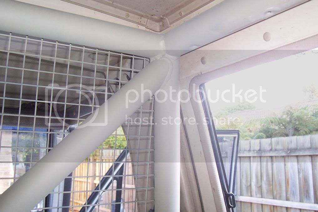

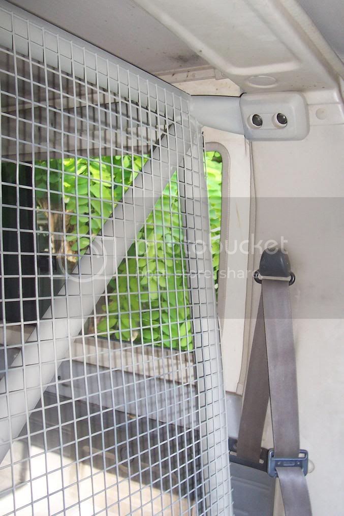

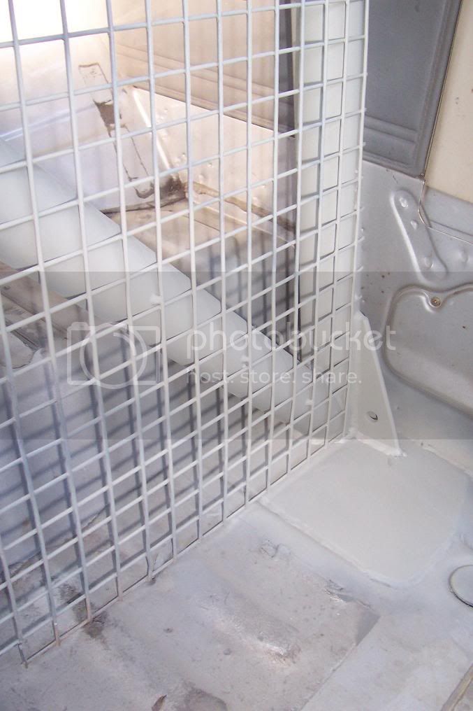

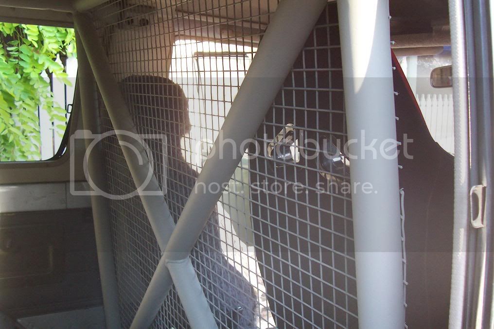

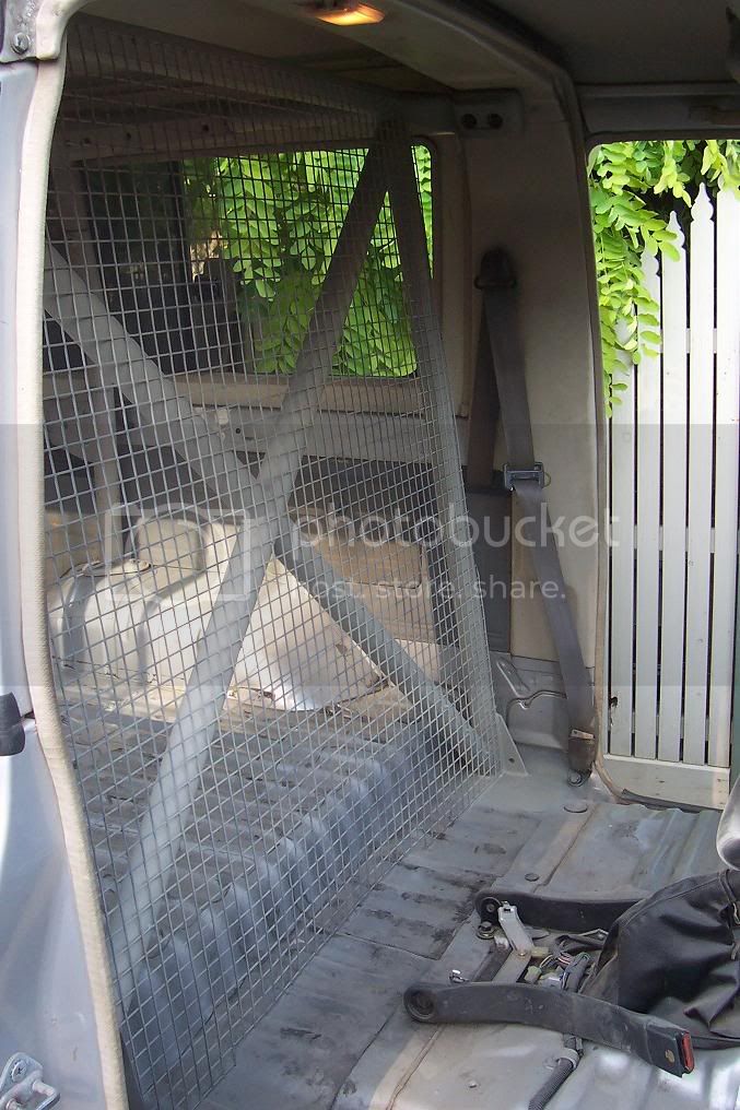

Which is why I did this
Nice.
Is the rear hoop factory? it sort of has that appearance. MY JDM has nothing in the rear cargo area and no evidence that there ever was anything back there. Not even rear seat belts.
Got it.
Not many of those on this side of the pond I imagine......I'll have to make something.

Thank you, just what I was looking for. My Spanish BJ 73 has the same OEM rollover tube, with lateral supports, padded head-bangers, grab bars, etc.
Will likely not reinstall the rear seat, in favor of clear span for hauling dogs, garbage, groceries (not concurrently) so will have the opportunity to upgrade the cage - you have given great start for ideas.
