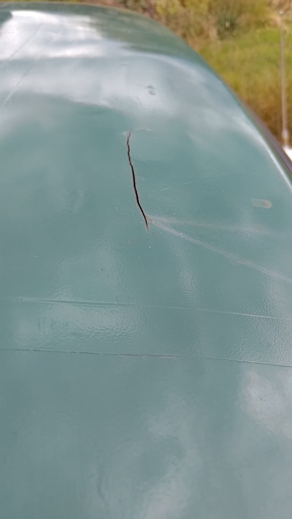

yesterday i finally ripped the band-aid off and tackled the roof repair. i spent from about 11am to 5pm removing material around the cracks back to bare metal, before prepping, and getting body filler, primer and high build primer down. i sanded back paint until i couldnt see the filler lifting from the metal any more. this meant the crack around the windscreen, while about 10cm long on the surface, had lifted filler from the center almost to the edge of the roof. i used rust convertor on all the rusty metal, scuffed it up with 40grit then put down some fibreglass body filler. i got a cheese grater to it before it set hard and got all the high spots knocked down. next came normal body filler and sanding down finishing at 180grit.
I had stuff to do today so inbetween horse float duties i rubbed the high build primer back, working up to 600grit and trying to feather the masked edges. once home for the day another hr or two to put down a few coats of color.

it is far from good, but sealed and should protect the metal underneath. itll be interesting to see if the crack at the front reappears for a 3rd time after using fibreglass filler.. once again its not a show car and just needs to be better than a rattle can paint job for me to be happy..
