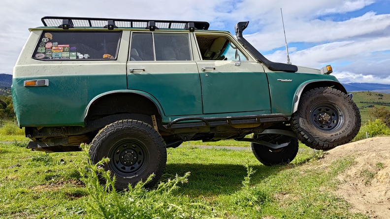

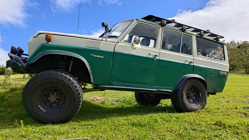

Got out on Sunday to Swanston Track for a day wheel.. Had the dog and 2 kids with me and went with one other car (dual cab hilux)...
i.php
I tried the go pro again but only turned it on at the start of the track - forgot to press record!
i.php
Stopped here for lunch
i.php
Then figured out the go pro by pressing the button..
i.php
i.php
Spent about $30 at the car wash trying to clean it... I really don't enjoy mud but its hard to avoid down here..

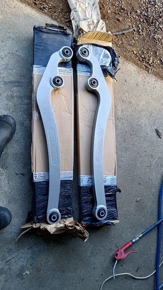

Got some adjustable lower arms to better adjust the rear wheels in the wheel arch..
Not long after installing these I developed a sound in the rear end... which turned out to be a munched pinion bearing! I first thought that bashing the exhaust with the pinion flange did it, but when i went to reinstall the rear driveshaft I found i couldn't compress it past the static length. It seems that the power of the 15BFT was enough to twist the rear drive shaft and stop it compressing. Combined with pulling the rear diff forward on the control arms it put too much pressure on the outer pinion bearing which flogged out the seal and caused diff oil to go everywhere. I also found the driveshaft yoke had cracked.

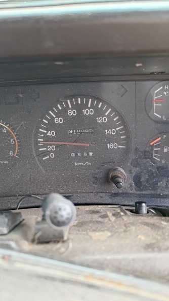

Cracked 310000kms! 20k kms since registration!
