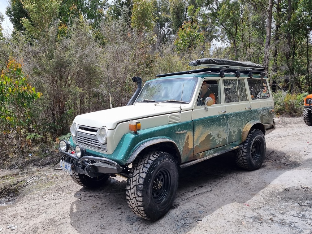

So I joined a 4wd club( No Limits 4wd Club) to experience a few more of Tasmania's 4wd tracks with those that know them about mid year now the pig is on the road and this is the first chance I've had to go out with most of the folks in the club for a weekend and it was pretty good.. on the way there I took Jefferys Track which I've done before but not on my own.. it is starting to get chewed up a bit and I think I had my shocks still too firm as we got thrown around a bit.

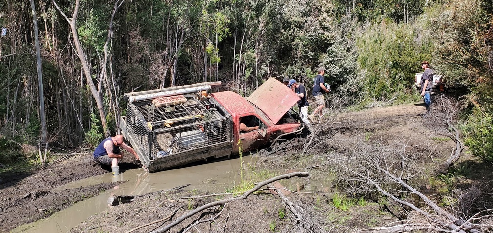

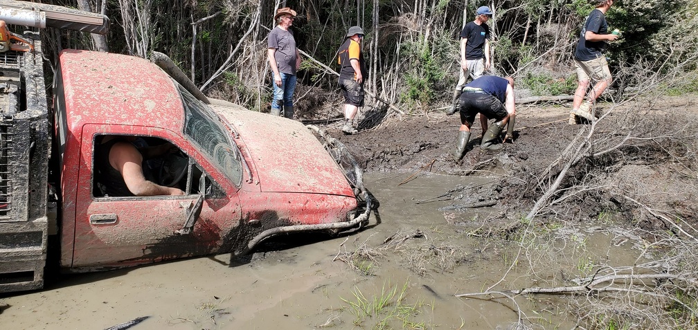

The paddocks are just a collection of rutted out tracks across muddy open sections and through forests, the mud is sand/silt based and it doesnt take much to swallow small tyred rigs. People go out there heaps in 37"+ tyres and tear the place up, which is why we struggled so much on 33s and 35" tyres.. a few of the bigger 80serise on 35 treps got stuck and there was some waiting around so after 5-6hrs of this we were all keen to find our way out.. but that wasn't as easy cos even a few hundred meter stretch to the road was in huge ruts. On our way back to camp we stopped in a river and tried to clean up the cars as much as possible.. as both sides and inside were covered with mud..
The pig did really well. .it copped some hard hits falling into ruts on the chassis, rear towbar and my 80mm extended rear bump stops but did really well not to fall apart. The winch got a solid workout too for self recoveries and helping others out.. all in all it was a good day's wheeling and the pig surprised me with its capability... I think it might of surprised others too..

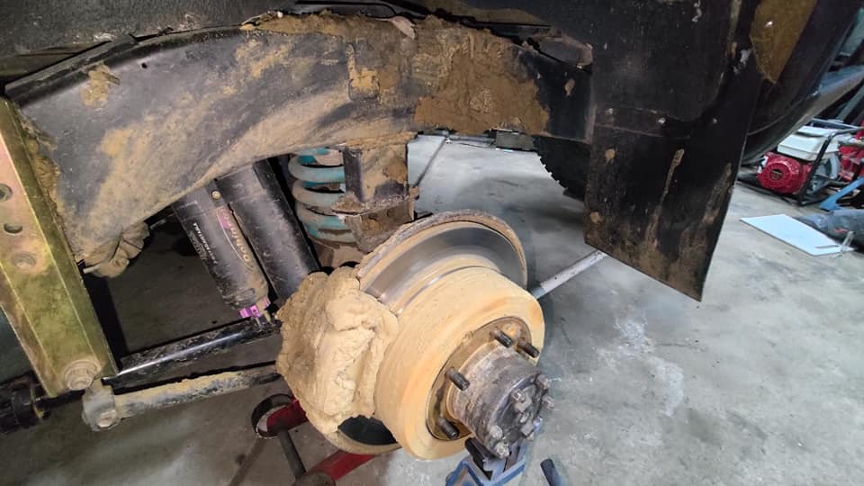

My handbrake was shot after all the mud and i noticed my rear brakes werent working very well either.. Before leaving i tried to put new pads in the rear but the piston on one side was siezed so last night I pulled it all down and rebuilt both calipers with fresh pads, clyinders and rubber seals, then adjusted the handbrake.. The mud was left over after about 1hr and $40 at the car wash with the pressure washer..

Now I have a working handbrake again and can lock up the brakes without much effort..
