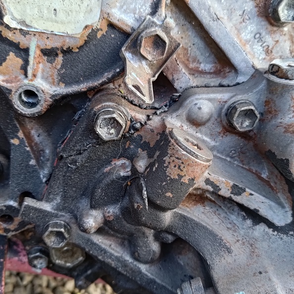

Wow, that is some carnage. Maybe have someone rebuild it?
It was rebuilt 6 months ago... 2nd hand input shaft as toyota have stopped making B series input shafts..
Might have found another input shaft in Melbourne so following up that lead. There are two different sorts. MY OG box was late model, the spare was early model and was what was used for the rebuild. The input shaft I found is for a later model so need to quiz the rebuilder of he'll sell me my old, late model, input shaft bearing retainer plate..
That's wrong. Later model had oiler ears on the bearing retainers.. which is what mine has. So the input is for the earlier gearbox and retainer...

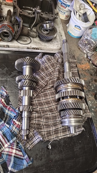

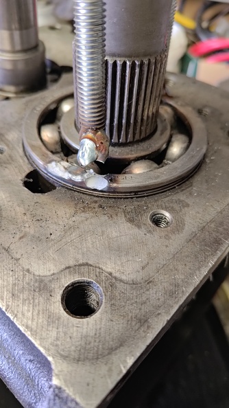

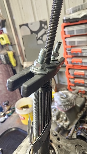

And started to pull my gearbox down. I needed to remove the center output bearing to get the mainshaft and counter shafts out.. which proved to be difficult. I tried to make many different pullers but none seemed to work:
I resorted to a 50mm cut off wheel to cut the bearing out..
The counter shaft was undamaged so it went back in once I'd sorted some fresh bearings

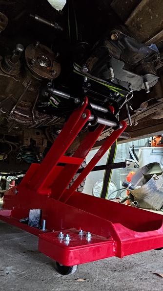

And installed it with my new transmission floor jack! What an awesome bit of kit!

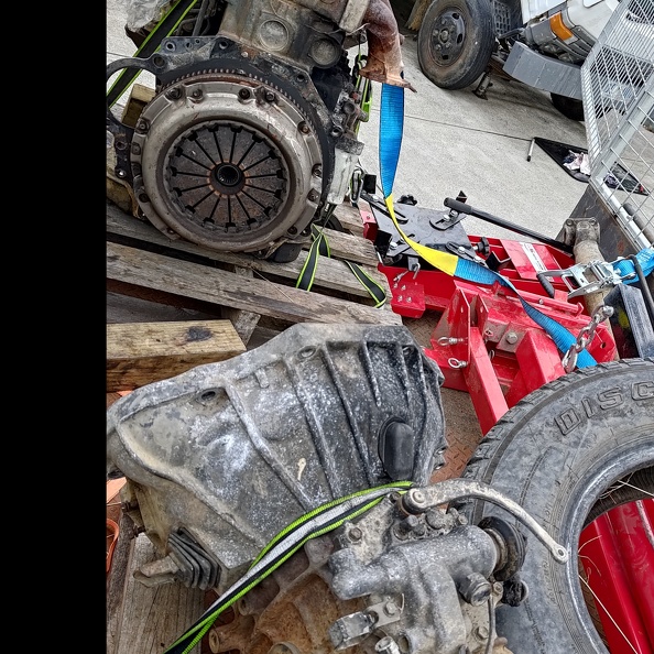

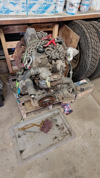

First off I found a mate selling a Dyna 300 with 14B locally for cheap! Like $3500 cheap. I'd seen 14B's advertised on the mainland for $4000+.. and had a mate in Melbourne who wanted a 14B for his BJ42... so snapped it up. This got me the bellhousing I needed and meant I might be able to break even with the sale... It took a few weekends to get organized but got the engine and gearbox out, and home...

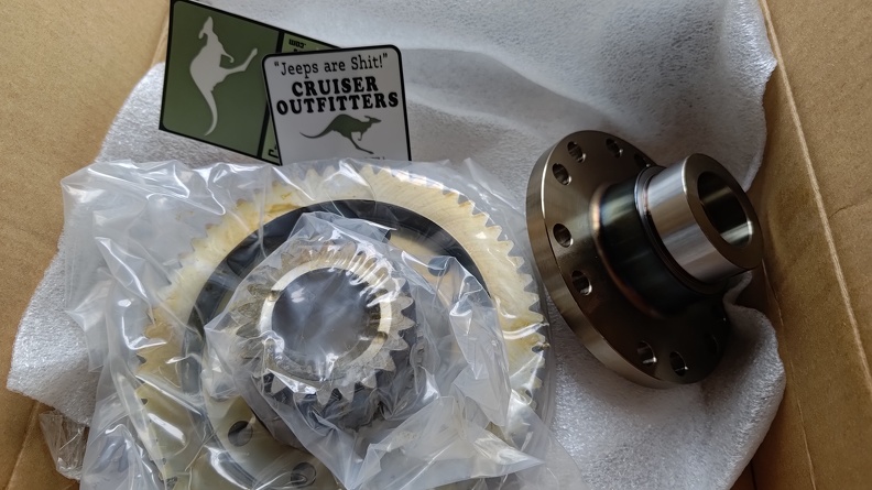

I wanted reduction gears but they are only available in the 80/100's full time transfer so ended up getting some 3.11:1 Trailgear gears from @cruiseroutfit again...
I also got a part time kit to throw in as well.

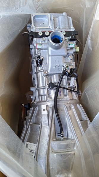

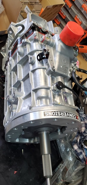

With the transfer case bits mostly sorted it was time to move onto the gearbox. The late model H152 meant I could run 35's and 4.11's in the diffs and see just over 2000RPM at 110KPH. This would be great cos I had wondered if the 3.7's had contributed to the issues I had with the gearbox in the first place.. I checked with Toyota and they had plenty of gearboxes in stock in Melbourne so placed the order and paid up front. The brand new gearbox cost me $3850 including tax and was ready to pick up the next week. Keep in mind when I sent my H55F to get rebuilt I had to buy a spare gearbox with input shaft for $500, and the rebuild cost me $3000.. so a new gearbox is pretty comparable.

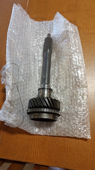

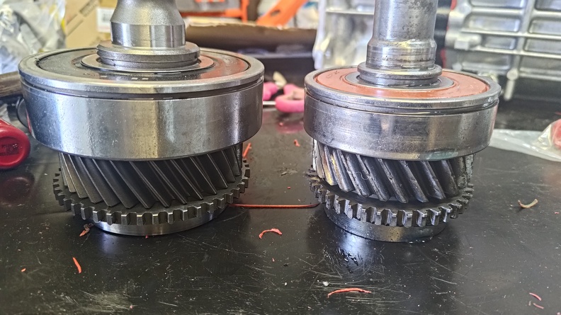

Next I needed all the bits to make the H152 work with the Dyna bellhousing and my 21spline clutch... So I needed a 1HZ input shaft and bearing retainer modded from 38mm down to 34.9mm to suit the Dyna clutch bearing:

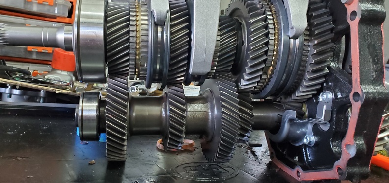

Here we have the old B seriers input on the right and the 1hz input on the left (actually its the VDJ input but the bit you see here is the same)

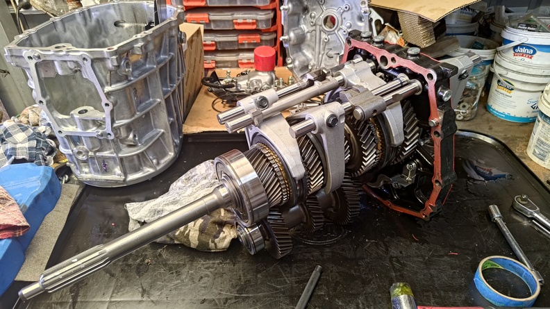

So after dropping a heap of coin on a brand new gearbox I had to tear it down to replace input shafts.
You can see here how long the VDJ input is..
I thought I needed to pull off the 5th gear to replace the input but learnt a trick to swap it out otherwise
HEre it is with the new shorter input in place:
So back together it all went.

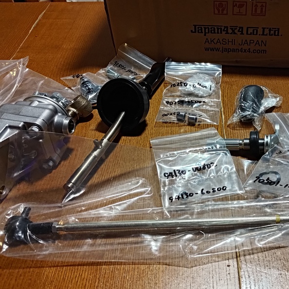

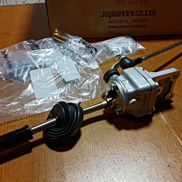

I was waiting on an input shaft for ages as they were all ex-Japan. I got onto Japan4x4 and ordered it with a heap of other bits I thought I needed. The next challenge was 4wd shifter. The 80 has 4wd shifters further rearward than the 5 speed shifter so that wouldn't work for me. I ordered a VDJ shifter in bits and ended up with something like this:
With all the bits mocked up I could work out some lengths

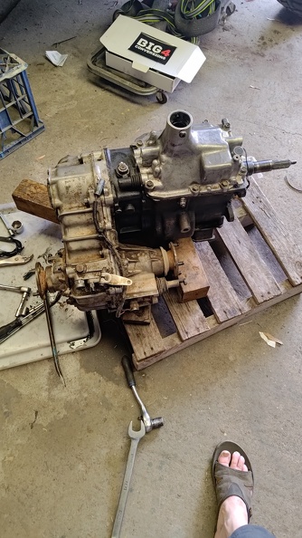

I measured my current drive shafts then dropped my H55F for the last time..

The input bearing of the new transmission looks much bigger than the one from the old transmission. Maybe that will be a difference maker?
Not just the bearing size is bigger.. the gear itself too
