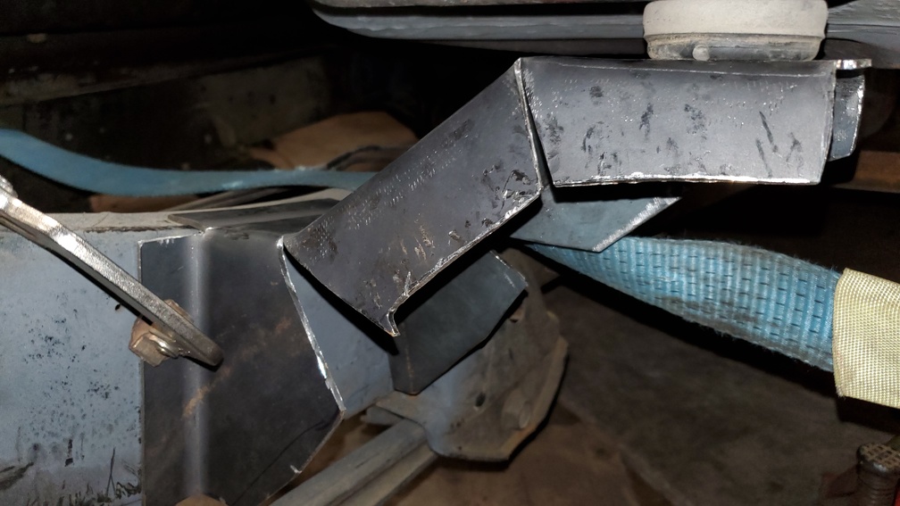

yeh thanks! It's the first time i've used the brake press on 3mm sheet and it came out alright..

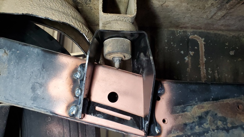

Another set of body mounts fabbed, painted and tacked to the chassis
Yeh i need to shorten the bolts a tiny bit. Using FJ55 body mount rubbers.

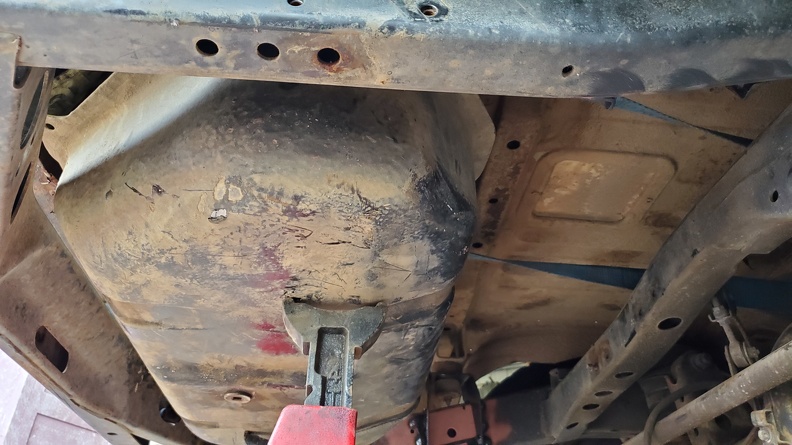

Test fit the BJ73 90L diesel tank..
Plenty of room.. I also have a large truck air tank I want to run (along with a 2nd battery) in the space in front of the tank. The tank out the rear also suits the body supports to mount the straps onto for the tank.

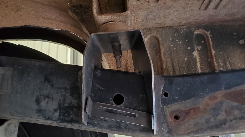

Today I got about an hour on the creeper doing some CAD work for the next set of mounts. I managed to get them cut out just before dinner and this evening got them pretty much in formed up..

I'll probably have to drill a hole to get the brake lines through.. still figuring it out.

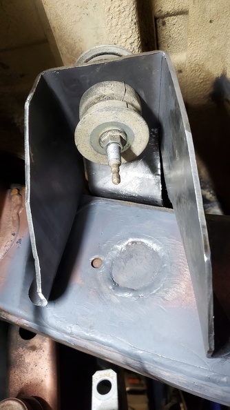

Got the rear most body mounts fabbed, painted and tacked onto the chassis,, rubbers are tightened up.

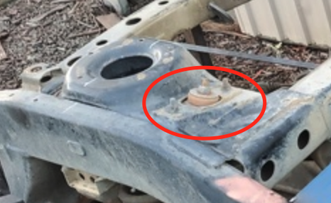

I basically cut the top off the rear most 80 body mounts so i could use the rubber and fabbed a new lower section that kinda outboarded the body mount..
