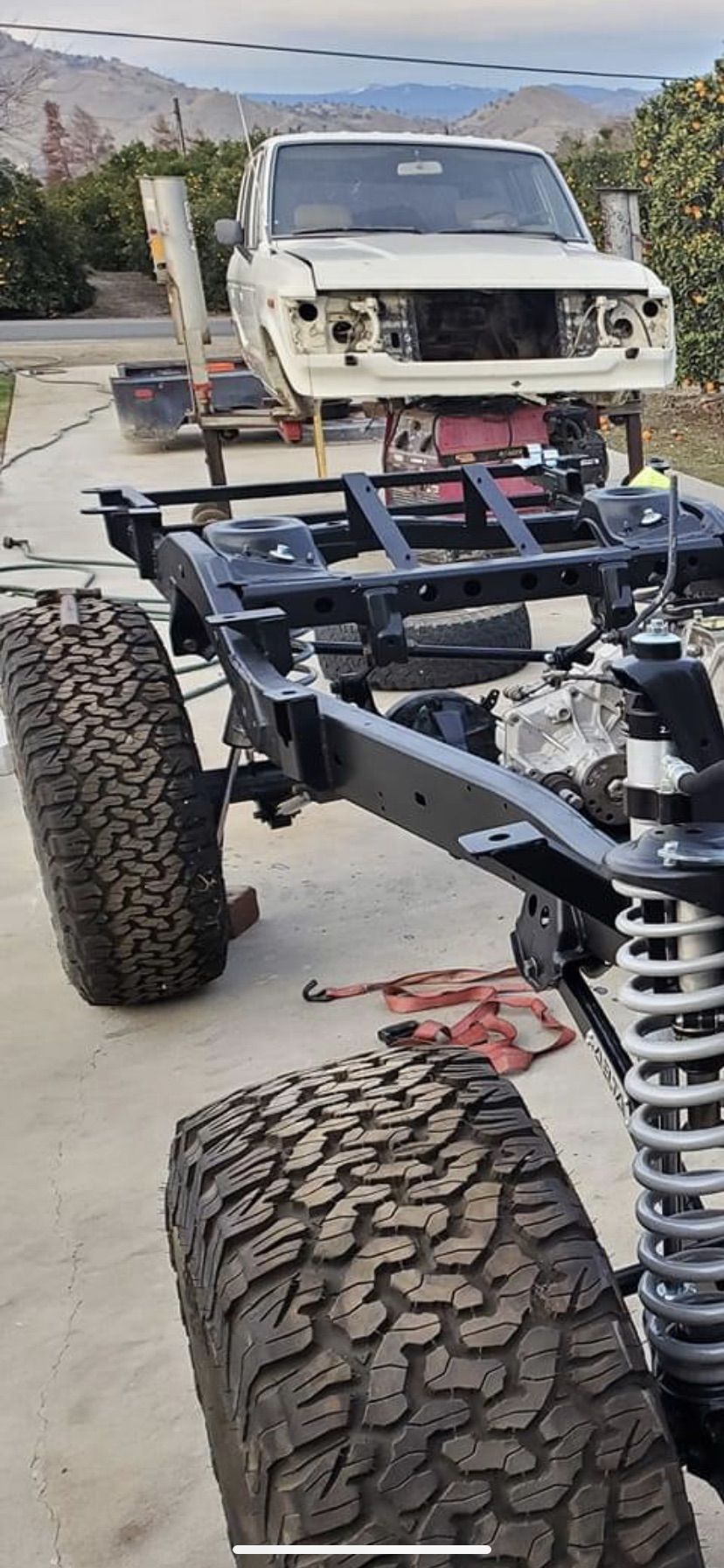

did some more work positioning the body on the chassis tonight.. this time with the front end attached..
I've tried to compress the rear end using a ratchet strap but might need to get desired ride height by removing springs and using jack stands..
Removed the shocks and springs and sat the chassis on jack stands.. still yet to adjust the body though

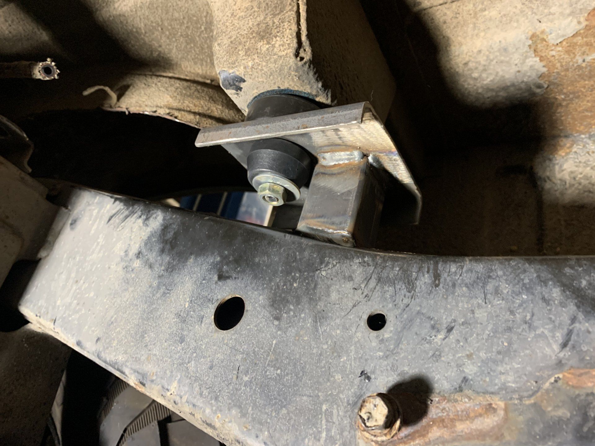

I think ive got all the body mounts sorted in my head using existing holes. Ive got 1 extra set due to the bj73 floor.. i reckon i can mod the body mounts to work on those that sit above the chassis rail.. the bj73 chassis is still providing.
80 mounts and rubbers
Front bj73 mounts will work on the mounts behind the rear wheel well tgat sit over the chassis rail..
Factory mount measure at 2mm steel.. so i should be fine to mod them with 3mm..

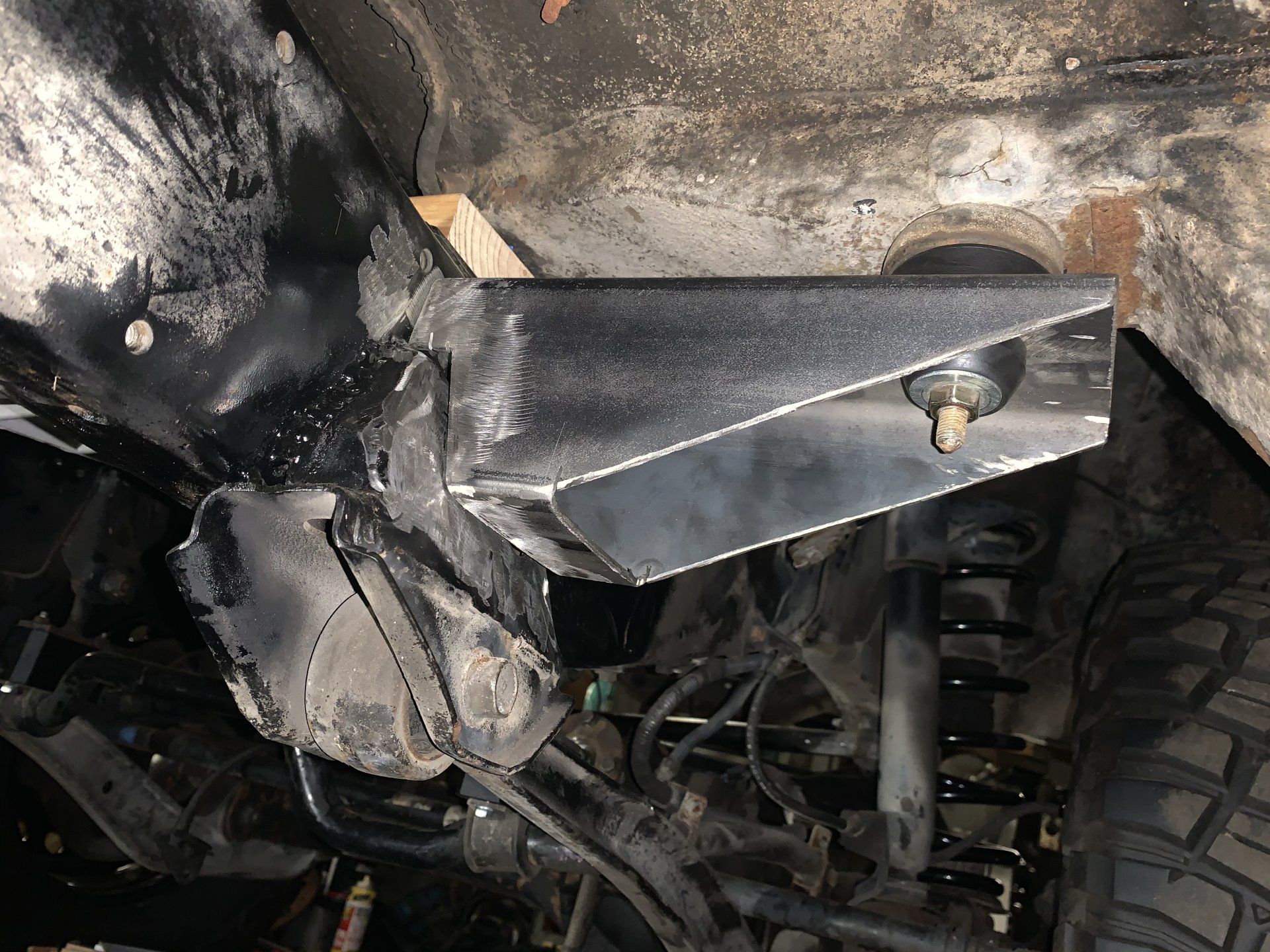

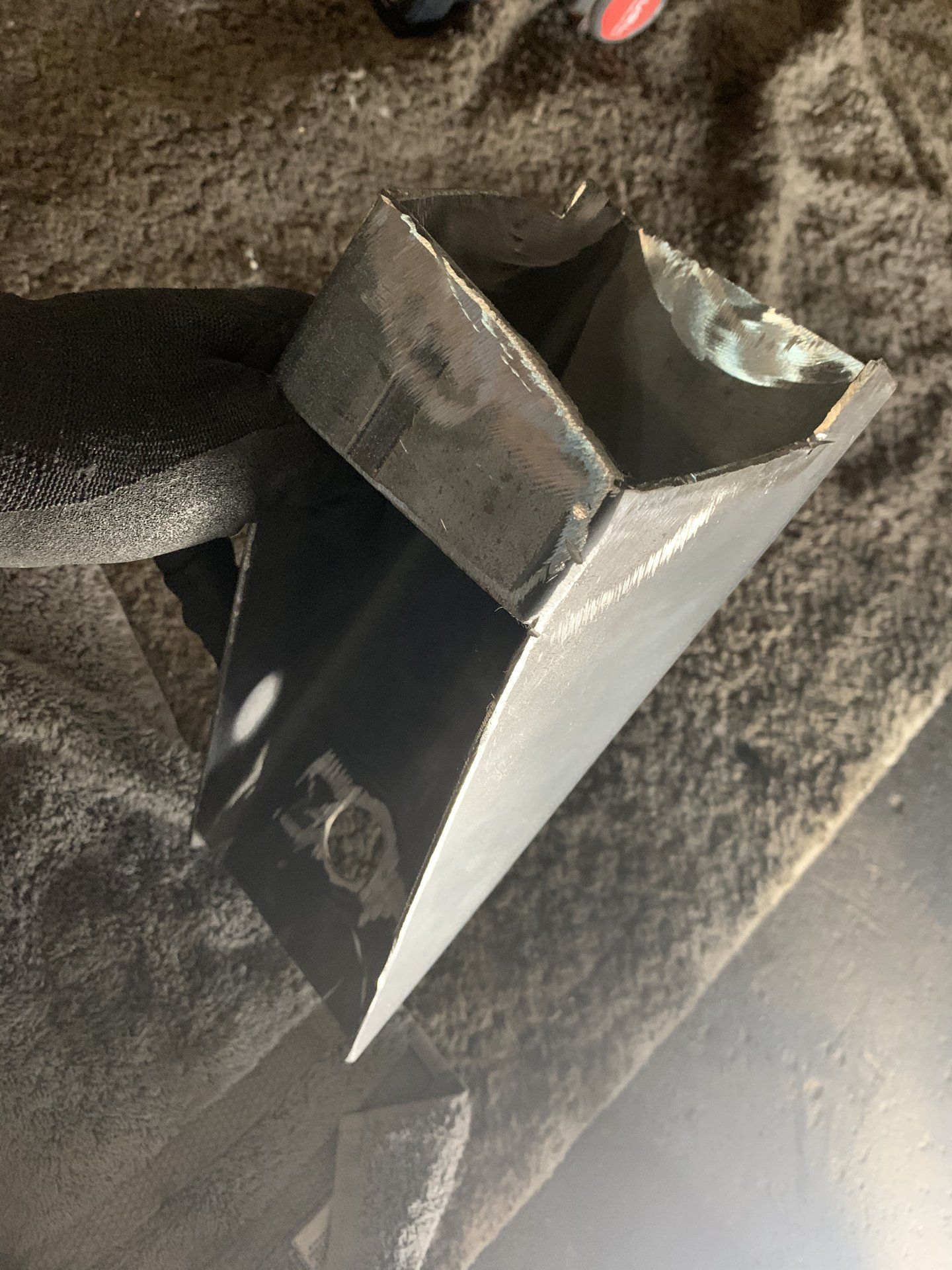

Got the rear most body mounts fabbed, painted and tacked onto the chassis,, rubbers are tightened up.
I basically cut the top off the rear most 80 body mounts so i could use the rubber and fabbed a new lower section that kinda outboarded the body mount..
