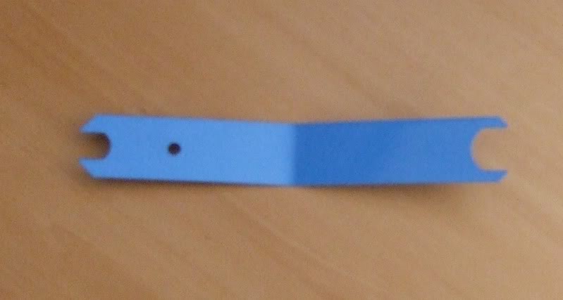

Removing the trims are best done with a $5 tool available from any parts shop.Its hard to explain ,but you need to get the right size tool and lever the plug out of its hole.
To do this you must get the tool between the plug and the .door
If the tool goes between the trim and the plug ,you lever the plug off the trim and its non repairable.
I use one like this from supercheap.It will also remove the circlips holding the window winder on
To remove the door opening lever,you remove the screw and slide the plastic bit backwards 10mm

Many thanks for the reply, off to super cheap now to get that tool as it is exactly what I require.
