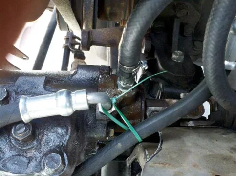

Well the pressure line on the gear box is sticking out a bit but it wont tighten down anymore.

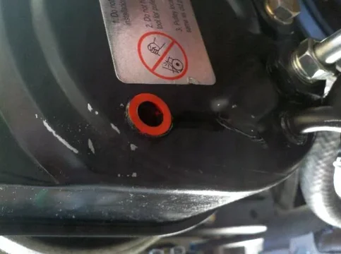

On the back of the pump theres that little plastic plug it looks like it may be comming from there. Not exactly sure. I will take some pics

Leaking at plastic tab. I guess just take it out and put a bolt in there?
Leaking from the gear box at the low pressure side. Tighten clam will see how that works.
