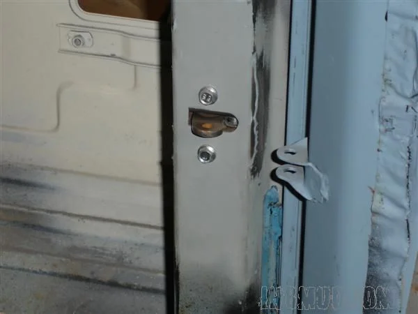

Door Stops.......
The later door stops are easily installed by elongating the pillar post hole and drill 2 small ones for the mounting..........
Whats a easy fix for the striker issue?
