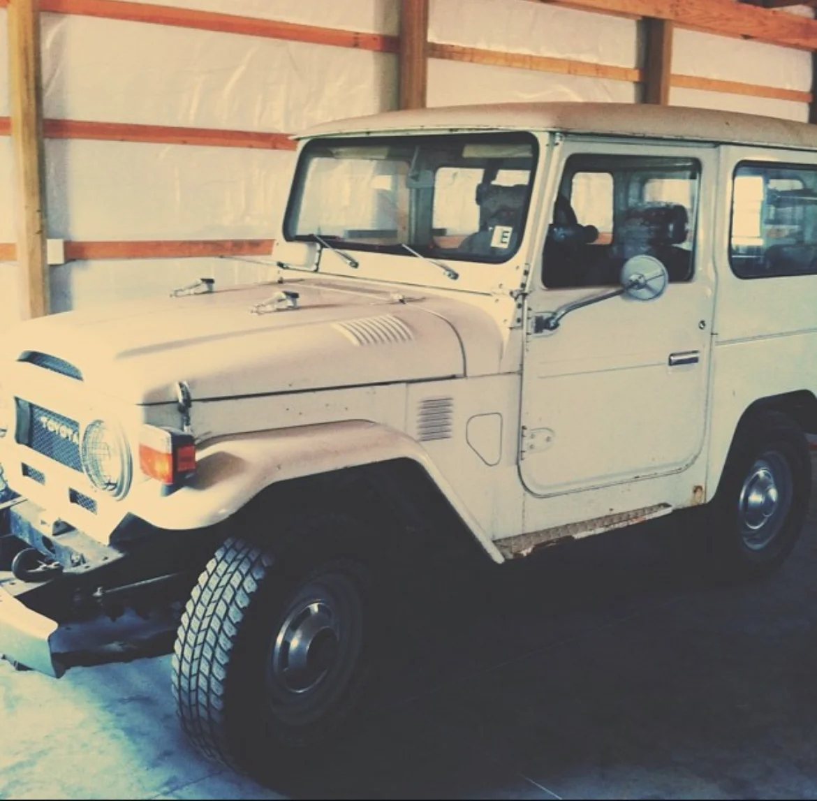

I’m checking in on a 40 this weekend and wonder what I should check while im there. Im gonna see if it starts well. And then go from there. Look for rotten lines? I think it has an inline 4 maybe? Anyway that’s what going on. Father in law doesn’t move too well and hasn’t started or moved the 76 in a couple of years. It’s stored in a Morton building with a concrete floor. There are barn cats that knock down the mice real hard but stay out of the truck. It’s all original as far I know from checking in on it a couple of times a year. I haven’t dicked with it because it was grandpa’s. There has been some worry about grandpas other kids trying to get the truck so it has been put in grandmas name and is now for all intents and purposes, mine. Im going out there this weekend to look it over and replace the accelerator pump on my Bronco that’s also out there. Any tips are appreciated and will post in real time while I’m there. Thanks! Also, I looked for similar threads, if there’s one that you recommend, please link.
This is the only photo I have.

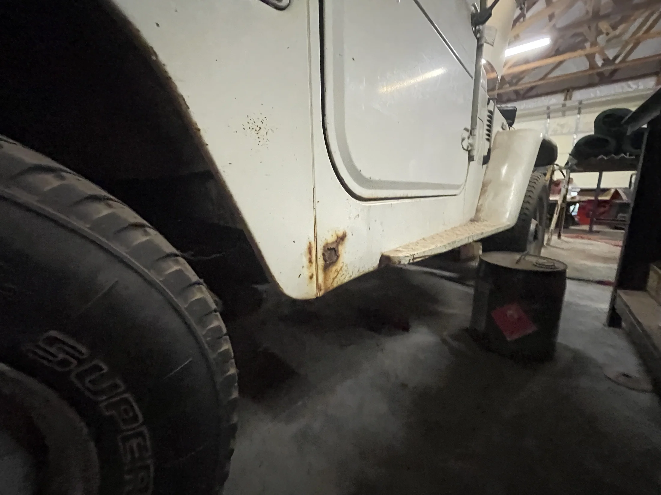

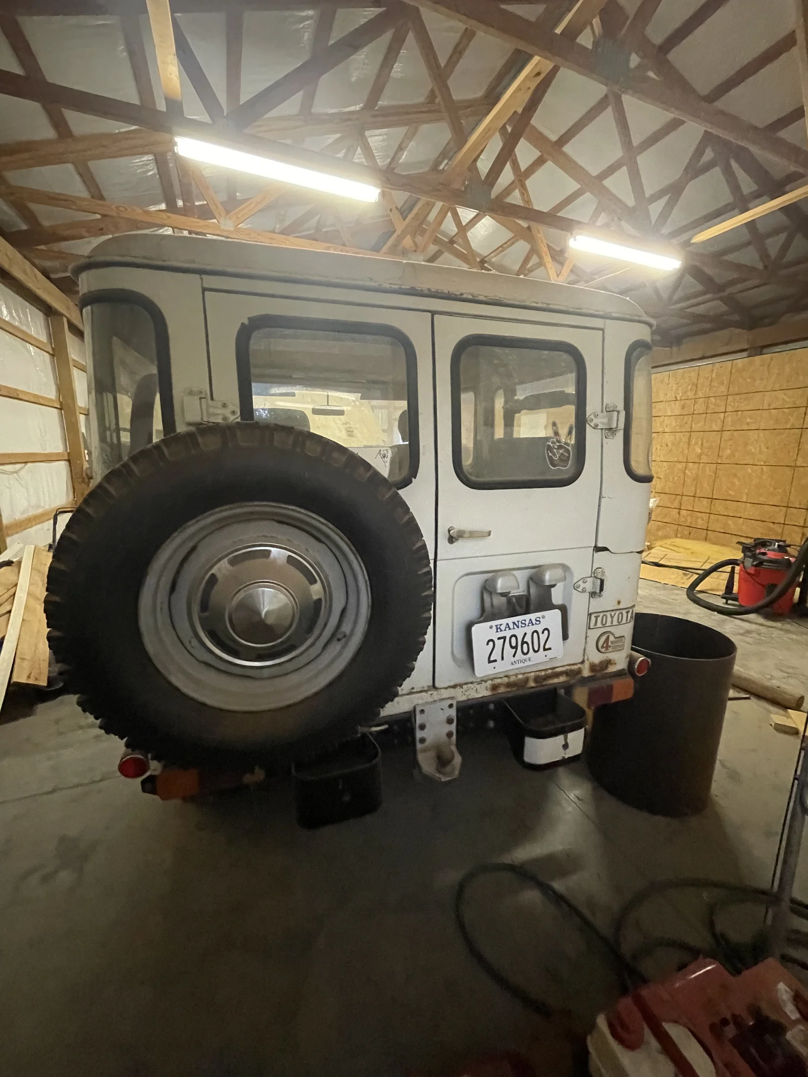

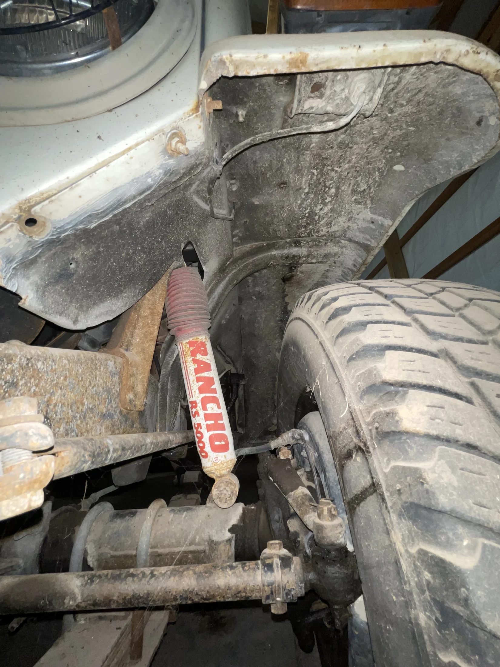

Alright. Definitely the six. I think it was in NM, then Boulder and now here in Kansas. Some rust on the passenger side, but for the most part it looks pretty good. I’ll add some photos and I can take more if there are questions about things to look at. Thanks! The battery seems to be on a maintainer at all times, for at least a year.
Pumping fresh grease into all the grease nipples around the steering and suspension is a good place to start.
