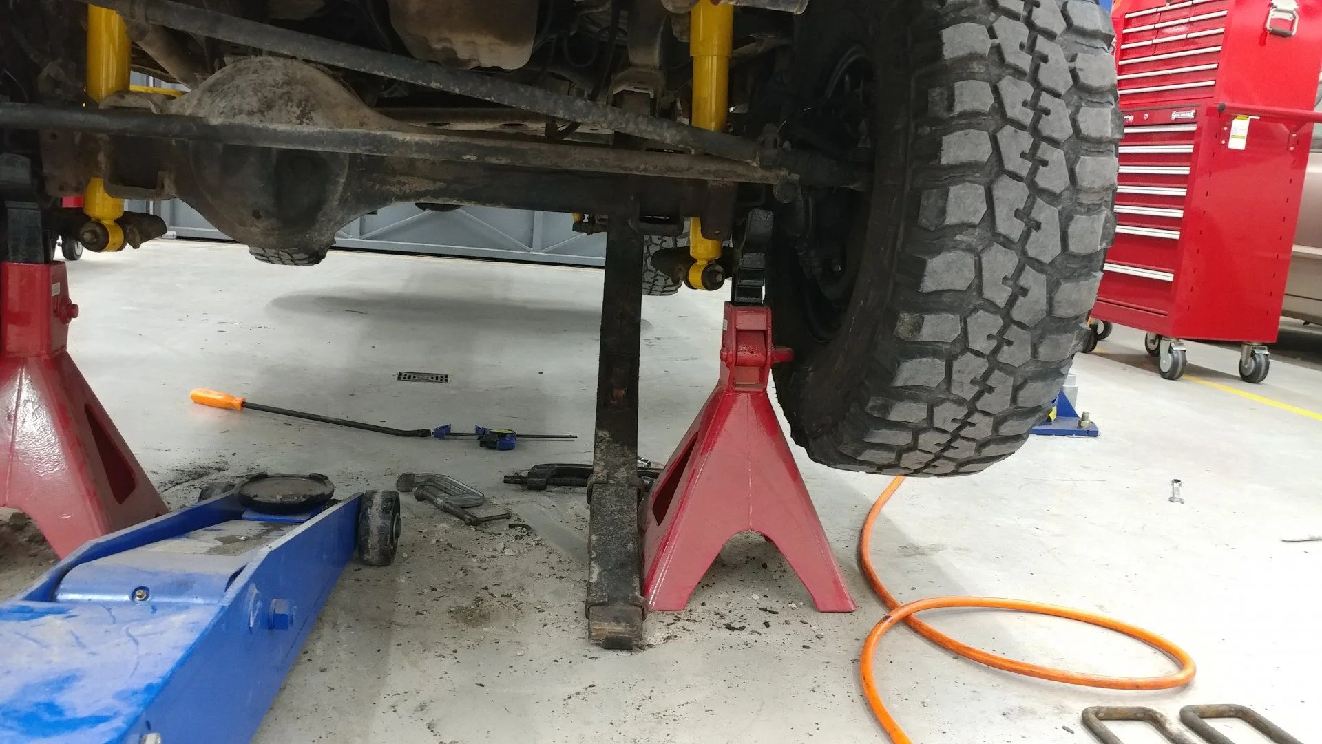

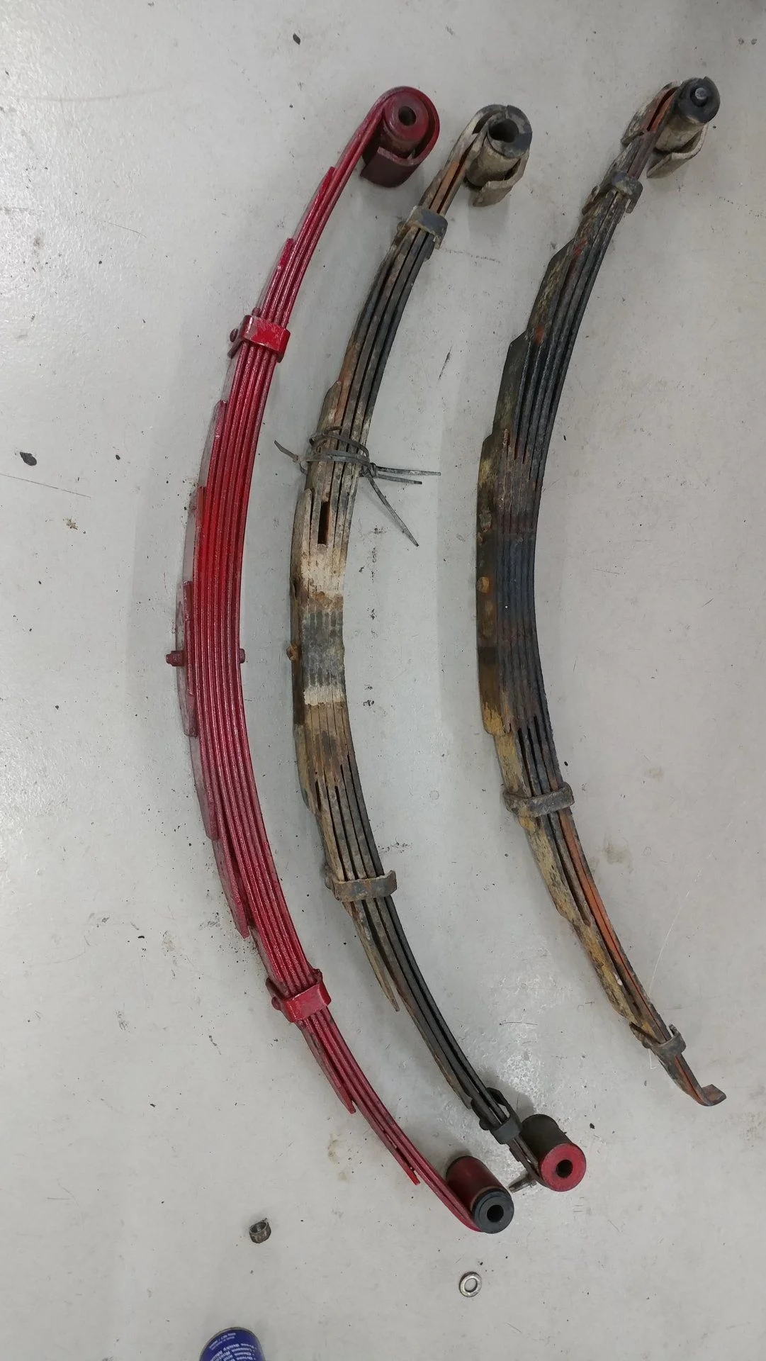

I've read your thread some time over the past year and it's been great to see what some people are doing with these cars, I actually have 60 series rear springs on the front of mine at the moment due to the front springs snapping (very dangerous but the military wrap at the front saved it, I actually drove on it for a while without realising it was broken before a rego check where they said the bushing were cracked, I lifted the front end on a hoist and what do you know the diff stayed in place, saved me a lot of money at the time, $50 at a wrecker compared to $600 new, just picked up some front parabolics that I'll be installing soon though).
