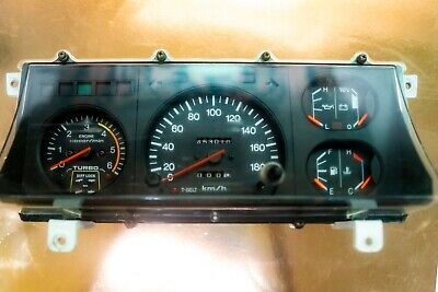

Started tearing into the tachometer question... @c2dfj45 these look very different in size.....
Before I try to do the swap, I hooked up the 80 Series tach to the same wires and it worked great
Going to need more information from Chris to figure out how to do this. Drastically different mounts size, etc.
I'm not sure I can answer all of them....maybe @TaylorDurdan can since he took it all apart. I *think* we used the 1FZ guts on the 70 series tach face so it all fit. The needle from the 1FZ was cut down since the shaft was different from the 70 series shaft and needle. I remember Taylor showing me the glue that was used as ballast for the needle(to weigh it down). The rest of it is something he has to answer. There were spacers and all kinds of stuff.
looking at the boards, mine is much different than the 80 and different than both of yours, mine has three screws in a row that are the three wire connections while the 80 has them at opposite corners.
@joekatana got any ideas.
Who else would have an extra cluster laying around?
I have been looking at signal converters for tach's. I need more info before I can head down this road. Does anyone know what type of signals the 1fz-f and the 1fz-fe use?
