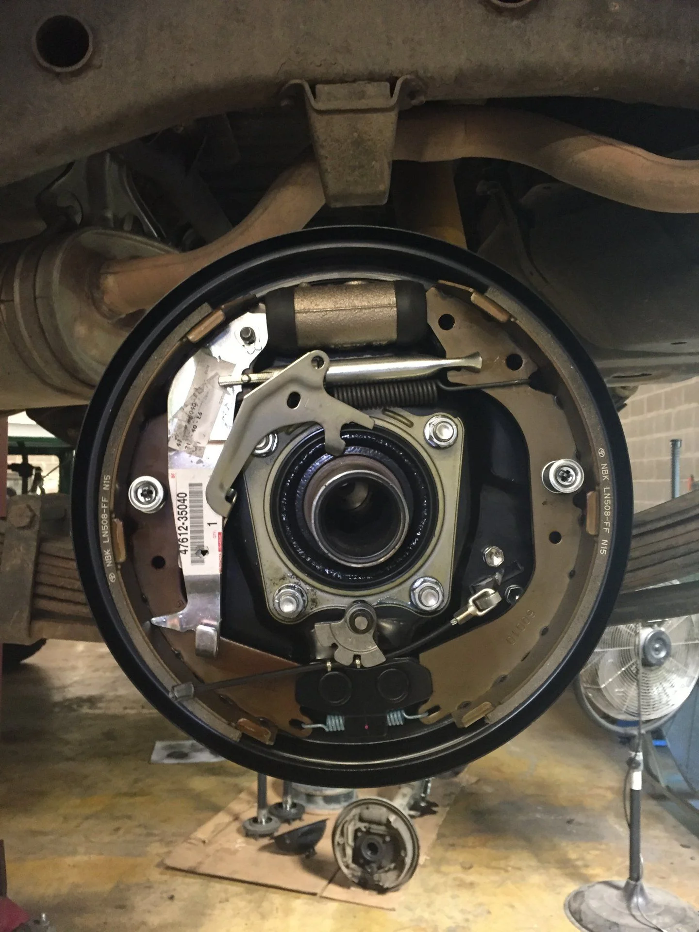

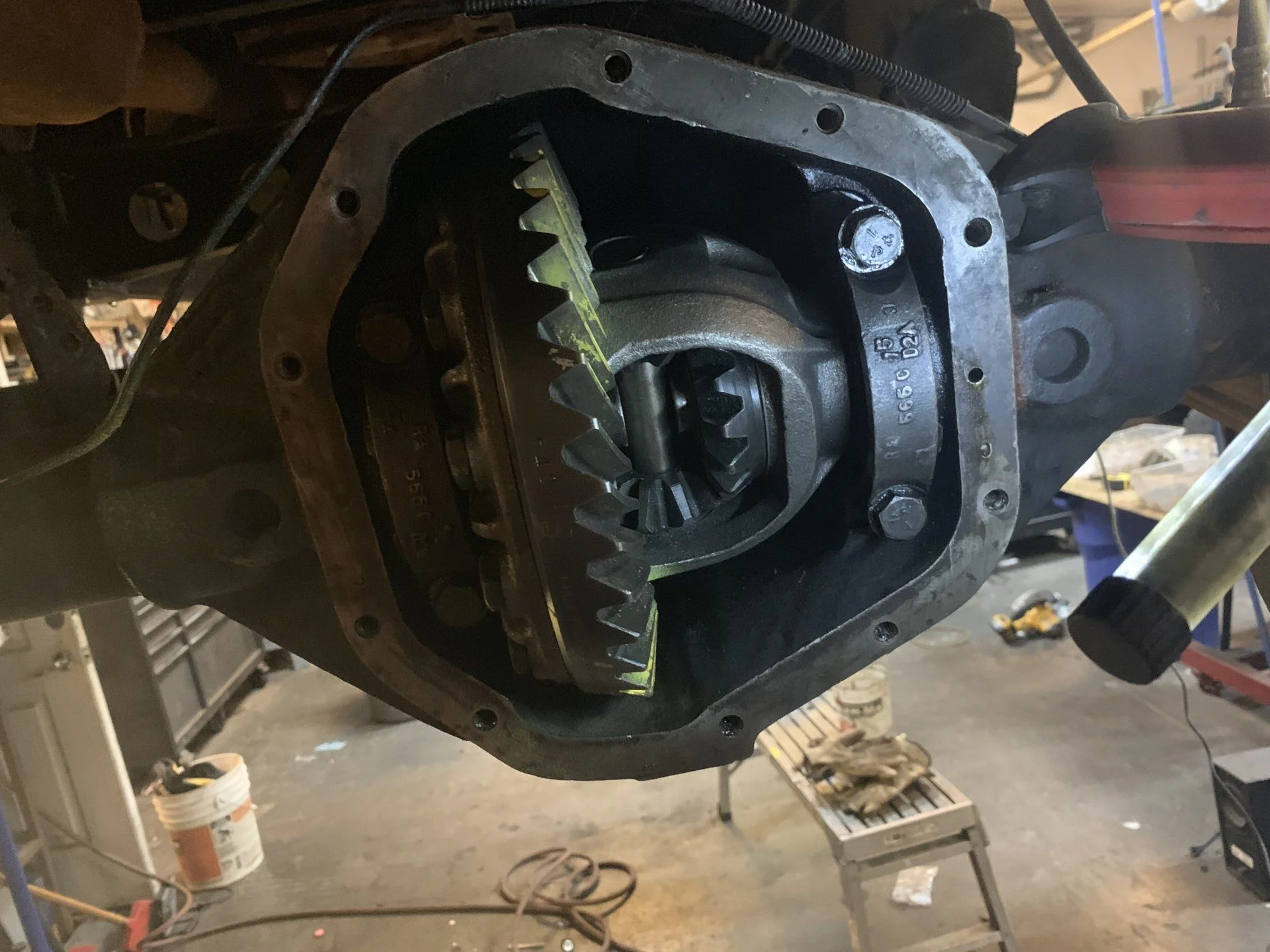

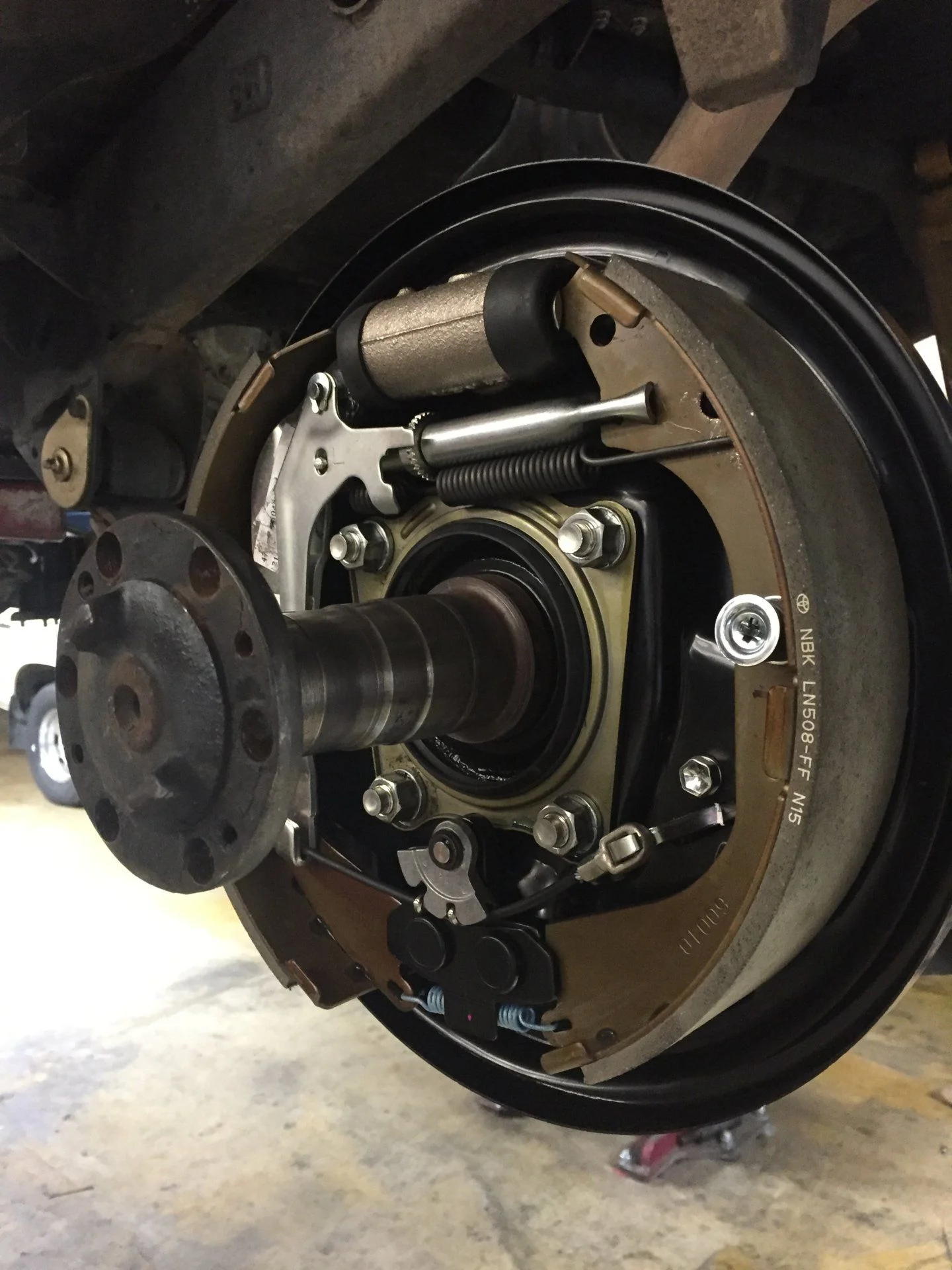

Really nice few hours of work last night, got the rear differential all put back together after moving one shim and trying seven different shim combinations for the pinion...

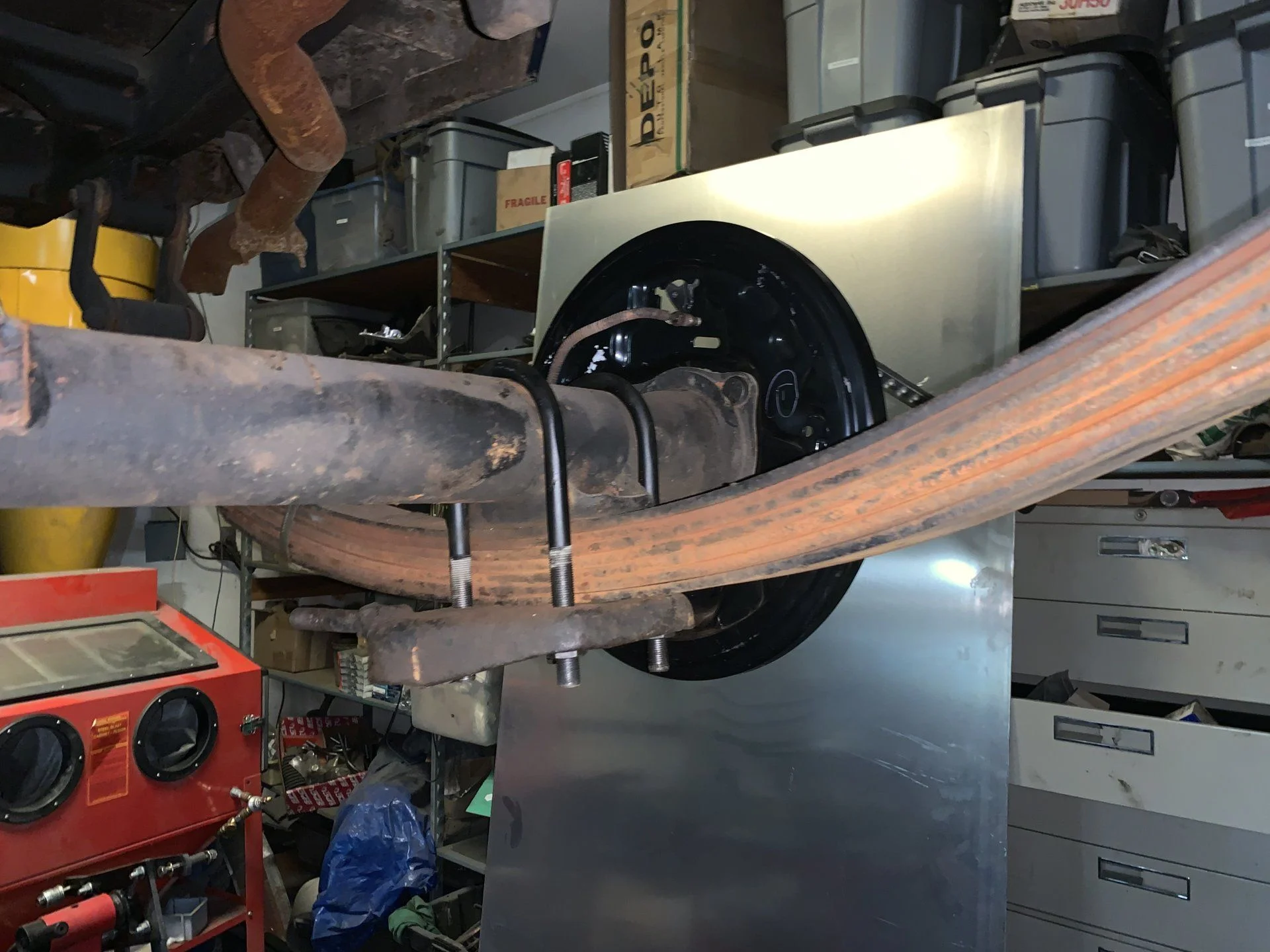

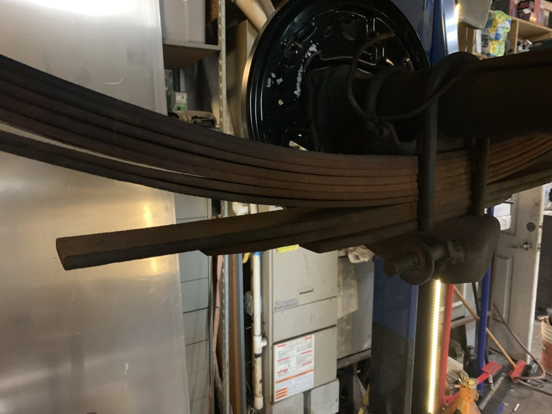

got the rear helper springs out and found a little issue

Thanks really go out to @cjmoon for being patient with me and teaching me about differential setup. Always fun learning about these rigs.

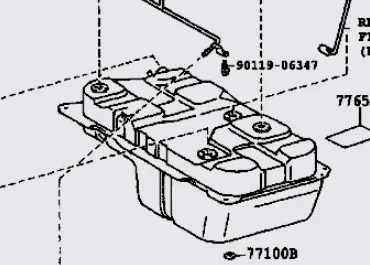

I show part number 7710060910 for the tank and it shows unavailable from partsouq. Is there a similar tank I should look at?

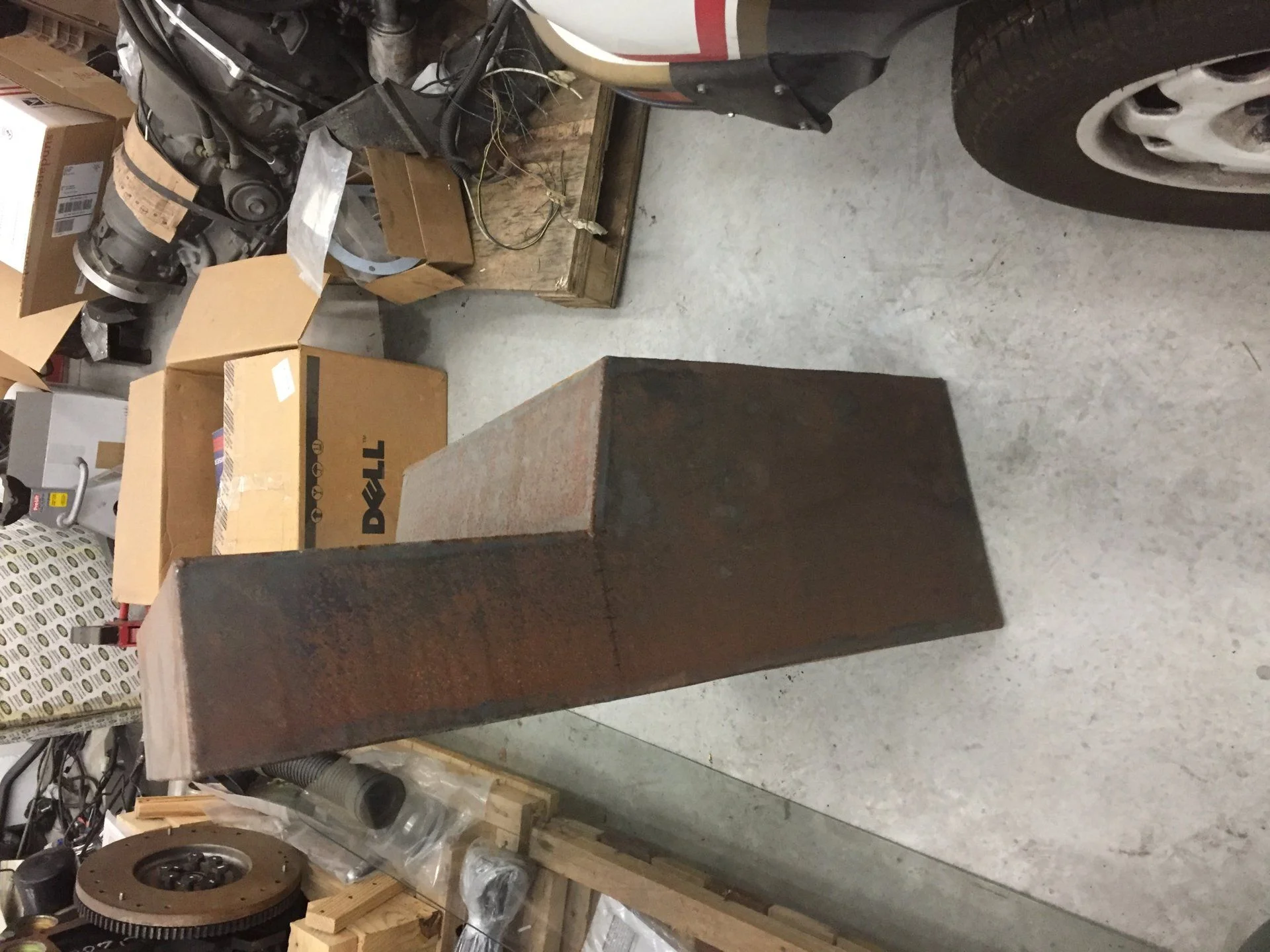

I have a this from my current project....somebody started a tank....at least I think that is what they were doing.

7710060918 for a HZJ75 shows 3 left. I don't know what the difference is for gas vs diesel. It's also one of the few items that doesn't have a photo.
