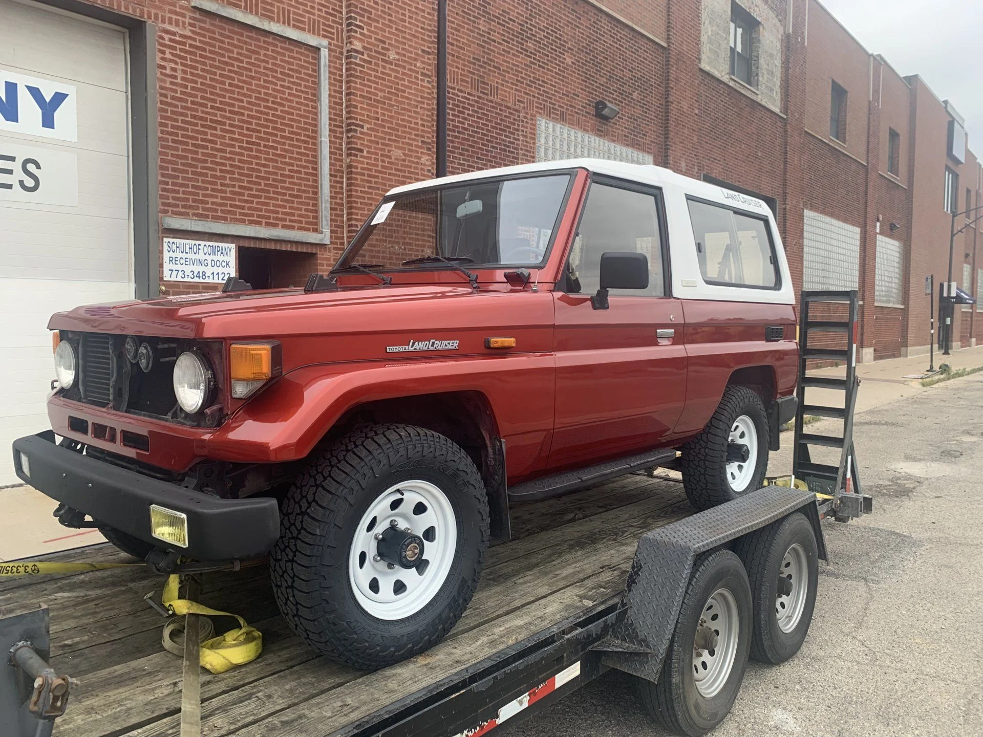

Well, kids are going to have to learn shifting on a different car..... picked this one up.

Nice! What are the details on it?
I will start another thread for it.....
Congratulations on that red , spanish Land Cruiser ! Is that a Japanese made with 3B engine or Portuguese assembled with the 4 or 5 cylinders VM engine ? These VM engines are terrible , but the Portuguese assembled BJ73s have a very interesting feature : very short diffs , rear axle with limited slip diff . Excelent candidate to a 12HT engine and big tyres !
When I saw this new one, I was wondering if was THIS one.....but I guess not.
VM powered BJ73 ? Planning on doing the engine swap right away or waiting until it blows up ?
Nailed it! Yep... Pretty soon. Will let the kids learn to drive stick without the upgraded power..... Random thoughts, but no clear plan yet.
Interesting. VM engine. I have this original sheet when it was imported to Madrid. Does this tell you about limited slip?
On the metal plate at he firewall there will be that information Trans should be H55F ; Axle should be K##3 or 5 . If it ends on 3 , it is a 2 satellite limited slip . If it ends on 5 it is a 4 satellite limited slip . Yours should end on 5 . It is a full floater axle . By the year/month , july 1992 it is one of the last manufactured . It could have AC , electric windows , maybe central locking and a center cluster on the dashboard . Last assembly models used to have all the bells & whistles . H55F gearbox ratios , may be also a little different from common H55F gearboxes , not sure though . Very well built Cruisers at the Ovar Plant , where South African spec 7 series are assembled nowadays .
