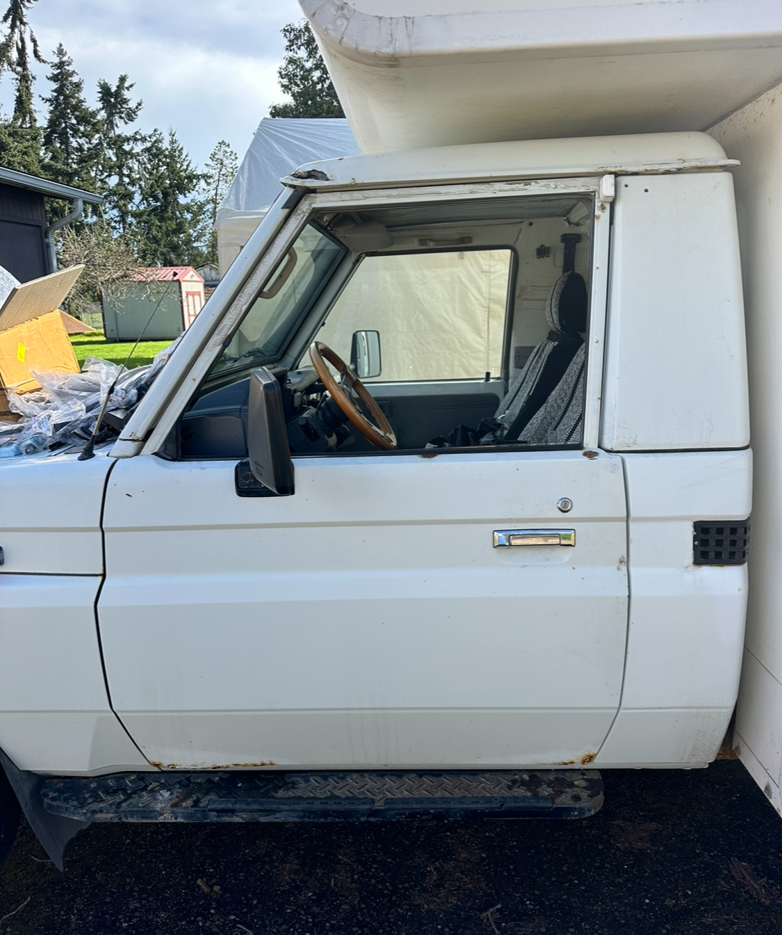

I bought the lil camper 75 series that was forsale last fall in OR.
It was kind of a sight unseen purchase, by a buyer that really didn’t know exactly what he was looking at.
I knew it was diesel left hand drive and a camper, with factory lockers
Recently learned that it’s got some kind of custom cab and need advice or opinions on what to do next.

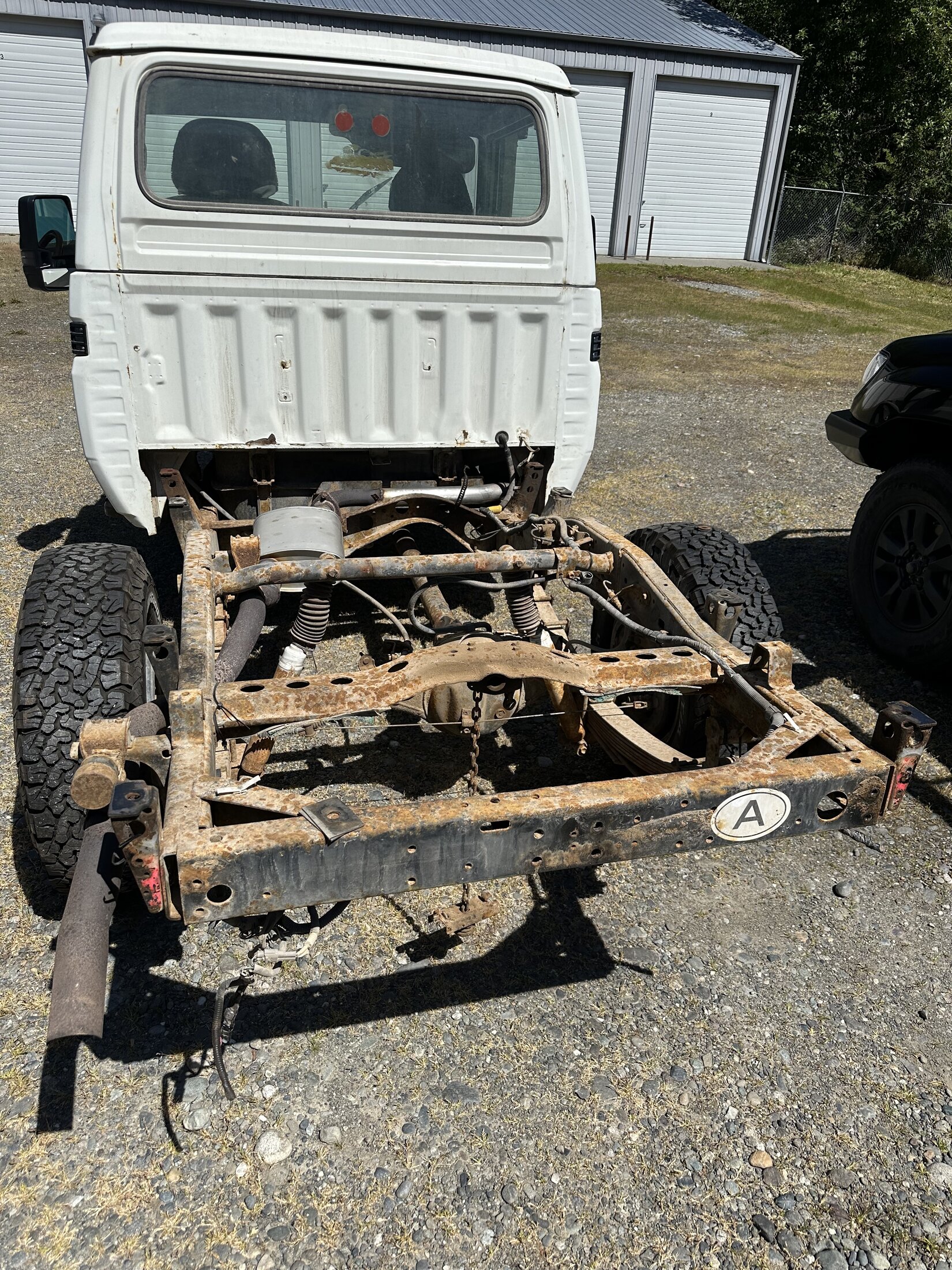

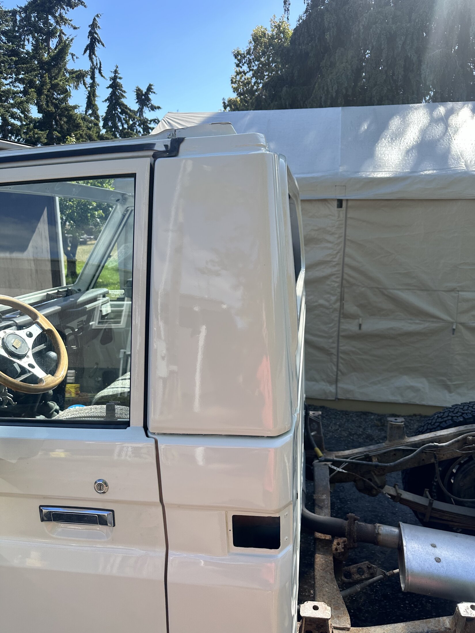

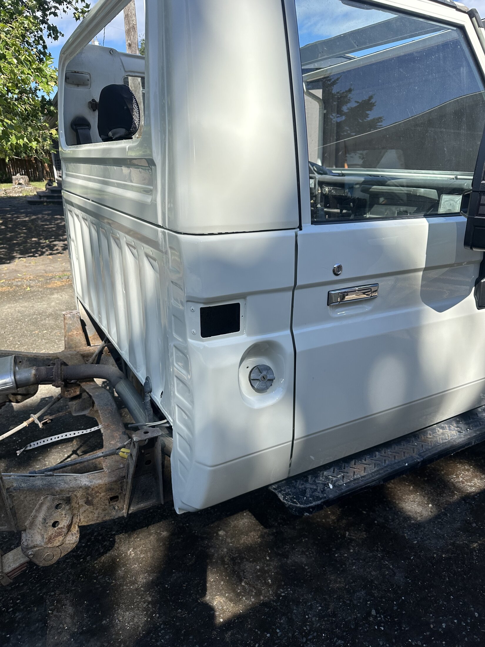

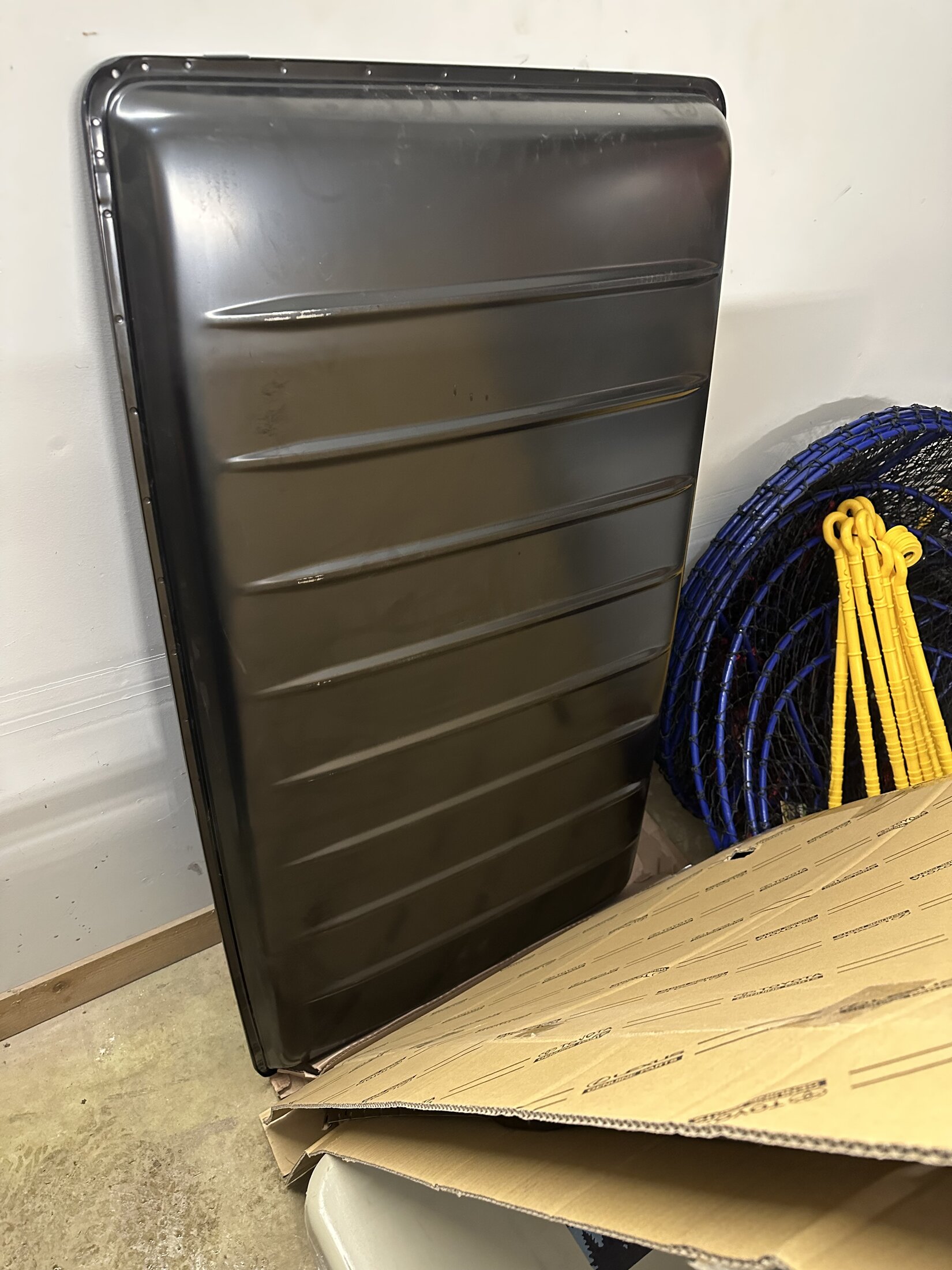

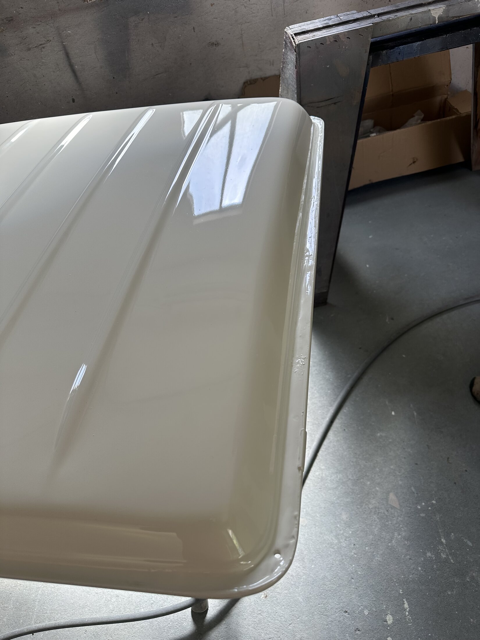

I purchased a new top panel and had it painted, only to realize that my top is custom extended about 5 inches as well as the back of the cab!
It was pretty nicely done, my body guy thinks it was done at the factory. (based on whoever did it’s access to factory everything to complete the extension)
Has anyone ever seen this ?

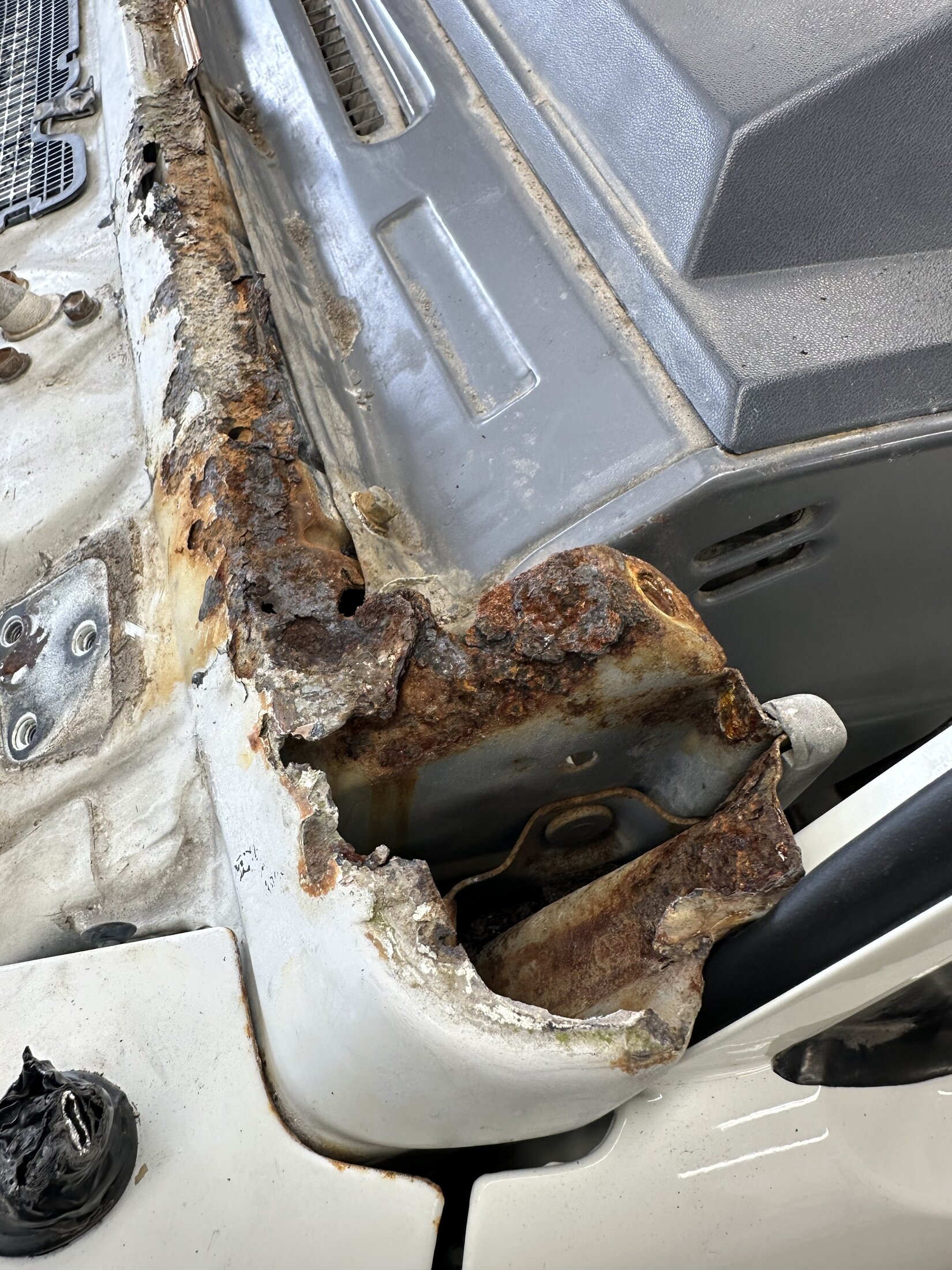

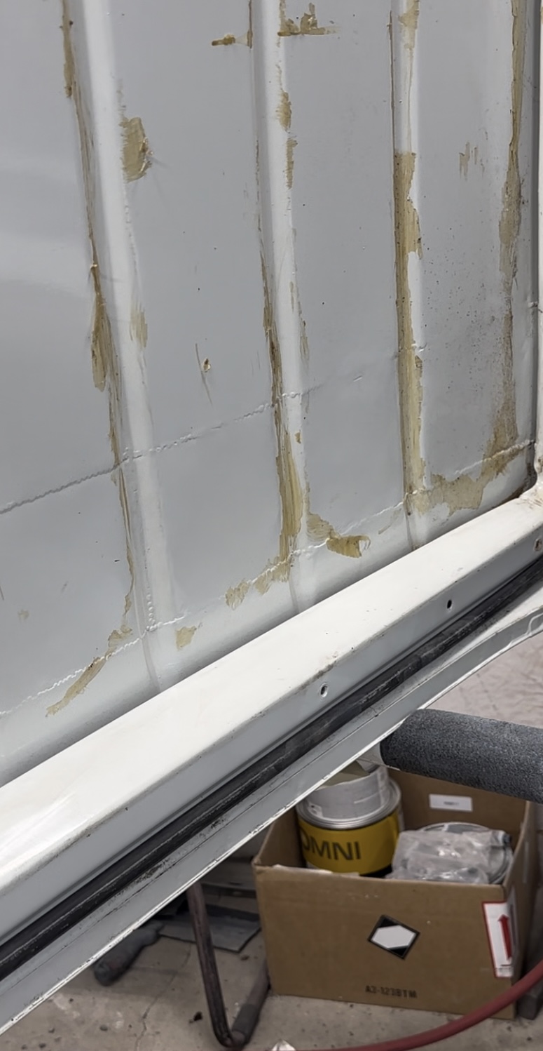

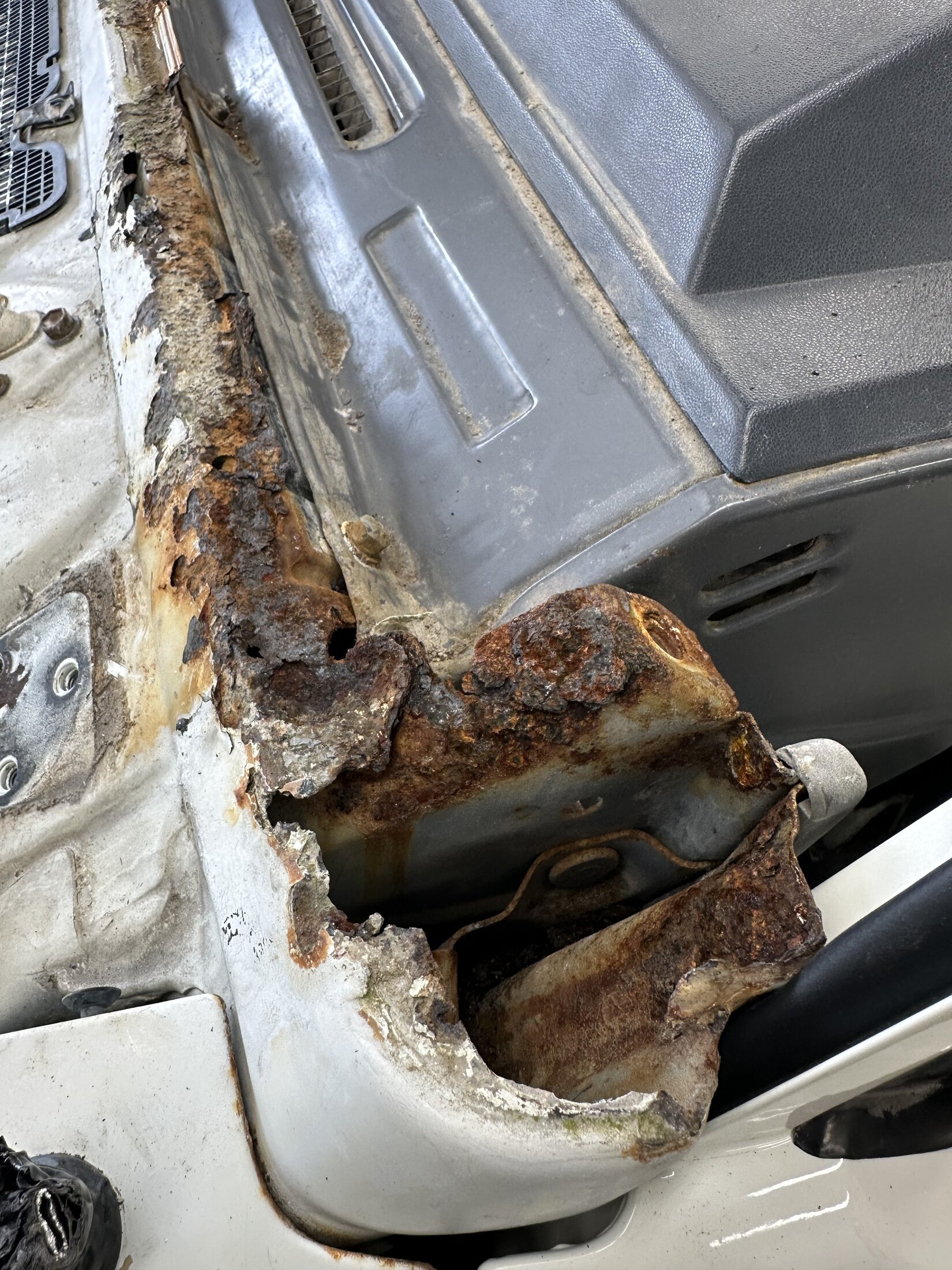

Pictures of progress on rust repair

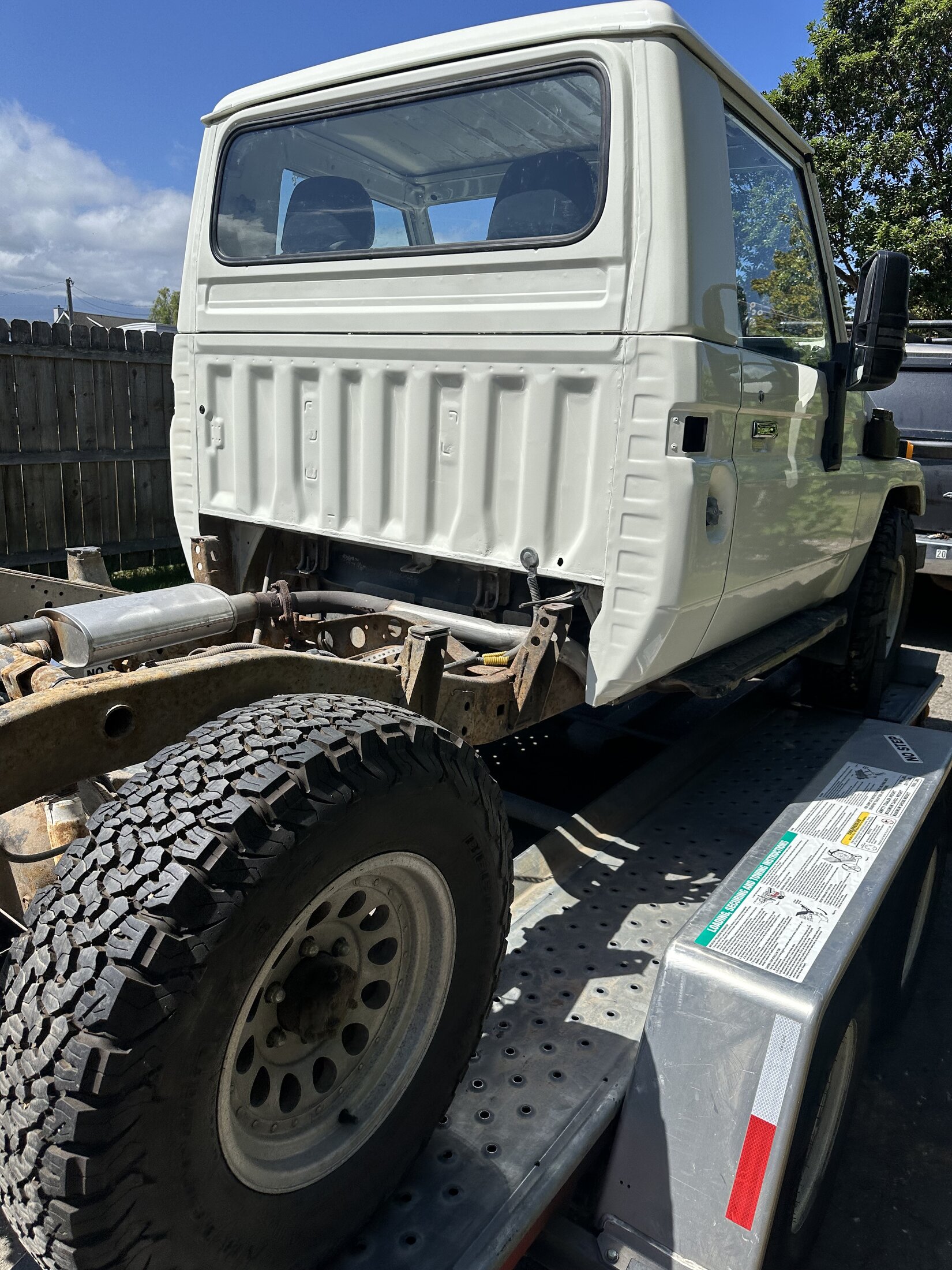

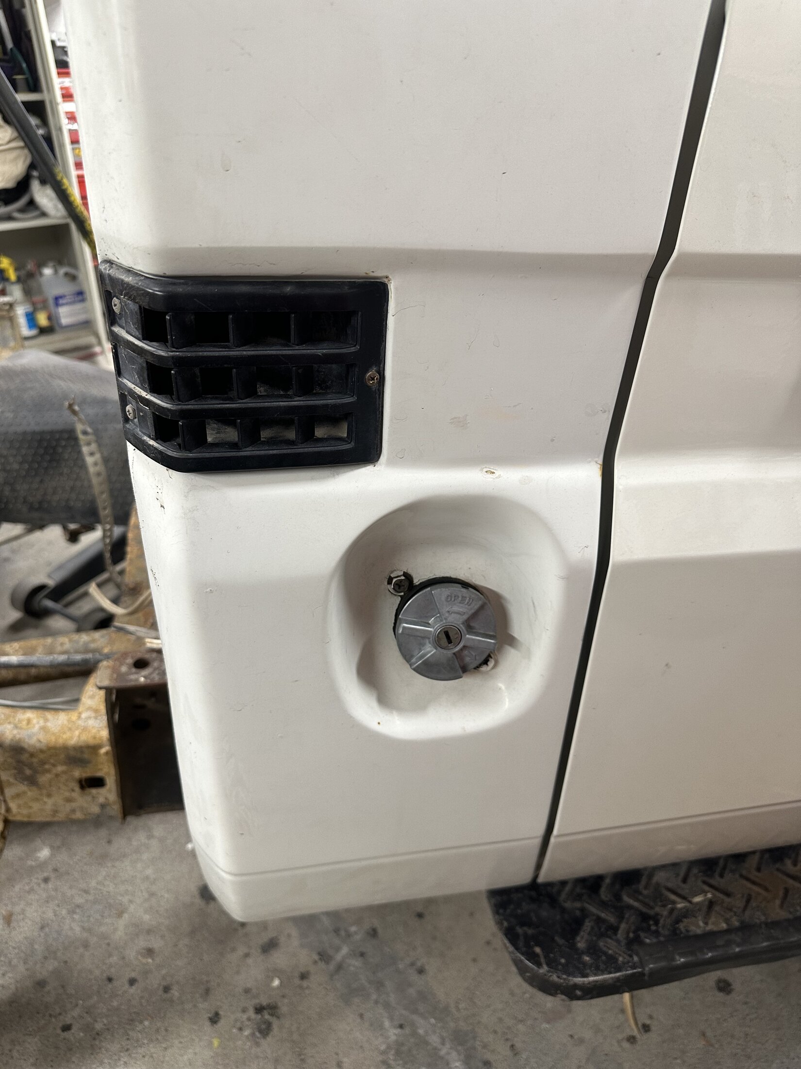

The work to extend the cab, about 5 inches is pretty extensive.
You can see (not very well in the photos) that they used two factory pieces sistered together
The VIN comes to a 97 75 series a little frustrated
So in the first post you can see that my cab is slightly longer than the factory 75 pickup

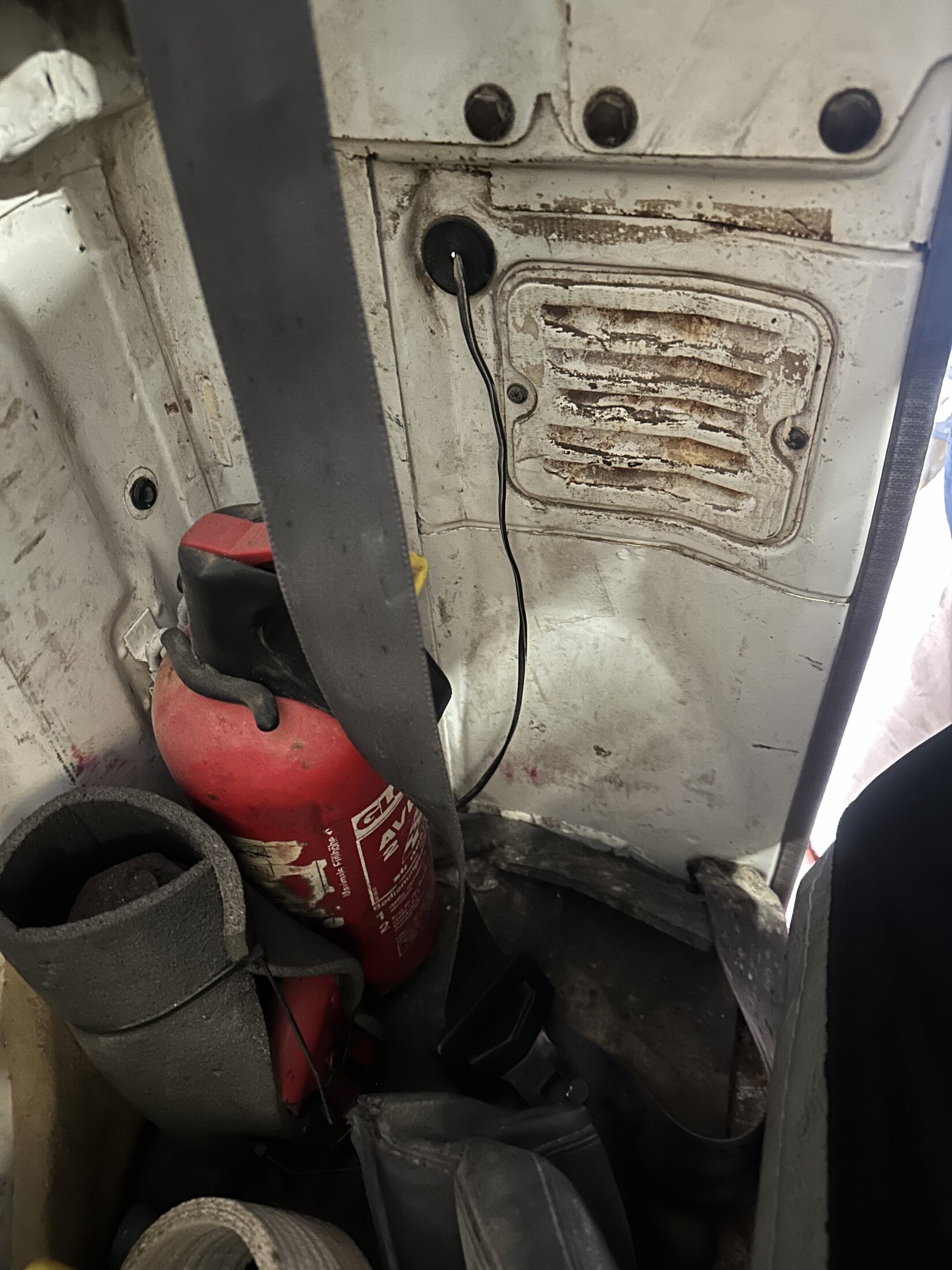

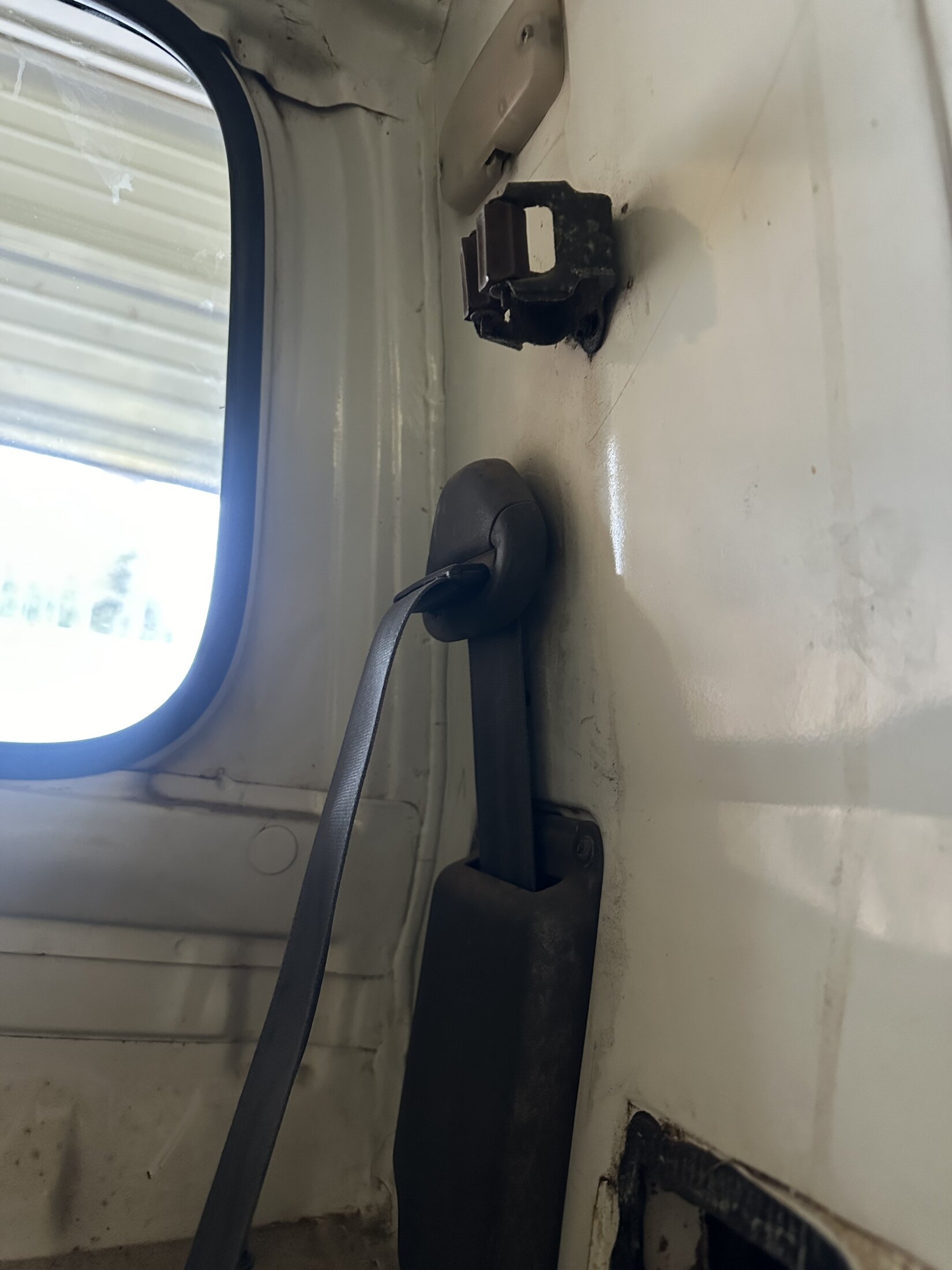

Here is a photo of the stretch on the inside
That does not look like factory body work to me. I'd suspect it's a custom roof cap/cab extension, potentially using some parts grafted from a 79 Series which was wider behind the door.

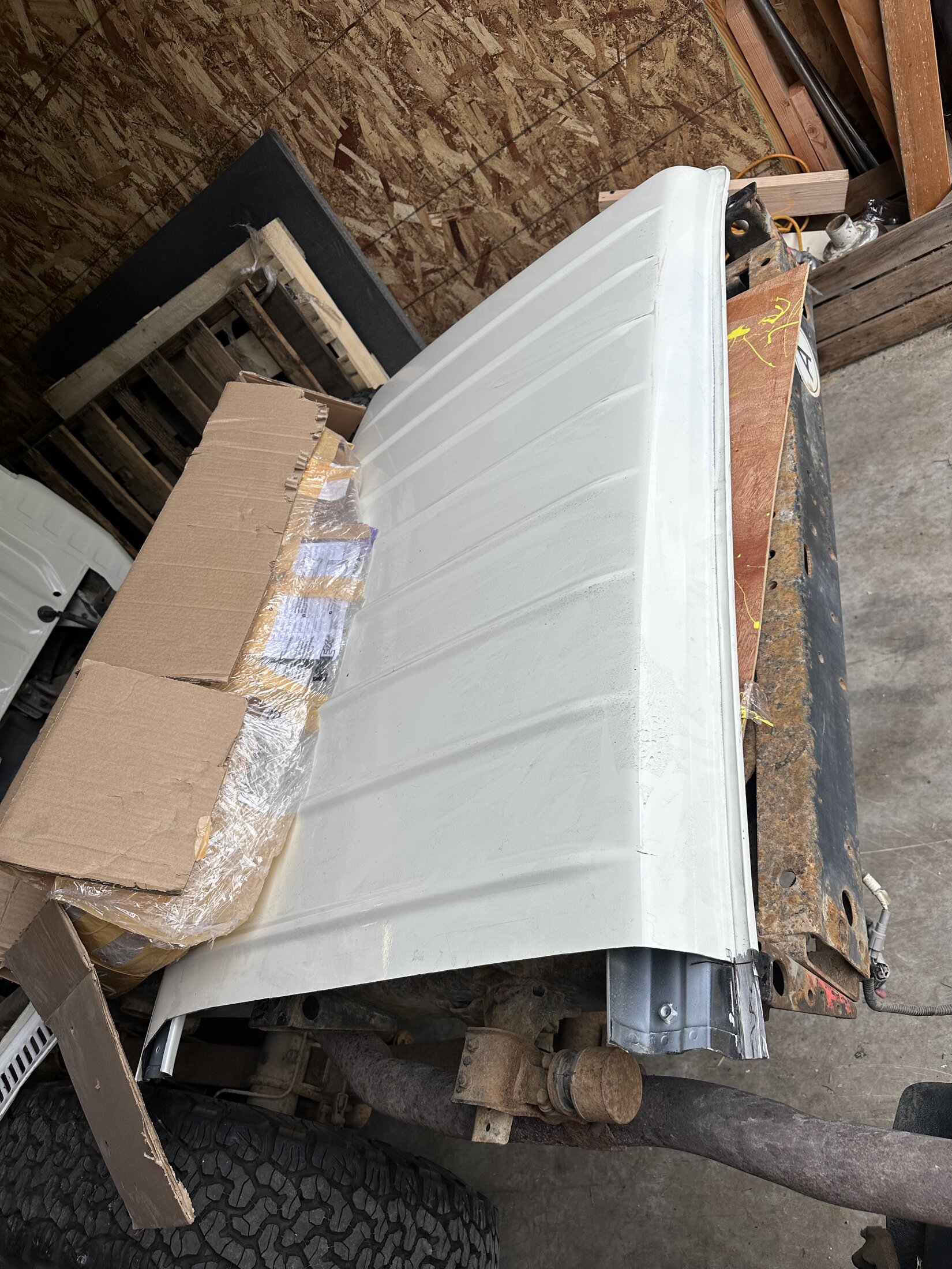

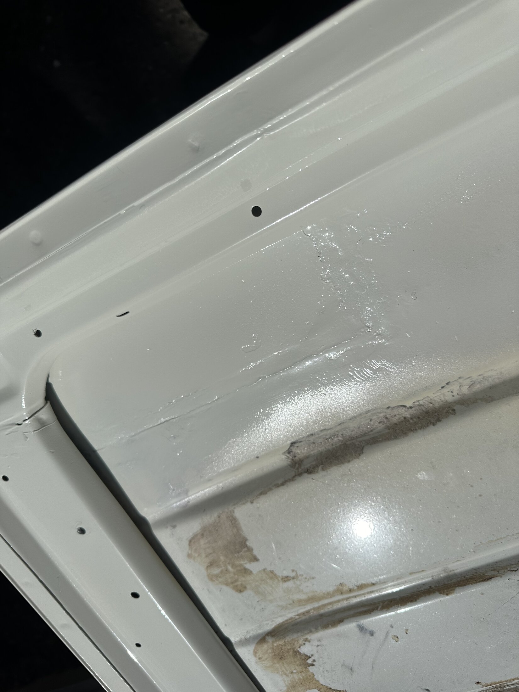

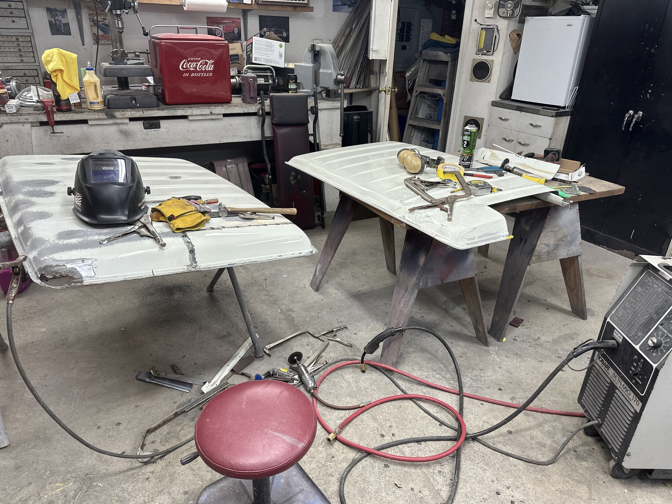

Awesome thank you for the feedback, We are going to cut the new factory roof panel use it as unfortunately patch pieces for the panel that came with the rig.
Unless someone has a different idea, that’s the first thing we came up with.
It seems a shame to cut up a new panel, however I think that the “easiest” way at this stage.
It’s unfortunate that I didn’t notice the difference before this was painted

Whoever did this work had access to what appears to be unlimited factory parts. The inner welds on the roof panel and not cleaned up very well.
It makes for a pretty comfortable cab, not cramped over the steering wheel
When I get it back to my place , I will have a chance to take better interior pictures.

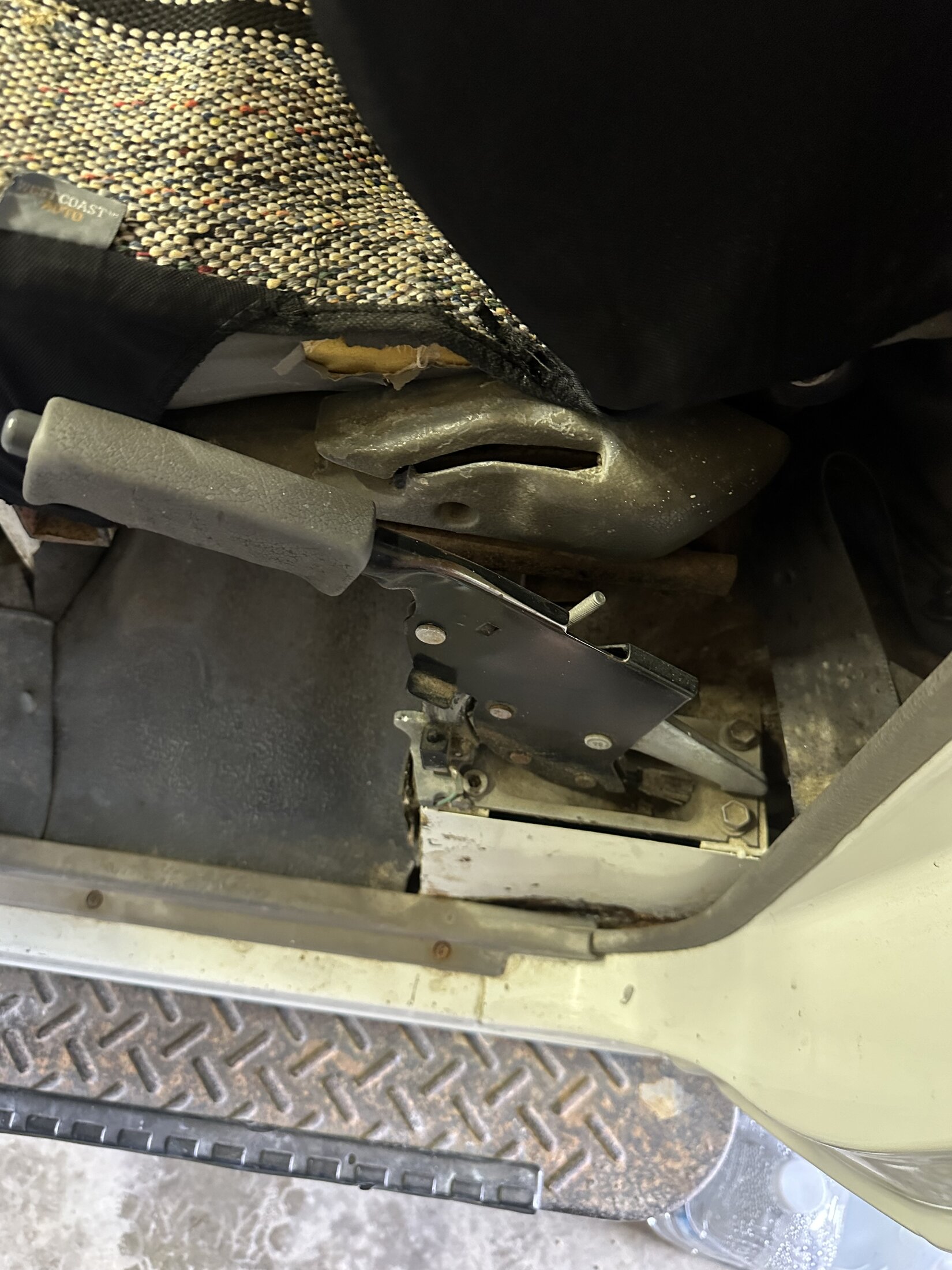

Showing all the factory brackets and fasteners that were utilized. Another oddity is the E brake is on the Left side of the drivers seat, not jimmy rigged.

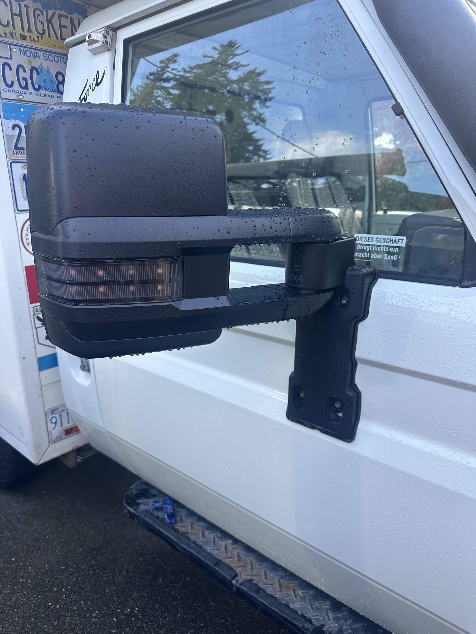

Nice mirrors. Are they Australian?

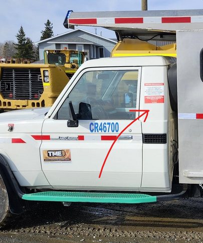

75 Series trucks had a cab with folding windshield and removable top. 79 Series had a single piece cab.
Whoever worked on your truck grafted parts from a 79. It seems well done, except for the rust.
Maybe this truck worked in a mining operation in its previous life. That would explain the modification quality and the rust.
It is also possible that the previous owner had deep pockets to afford such a modification.
Perhaps you can use the top panel from a 79 Series.

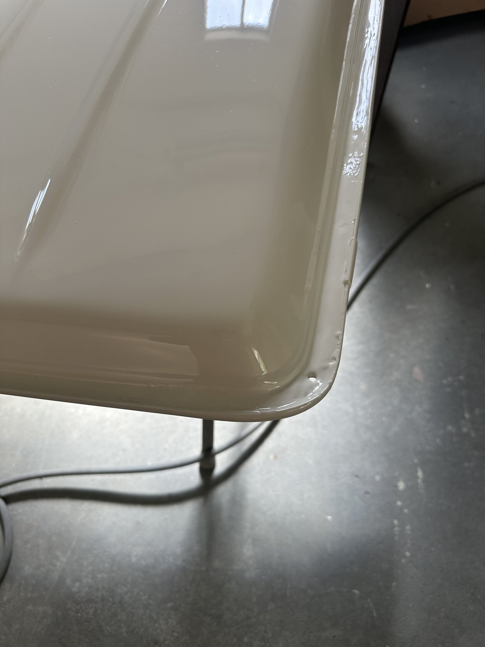

Progress on the cut and fill
With limited options, no real time constraints just not a ton of information or parts available.
My guy has got it tacked together, unfortunately cutting a brand new roof panel for parts.

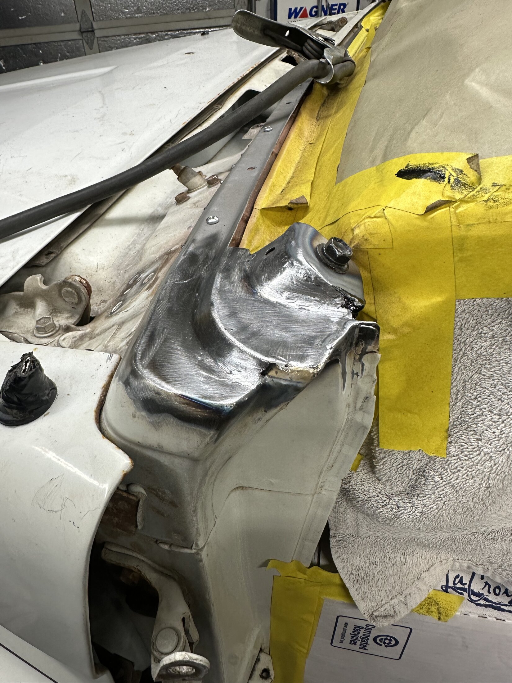

I had previously mentioned that the e brake was relocated, as well as the cab extension. Have been busy pursuing Swordfish with any spare funds and time. However hoods finally came back in stock at partssouq, and I ordered the vent cowl from some east coast parts guy.
