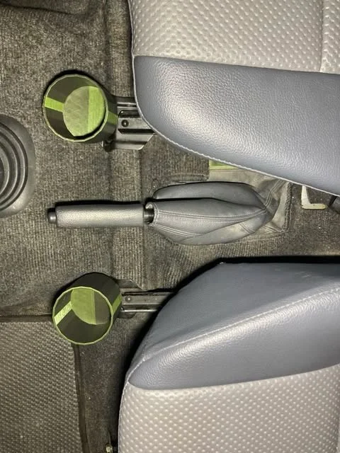

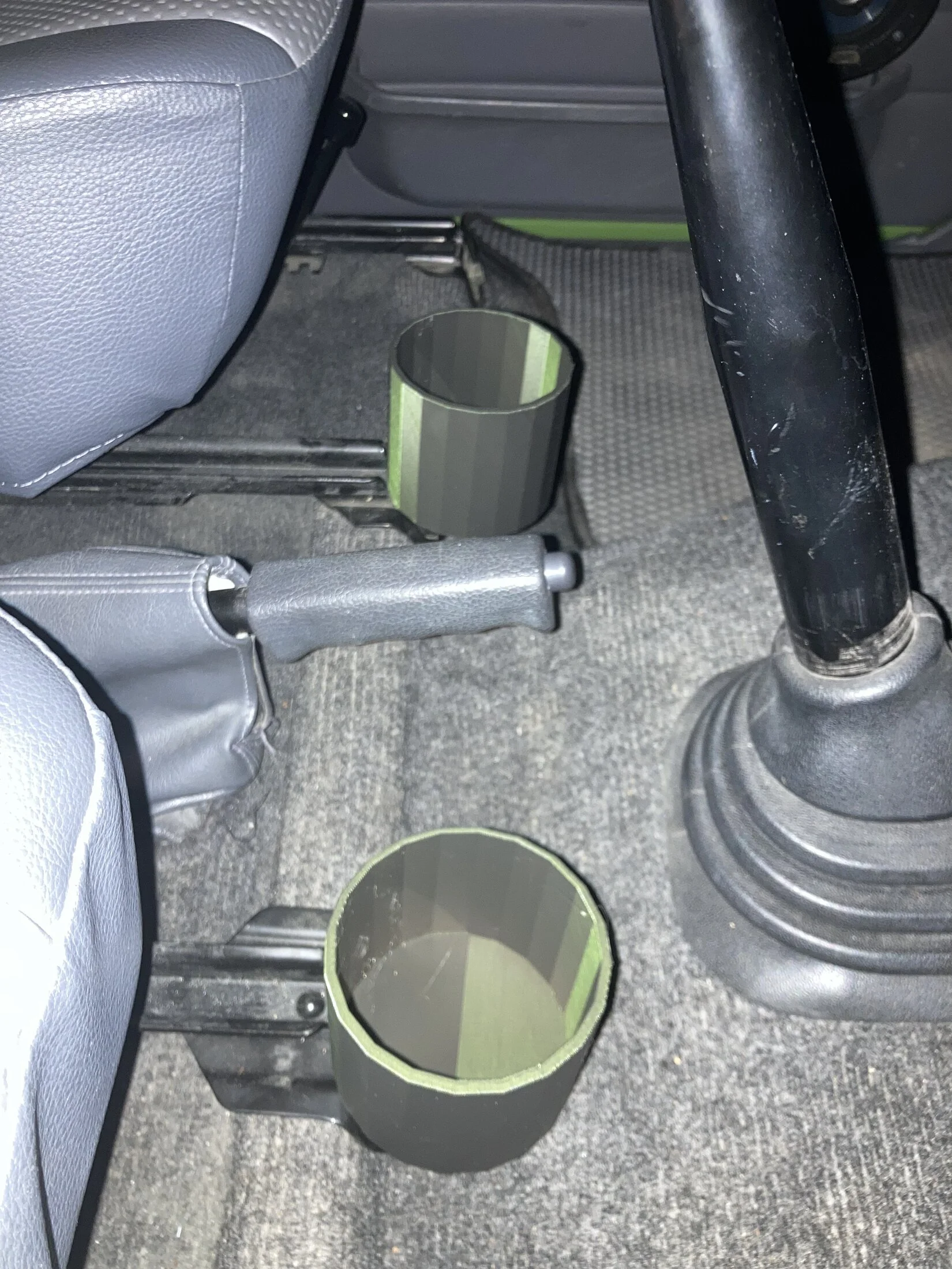

After being pissed off at my tape on cup holders for limiting space i decided to design/make some 3D printed cup holders. They work great and bolt on quite easily. I attach a STL file to this post if anyone wants to make them too. For them to work well i recommend adding a modifier and printing the base where the bolt goes in with 100% infill the rest with 20%. This way they are strong enough. No supports or brim needed.
