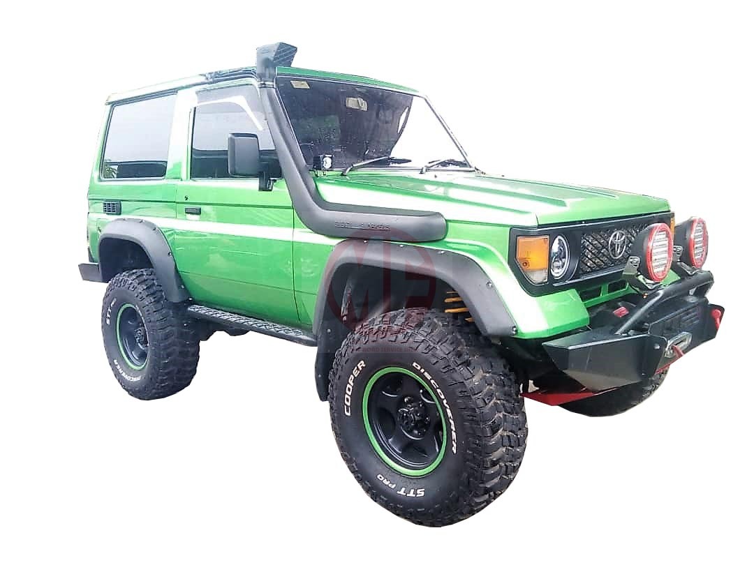

I have started rebuilding my 1987 LJ71. I want to add some fender flares to it. I have been looking around online and found a few sources. But none specify if the flares available will fit a wide front or a narrow front land cruiser. Mine is a wide front. Is there any difference as far as the flares are concerned? Also can anyone recommend a good source for the flares? I live in Canada, if that helps.

I use these rubber flares, much more damage proof than FG and cheap. You just cut them to length

By wide front I meant the fenders. I know some have the turn signals mounted on the outside of the front fenders and those seem to stop higher up. Mine has the turn signals mounted inside the front fenders. Mine is from Japan, but was imported to Canada. But those flares you suggested might just do the trick. Thanks

I think you're referring to the heavy duty models, like the BJ70 which looks very similar to your LJ71.
in Japan they are a Prado and in South America and Europe they are a Landcruiser II
The 'Prado / Land Cruiser II' names came with the later rectangular headlight models. Although both models are coil sprung their suspension and drivetrain are very different.
As for the flares, I think you'd be better off sourcing some after market ones then original ones since they're much easier to fix (the original ones have factory riveted brackets to the fender). Something like these;

Light duty trucks aren’t referenced in that. The OPs truck in the picture is a limited production “bundera” it is considered a Light Duty 70 series, and is a Prado for all intents and purpose. Yes is has round lights. Still a Prado.
