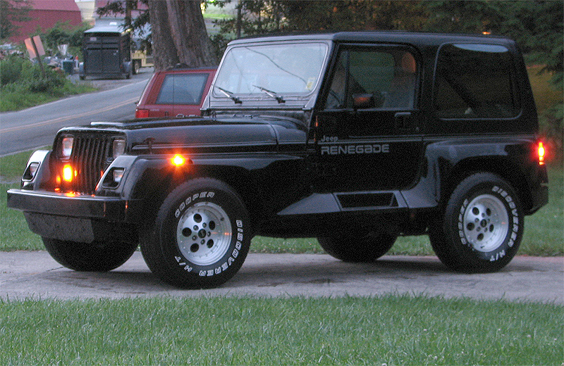

The Jeep was(is) no competition for the 70 series. Jeep had the CJ briefly, then YJ for competition for the 70 series that we can legally import at the moment. TJ coming soon in 96.
Let us compare some of the better selling points
70 Series:
Heavy duty axles
Full floating axles
Cable lockers Front/Rear then electric lockers
heavy duty drivetrain
Diesel: 4 cyl, turbo 4 cyl, 6 cylinder
Gas inline 6
OEM snorkel (if you like that sorta thing)
better frame
Overbuilt, very quiet compared to the wrangler
RELIABILITY!
Jeep had:
4.0L inline 6
terrible axles
weak drivetrain
unreliable
loud
cheap
ugly
You go to a dealer, which looks more appealing?
This:
Or this:
