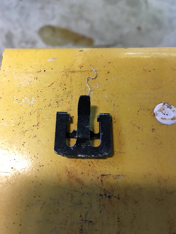

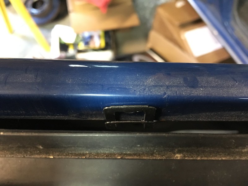

So once you get the inner window felts you will notice they are too long so you have to trim them and they come with thick clips, which are not compatible with the round holes on the inner door:
To make the clips fit into the round holes, I ground down the clip barbs to fit in the round holes (about 4.5mm wide):
It snapped in very nicely and securely:

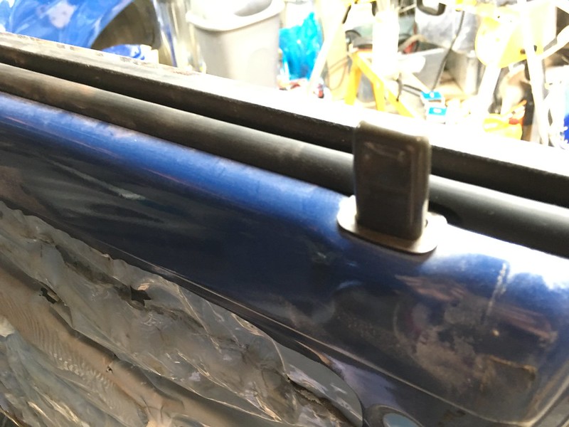

Here it is mounted:

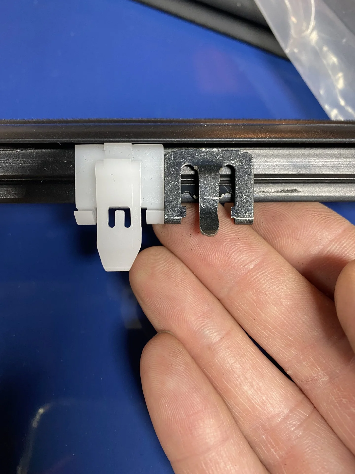

I'm replacing my door cards with units from Australian Door Cards and need to install new inner window felts with clips. Searching through other posts, the inner felts for front doors appear to be available, 68170-90A01. Several posts have suggested cutting down the front felts for the rears as those are NLA.
For the clips, others have suggested 68211-90K00, which are plastic, not metal as the clips in this post.
Two questions:
- Will the inner felts, 68170-90A01, work for a FJ62, or should I try and source units from a FJ75 as suggested in the original post?
- Will the plastic clips, 68211-90K00, work in this application, or should I try and source the metal clips shown above and file them down? (note: It looks like SOR has both the metal and plastic clips available)

Excellent questions and I am not 100% sure. I would LOVE to get the plastic clips to work. I wasn't a huge fan of the metal but it does work. Let me go back and see if the plastics could work but I believe there was a weird issue with how it grips onto the felts. I think I have some of those clips to see if they would work. The good thing about the 70 series version is that they were made for this type of application (no door card) so it has a rubber lip that sits nicely on the door sill.
Great, thanks for the quick pic! Definitely will order the metal clips and file them down.
I am going to see if I can locate a plastic alternative. But metal may be the only way.
So to make sure I'm understanding things properly here (I'm putting the Australian Door Cards in my 60), I can either go with the factory 60 window felts and replace the clips with metal ones (does anyone have this PN?) or I can go with 70/75 series felts that come with the metal clips already on them (any recollection of those PN's)?

I have the aus door cards. I used the plastic clips on the felts…. All you have to do is drill the holes out slightly. Very easy, a small step bit works well. Once you enlarge the hole for the plastic bit the weatherstrip will lock tightly down in. The grinding the metal tabs will keep the weatherstrip kind of up high and loose, I prefer the plastic ones
Ok, that sounds easier than changing out all the clips. I got exterior felts and lower front runs from CityRacer, but he doesn't carry that interior felts or window runs that I can see. Ordering those from one of the online dealers.
