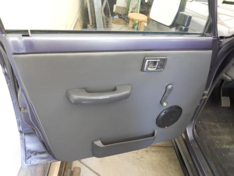

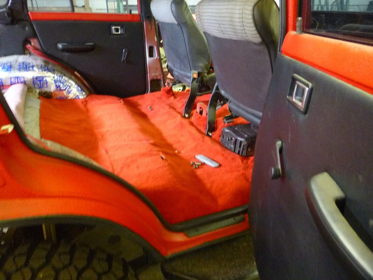

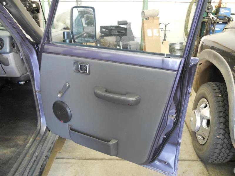

Here are a few of Marley and Goss' panels.
J
dscn3179-jpg.663072
dscn3183-jpg.663074
dscn3196-jpg.663756
p1010738-jpg.1075526
p1030291-jpg.1131871
I took the top metal piece off the panel by removing the staples and can attach the panel and have exposed paint. The cardboard OEM panel is fairly tender after being so old. I think it will work, was just wanting to see the final product befor I take apart everything and go beyond the point of no return. Plus the metal was rusty under the vinyl. That kinda bugs me. The foam inside was toast too.

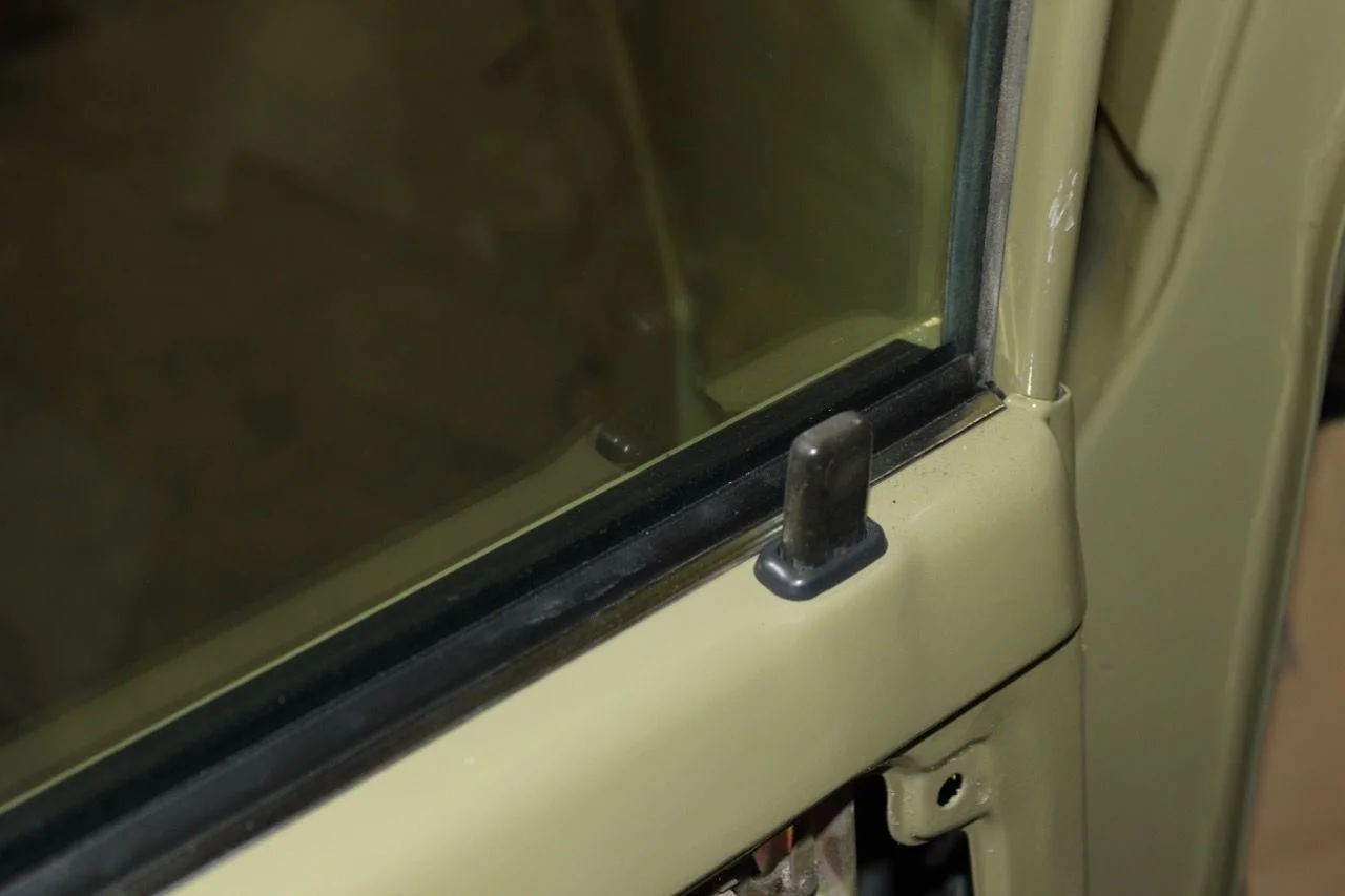

Someone needs to reproduce the appropriate factory door window wipers that make that possible!
You know Toyota does, right?
Not all markets had door cards that went all the way up to the window...
I am quite sure @beno can get them for you...
I love having the metal/paint exposed above the door card, myself.
Dan
I love the look too. I thought they were long discontinued?
Regular OEM inner felts will still work. Takes some effort but they install and work fine.
J
I had no idea! That is great to know. Thanks!
I bought them within the past year. Installed on May 31 of this year. ;)

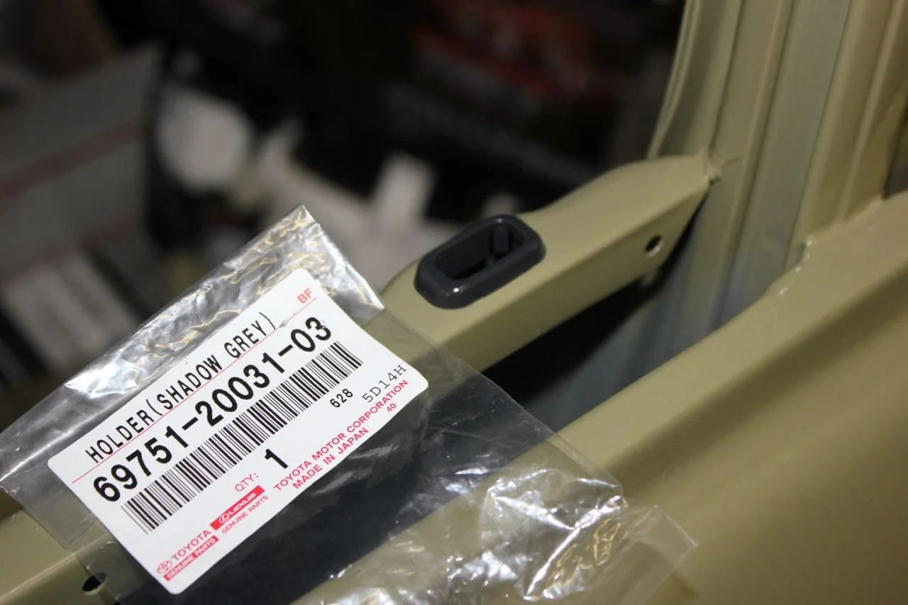

Jeff, just take the lock pull liner and install it back into the metal. It gives it a cleaner finished look than leaving it out. You can paint to match the metal as well.
Sure. you could do that.
Or.....
(that's the lock holder from the rear hatch--works perfectly)
Dan
Or.....
Dan

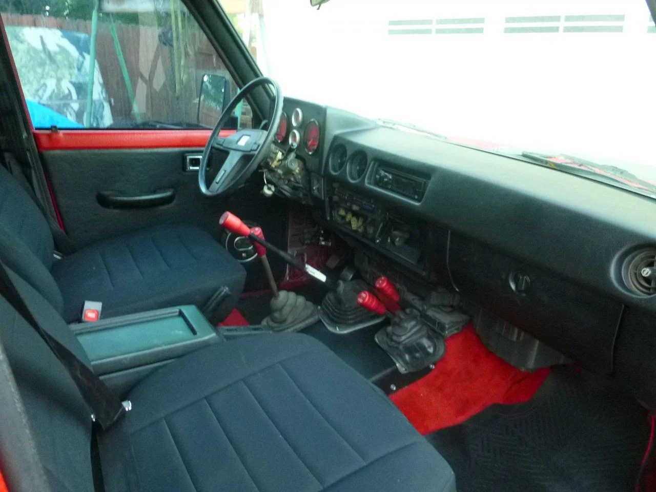

How has the paint help up over time above the door card? Ever wish it was still vinyl?
And did you go exposed metal all the way back? I'd like to see how you treated the headliner to metal transition on the C pillars
I don't know yet. Just painted it last fall, and haven't driven the truck yet. But it's well prepped, epoxy primed, then base/clear over that. I expect over the years it will slightly wear--and I'm OK with that.
The C Pillars are covered by a plastic trim piece, there's no real transition to manage. But I keep debating doing something with it, because I REALLY like the paint color on the pillars and the horizontal bar underneath the rear window. It just looks so sexy in paint.
Dan
