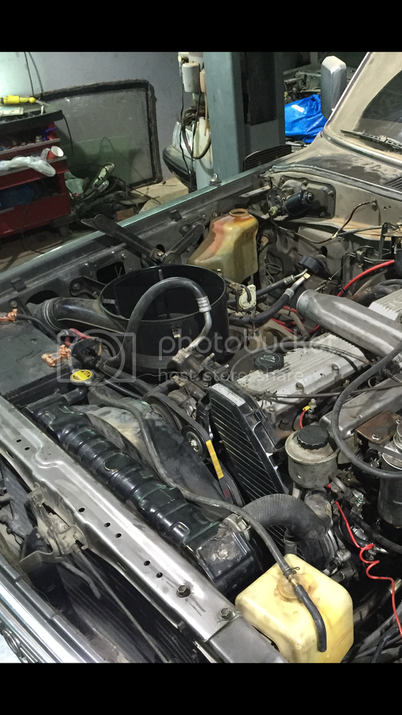

I found that flipping the stock 3F radiator upside down seems to work well with our 1HZ swap.
Might be worth a try.
Interesting.
Got any pics of it?
...or do you mean flipping the 3F radiator shroud upside down?

My bad, I meant flipping the shroud. I am out of town now, but this is the closest pic I have of it. Its not done yet, and havent driven her much to be able give feedback on the cooling capability with this set up.
Excellent! Looks like I need to find a 3FE/FJ62 fan shroud to try. That sure looks the ticket. A shroud isn't rocket science, so long as they are indeed a shroud, I'll bet it will work just fine. When you get back to the truck, if you could snap a picture of the fan in the shroud for me that would be great.
Thanks! That would save me days of work!
Did you connect the 70 series water hose to the lower outlet directly? I am debating having my radiator outlet moved farther to the right just to give more clearance from the fan, and because it's closer to where the 70 series water hose sits naturally. But also not sold on any particular solution there.

I got back to the shop today. First thing I did was remember that we had an '87 FJ60 fan shroud lying around, and I figured that might be almost identical to the FJ62 shroud.
So...
I turned it upside down and gave it a test fit...
Looks to me like the upside down shroud will work absolutely perfectly! I will have the radiator outlet moved to the farther outboard spot (where the drain cock presently resides). I've got an 18" fan, and the shroud fits it beautifully! I honestly don't think I could fiberglass up a better solution--LOVE IT.

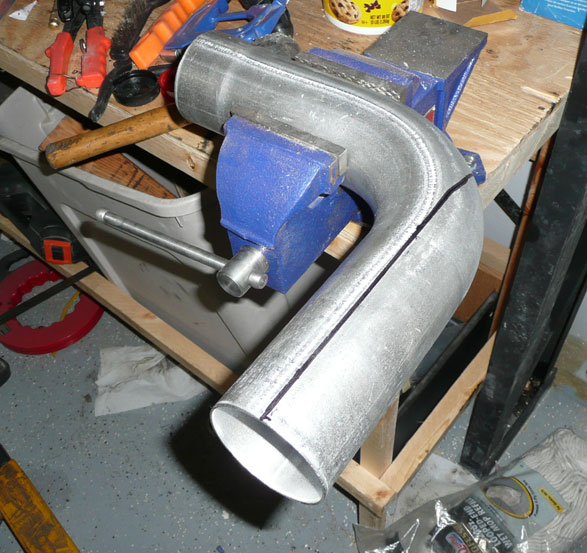

Then I started playing with the intercooler piping. This was far from a certainty of success, so here's a picture of the room you've got to work with.
I took a 135 degree bend from the turbo, and was able to snake around the air cleaner and AC compressor to make this all fit now.
The 135 degree piece I have is the wrong size, so I need to order anyway, but this proves to me that this will work. Barely.
Then to the left side.
The left side is much more straightforward.
But luckily the hood closes just fine with all of that piping above the engine.
