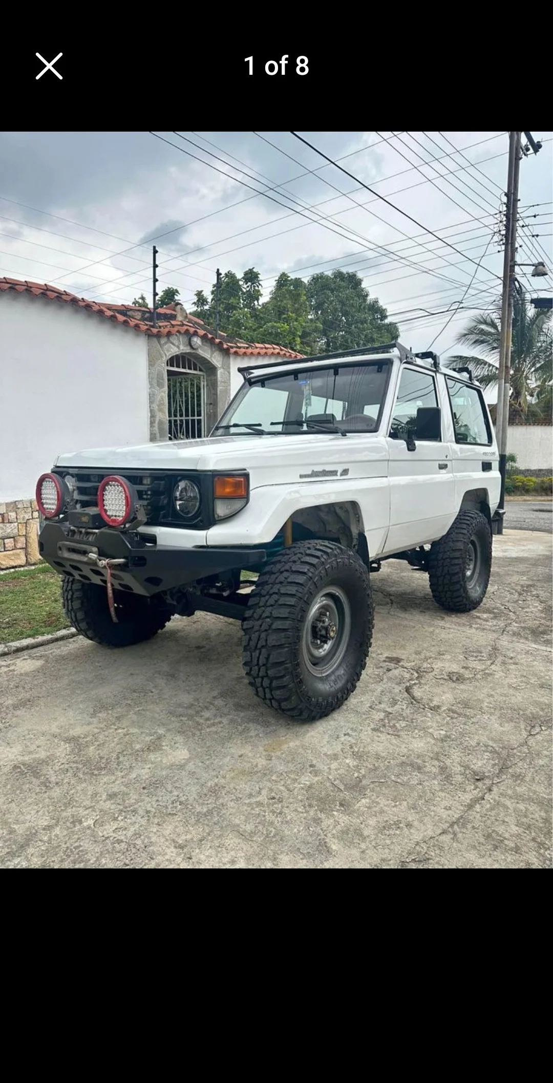

I have a 1996 hard top 70 pictured below

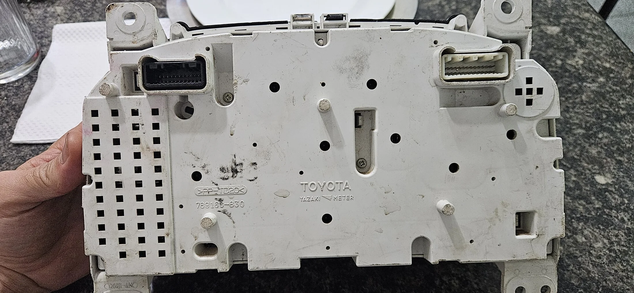

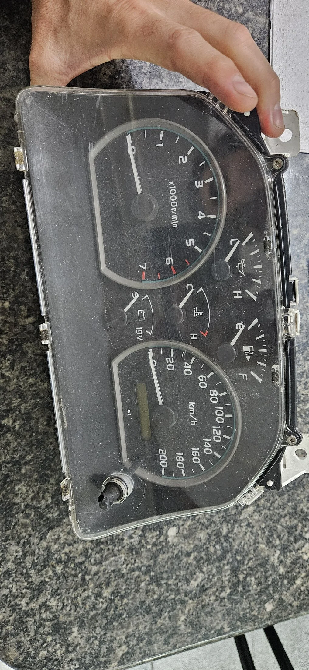

And I'd like to upgrade the dashboard with the one installed on the 2012 gr70 series. I just bought everything but I'm missing wiring diagram for the connections. Can someone help me with those? Thanks

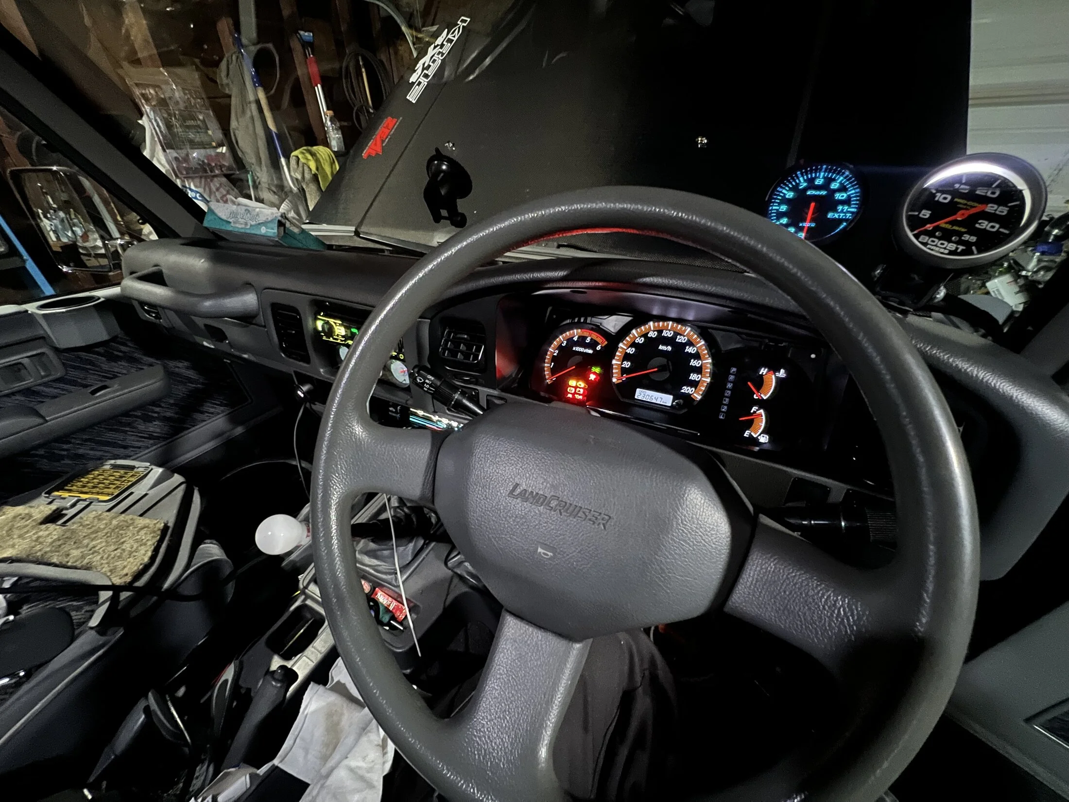

Thanks juan, but I know it has been done before. I've seen it working with a 3f engine, even older vehicle (1992)
As for the speedo, Im trying to make an adapter in order to install the 1gr engine speedo sensor on my gearbox.
I'm figuring if anyone has those wiring diagrams, that'd save me some time

I think it's mainly analog still on 2012. So I'm still safe I guess
