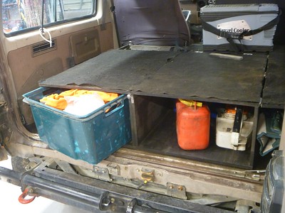

First thing you need is some tie down points so the load doesnt come rushing forward in an emergency stop. I used to have some black plastic containers with lids that worked well.

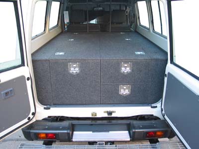

Or you could put a false floor or platform fitted with shelving.
Something like this but shorter to suit the MWB or SWB. If you have tie down points just below the windows ,you can go even higher.

Thanks, I was thinking on doing a false floor with some drawers eventually. building stationary boxes etc... I beleive there are tie down points in the back of my 73 already. I'll have to verify.
Thanks again for the input!
I was planning on a cargo barrier (metal or webbing). The interior height is 46", I was going to do 11-12" tall drawers and then a shelf so I can stack to the ceiling. Light stuff on top.

I think @cruiserdan has the right idea on how to get the most out of a SWB / MWB Land Cruiser. :)
Yes and you could let it evolve. Put the false floor in first, they are good for keeping prying eyes off your goodies and the shopping has some shade. And yes, there are some tie down points, but from memory they were a bit flimsy looking.
