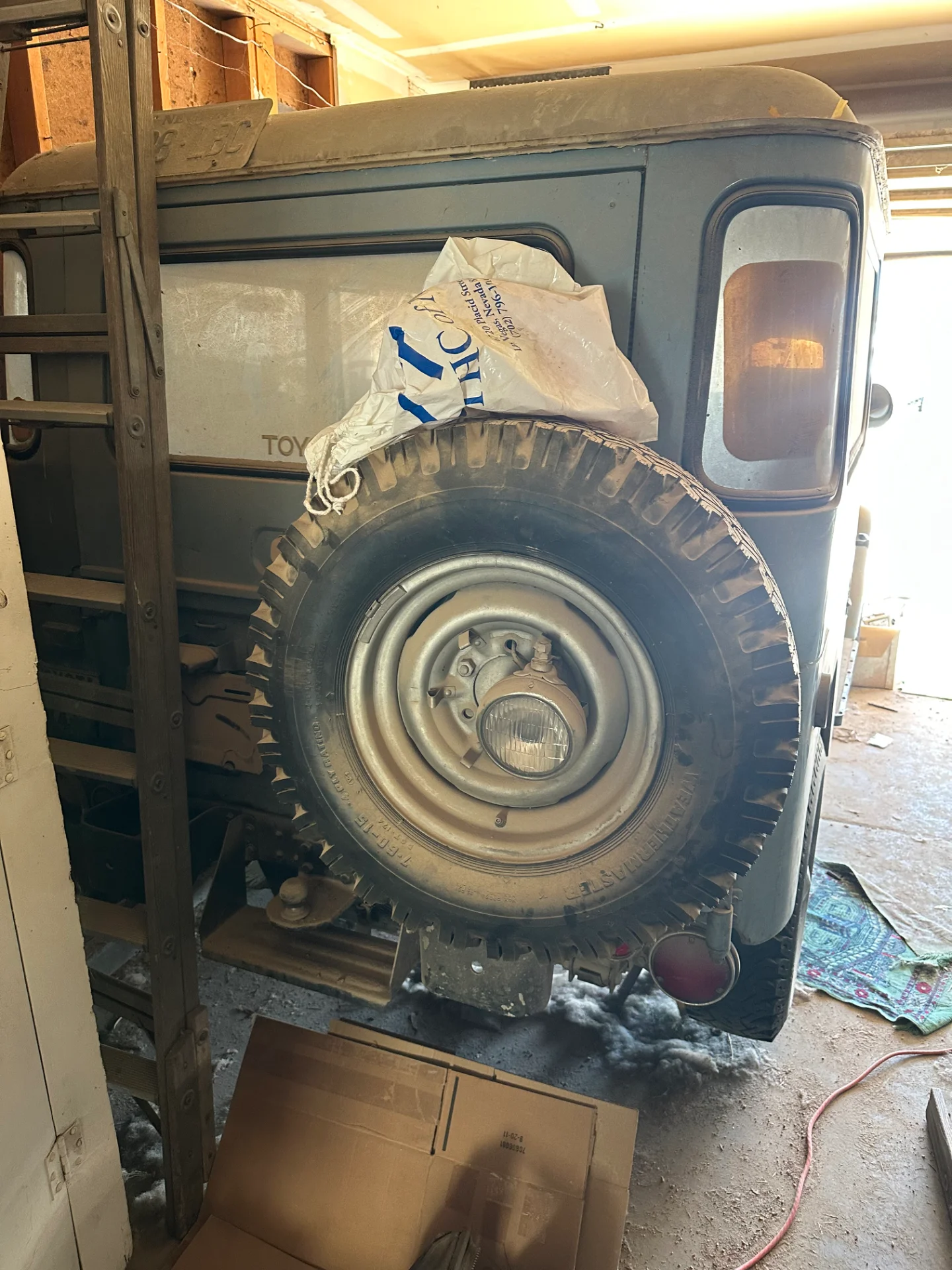

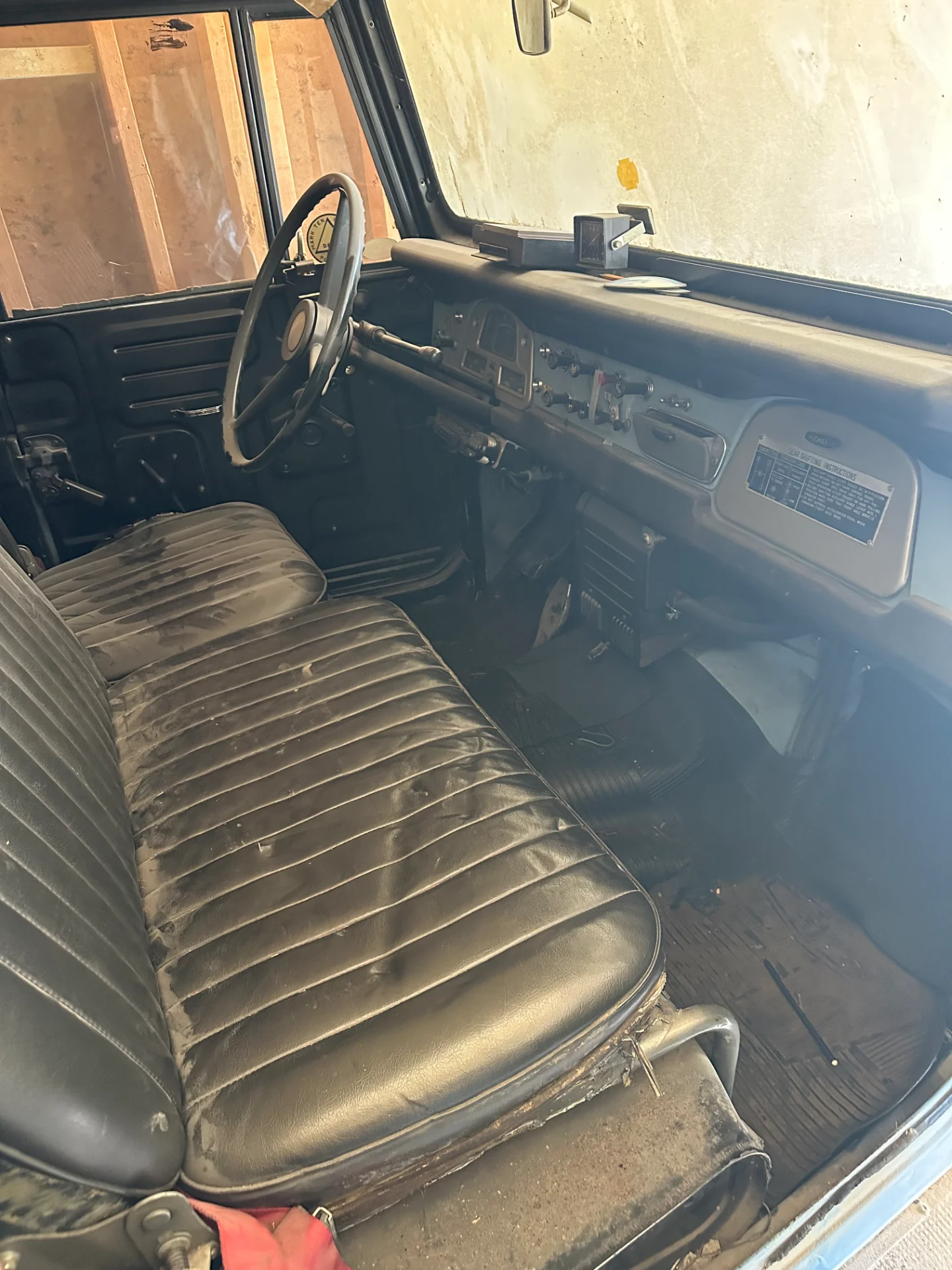

Hi All,
Thought you’d appreciate what I picked up yesterday. Previous owners father ran into transfer case issues in the 80s (presumably between 85 and 86 as that was the last registration). He parked it in his garage in Las Vegas… and there it sat. Until yesterday. I drove ~14 hours round trip for the rescue mission. I was told the last time it was started was around 1990. Will be going through everything, but start with a good deep clean. Essentially zero body rust, rear tub shows minimal use. Frame still has the original coating.
There’s a million ways to skin a cat but… what should be my order of operations here? I’m thinking brakes will be near the top, primarily because I’ll be sad when I get it running and I can’t take it around the block!
I have the original pink slip from ‘69, original tool bag (with grease gun!), a bunch of service records, and the receipt from San Francisco where he bought it. Random question - I saw someone comment on a blue 40 about the gas cap (it was blue) is that factory? I only ask because mine is also blue and I would have been surprised if he got a repaint but you never know.

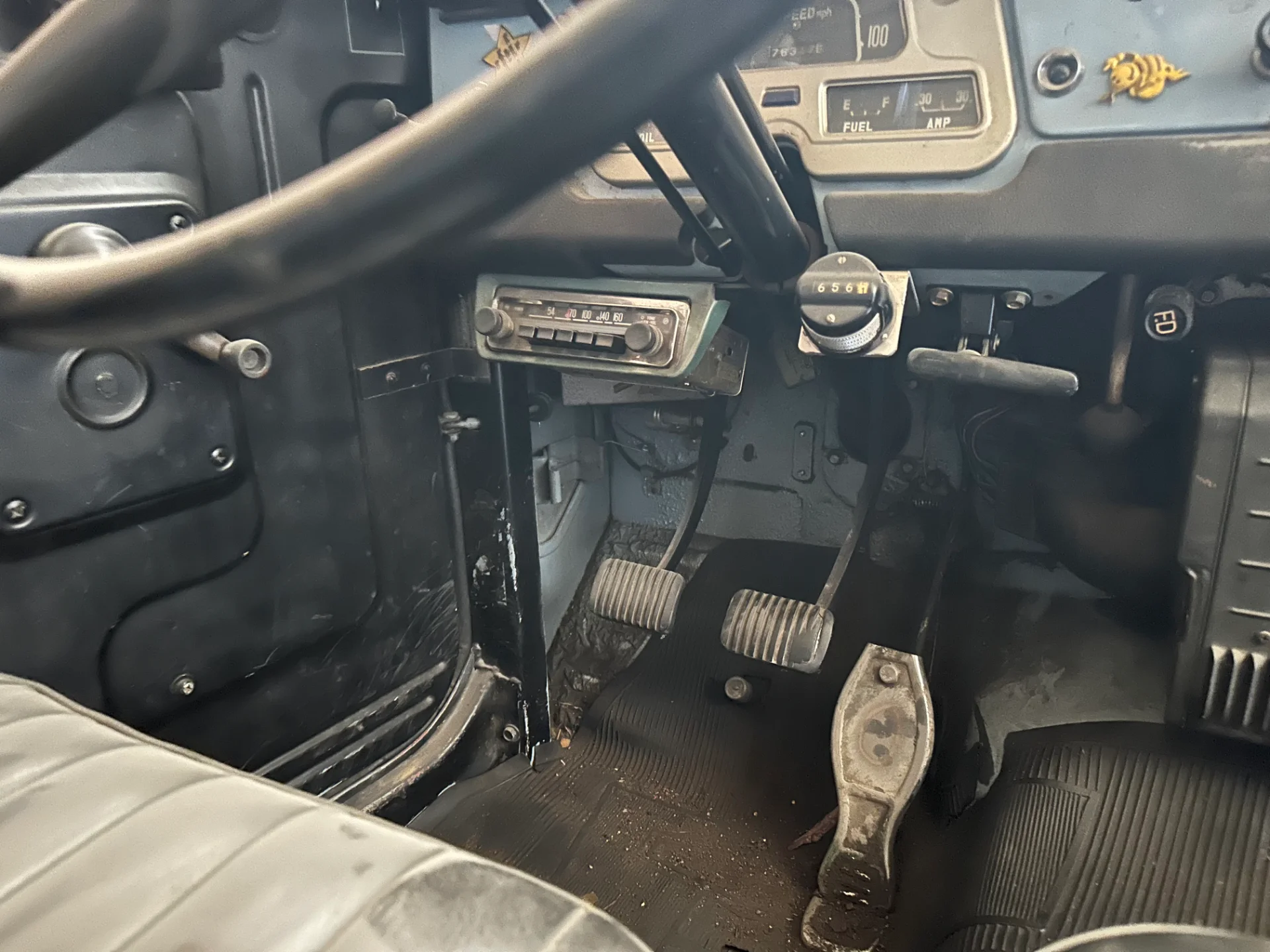

Lots to love there. Take lots of photos after you clean it, but before you remove any parts. The under-dash mounted radio is a real treat.

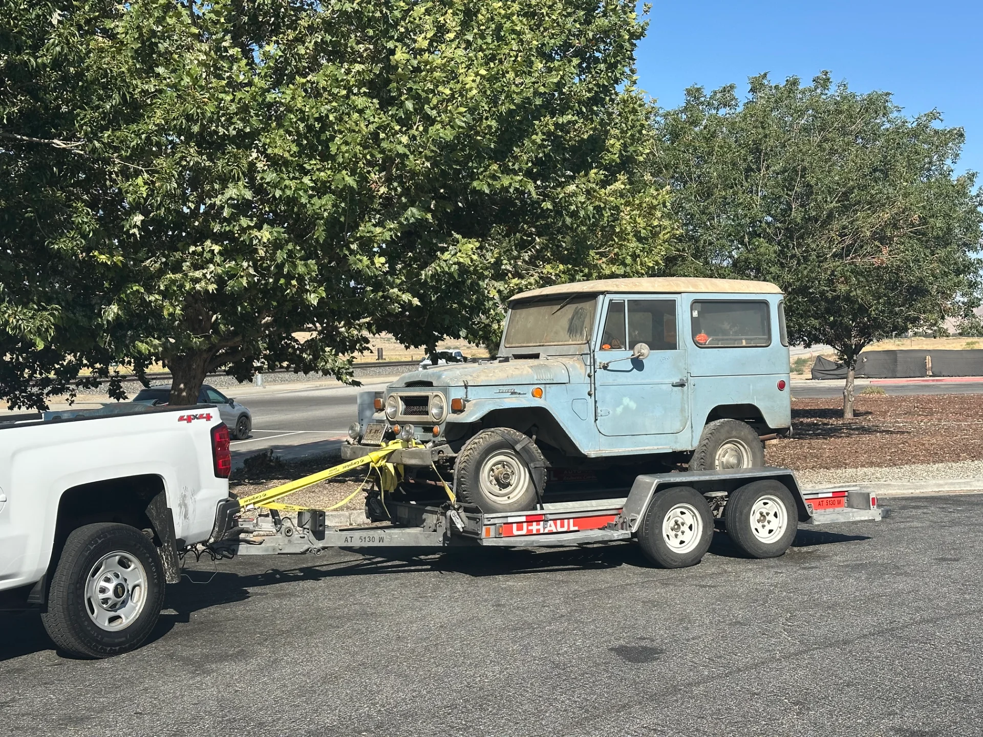

I bought it from the son, the original owner passed and the son was cleaning the house in preparation to sell.
Son had fond memories wheeling around nor cal hunting with it. Here’s an old photo he sent me today. In his own words “That’s me trying to push it down my father is dying laughing at me”.
Ironically, the transfer case issues is what saved it all these years. Parked it with the “I’ll get to it eventually” mentality and never did.
