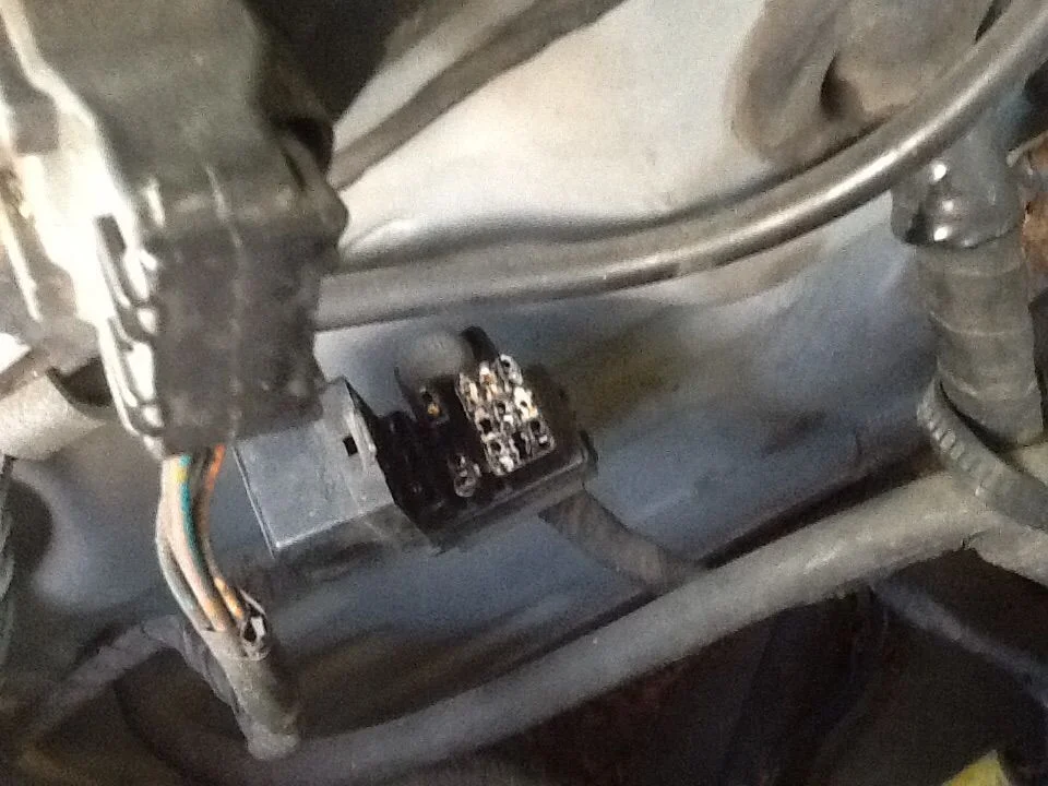

I just had my exhaust replaced, and it looks great, but now my check engine light is on. I found this thread and tried to self diagnose, but when I opened up the diagnose box, this is what I found. See pic for detail
I tried it anyway, (paper clip) and the check engine light didn't blink at all. I am assuming that I just couldn't get a clean connection. What is that stuff, and how can I proceed?
That is what it should look like. I know it looks bad at first but, that stuff (I forget what it is exactly, at the moment) is in there to keep the terminals clean and free of corrosion. Follow the procedure mentioned above or better yet get a FSM or even a Hayns manual. Do a search for FSM (factory shop manual) and you'll find links to them here. They will save your life.
