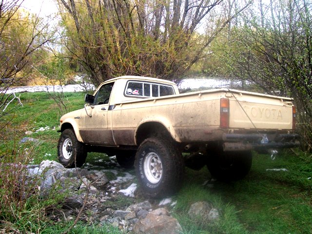

I was about to break down and buy some cheap 31" tires but a buddy got a set of free 33" cooper all terrains and gave them to me! I mounted them on some old rims I've been saving that I got years ago (also for free). So no more orthopedic shoes. These tires are a little out of date but they match the old school Toyota look I've been after...
I may be breaking the budget and shelling out for some gears this summer to go with the tires.

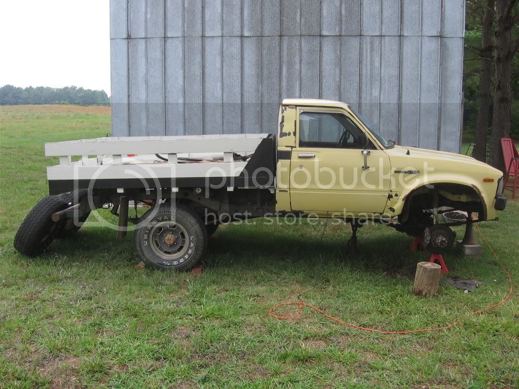

hi'ya! well this is my combined 85/86 with 8ft flatbed take 1. it's an 85 22R mated to the 86 A340H auto with 85 2wd cab on an 86 4x4 chassis .. total monetary cost was ZERO! :)
i kinda like the 2wd fenders & grill ..
(still have to figure out the auto'puter and/or switches to get use of all four gears)

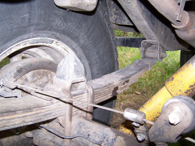

So to re-hash I bought this 1980 longbed last summer for $250. After a new clutch slave, a tune up and dusting off the cobwebs we started using it for DD and weekend warrior trail truck use. The goal has always been to keep it mild and cheap but steadily improve the trail performance. We welded up the rear diff, made our own 1.5" lift springs by adding some cut up leaves from some leftover stock springs. We even added an anti-wrap leaf to the top of the rear leaf packs which really works to eliminate wheel hop. A buddy owed me a favor and bought me an aussie locker for the front end. I even got a free set of out of date 33" cooper all terrains donated to the cause. We recently fabed up some square tube sliders for about $50.
The springs weren't much of a lift, but enough to top out the stock shocks which made it ride like cee-wrap! So to accomidate my re-stacked stock leaf no budget leaf springs (about a 1.5" lift), I relocated the rear shock mounts down a bit and further in towards the center. This added a bit more tip out on hard corners, but added some downtravel without losing any up travel.
The rear springs...

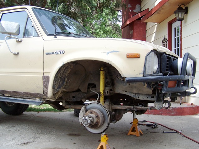

I have been using some clapped out stock rear shocks up front. They are pretty lousy on the washboards, but have been OK for crawling and added enough downtravel to help the ride out ALOT. We just welded some of those 99 cent commercial conduit hanger tabs from home depot right on the top of the stock shock tower and the position works perfect for the stock 23" extended rear shocks from a first gen pickup. You get full compression and about 3" of extra down travel. No big deal in this day and age of 3 feet of front articulation but it is a noticable improvement over the stock front length. As you can see the old shocks are spewing fluid now...
This setup has been working, but I have always been hopefull that some decent shocks would fall out of the sky for "cheap or free", which is the build theme for this truck. My aunt won a certificate from a raffle for a free set of light truck shocks from one of our Les Schwab Tire stores here in Montana. She lives in Oregon and doesn't need any shocks, so she passed it on to me. The total max value was $267, so I threw in an extra $54 and had them order four of their inhouse monotubes in the ideal lengths and valving for my spring setup. They are basically equivelant to a bilstien 5100 and I have used them on several builds in the past with great success.
