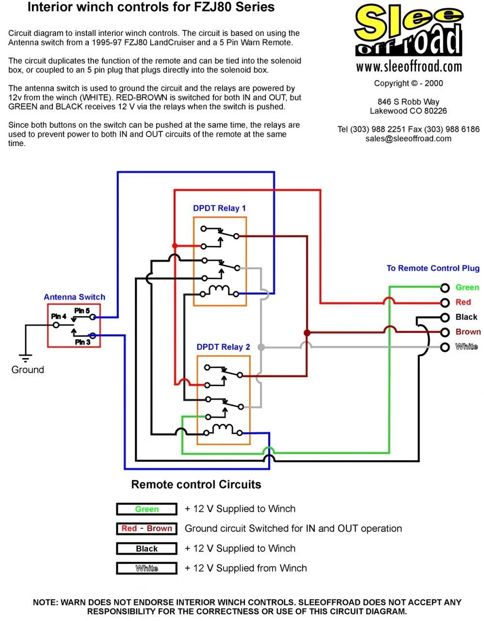

I have a Warn XD9000i, a 91 HDJ81 antenna switch, and the slee wiring relays.
The wiring relays have 5 wires, the warn winch had a 5 pin remote.
I've looked at the wiring diagram from slee for the relay board.
I've looked at the wires coming from the remote bulkhead on the solenoid control box of the winch.
Using a diagram of the warn long probe, I jumped the ground loop, and sorted out the power for winch in and winch out.
I ran the relay wires into the control box, and began connecting.
I got down to the last wire (red) which ran from the bulk head out of the control box to a ground point on the underside of the winch body. I stripped a piece of that wire, and when I touched my relay wire to it, it powered the winch to reel out.
is there something I'm missing here?
I've seen how to wire in a 3 wire control switch. But the 5 wire relay board is specifically so that both buttons on the re-purposed antenna switch, if pressed at the same time, won't activate the winch in and winch out.
Has anyone hardwired the slee in cab winch control directly into an XD9000i solenoid control box?

Here is the wiring diagram that comes with the relay board from Slee.
I don't have my winch yet to look at the wiring diagrams for the remote, but this is what I get from the Slee diagram. Hopefully I'm not being Cap'n Obvious here:
The antenna switch can only be closed in one direction at a time and is normally open (NO). When you press either side of the toggle, you providing a path to ground for one OR the other relay.
Pin 5 to Gnd
DPDT 1 coil energized
Brown to Red (ground for any direction)
White to Black (12V for one direction)
Pin 3 to Gnd
DPDT 2 coil energized
White to Green (12V for one direction)
With this set up, you just hook up the grounds and figure out which line activates the solenoid to scroll IN and which is OUT (Green vs Black) and connect your switch so it is the orientation you want. If everything is connected per the Slee schematic, nothing should have happened when you connected the Red wire. When you say you jumped the ground loop, what do you mean? Is your antenna switch faulting to a normally closed (NC) position?
Both buttons on the antenna switch can be pressed at the same time, this is why there is a need for the Slee relay board.
As per the link to the Colorado 4x4 post: warn 5pin winches switch both power and ground as a safety measure.
So to figure out with was spool in and which was spool out you use a short piece of wire and jump two pins (4 & 5), then with another wire you jump 1 to 2 and then 1 to 3.
I tested my antenna switch to discover which wires of the pigtail I would be using. Everything seemed fine then.
I have an email in the interweb ether to Christo at Slee.

Christo, did get back to me and said warn may have changed the coloring of some of their wires. However as far as I can tell, from the jumper wire test, everything matches.
I have yet to test that circuit board they sent me, it may be the culprit as was mentioned above.
